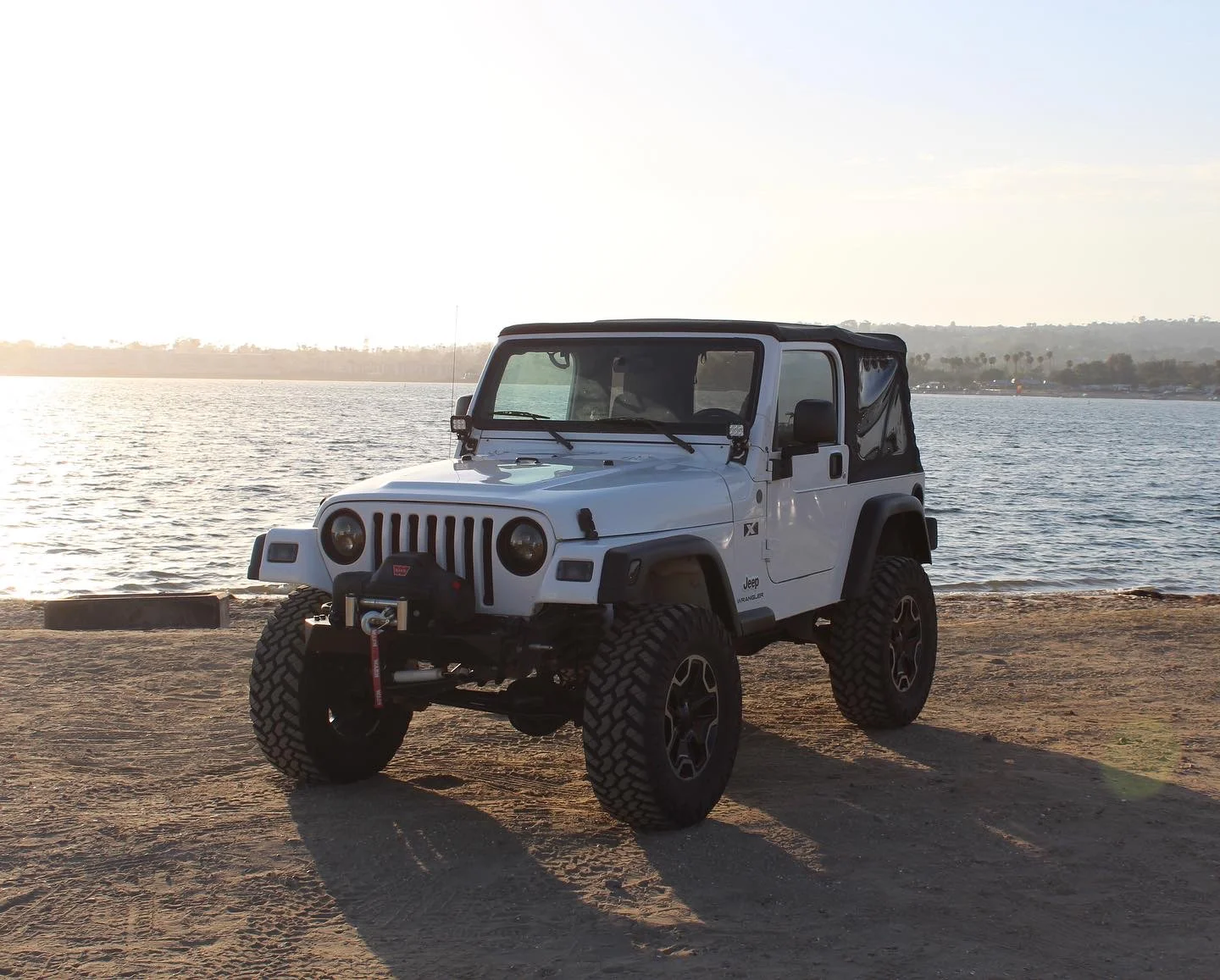

I want to go to a lower ride height. My coils currently measure out to 5" higher than stock in the front and around 4-4.25 rear. I'd like to go to around 3.5 for my 33s. I know I'll have to buy shorter shocks, but will my driveshafts which are custom fit for my current setup be too long? I'd also like to buy coils without having much rake. Anyone have the Jks 3inch coil pack? Does it rake?

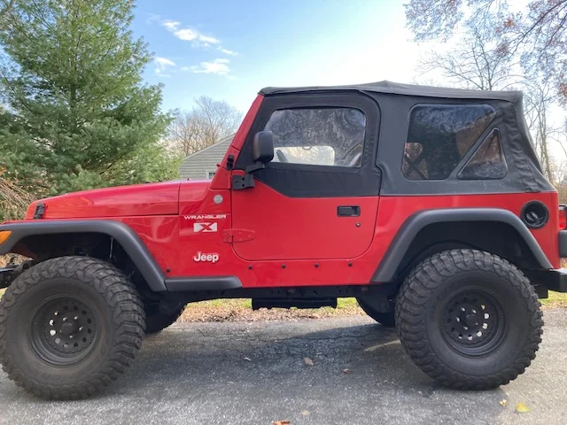

I don't know the answer to your drive shaft question, but with respect to the coils you will have rake if you install coils of the same height front and rear because the TJ came with rake. I also have 33s and solved that problem by going an inch lower in the rear. Others address rake by installing a spacer up front, either way you'll have to get the front up a bit to level it out if that's what you want, the amount depends on your setup, for example if you have a heavy front bumper with a winch you'll need more than if you're stock. This is what 3 inch front coils and 2 inch rear looks like with a stock front bumper and no winch:
