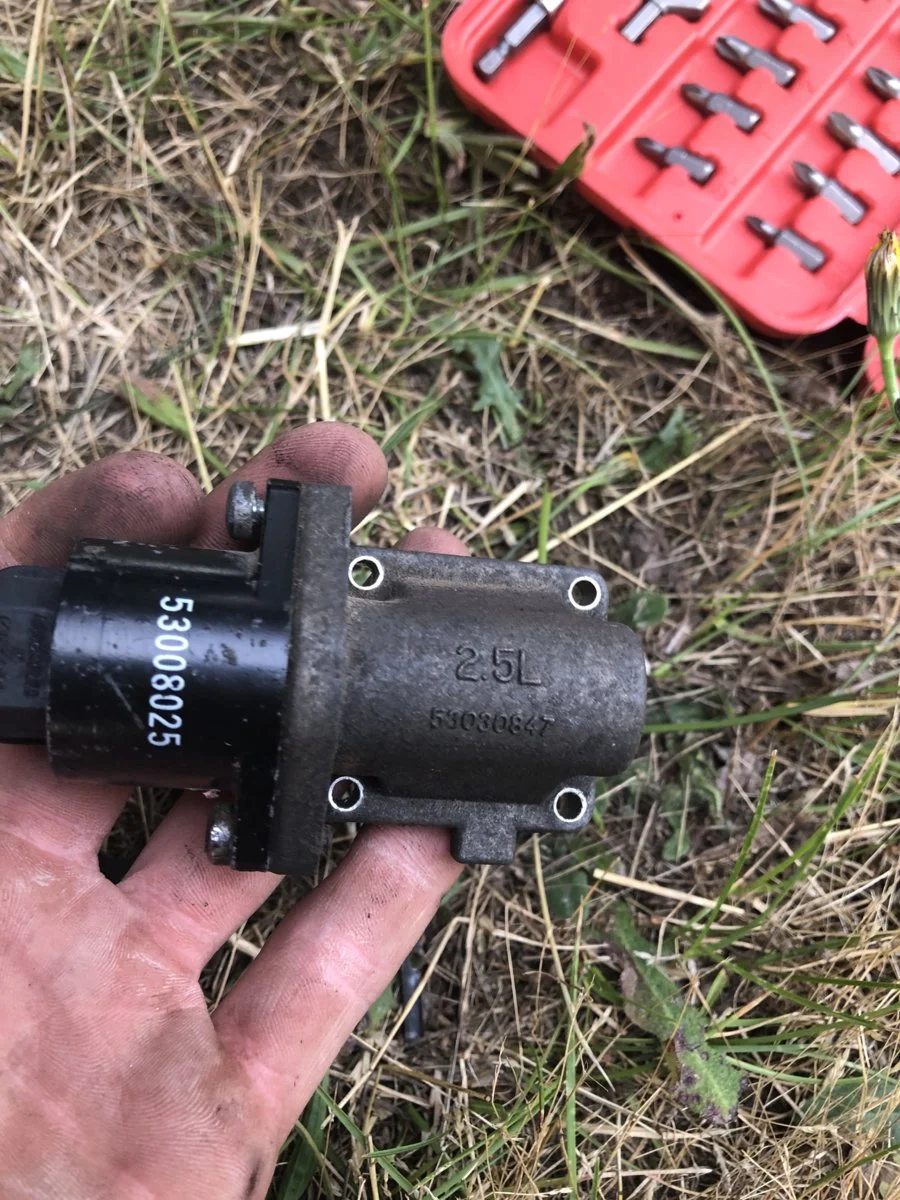

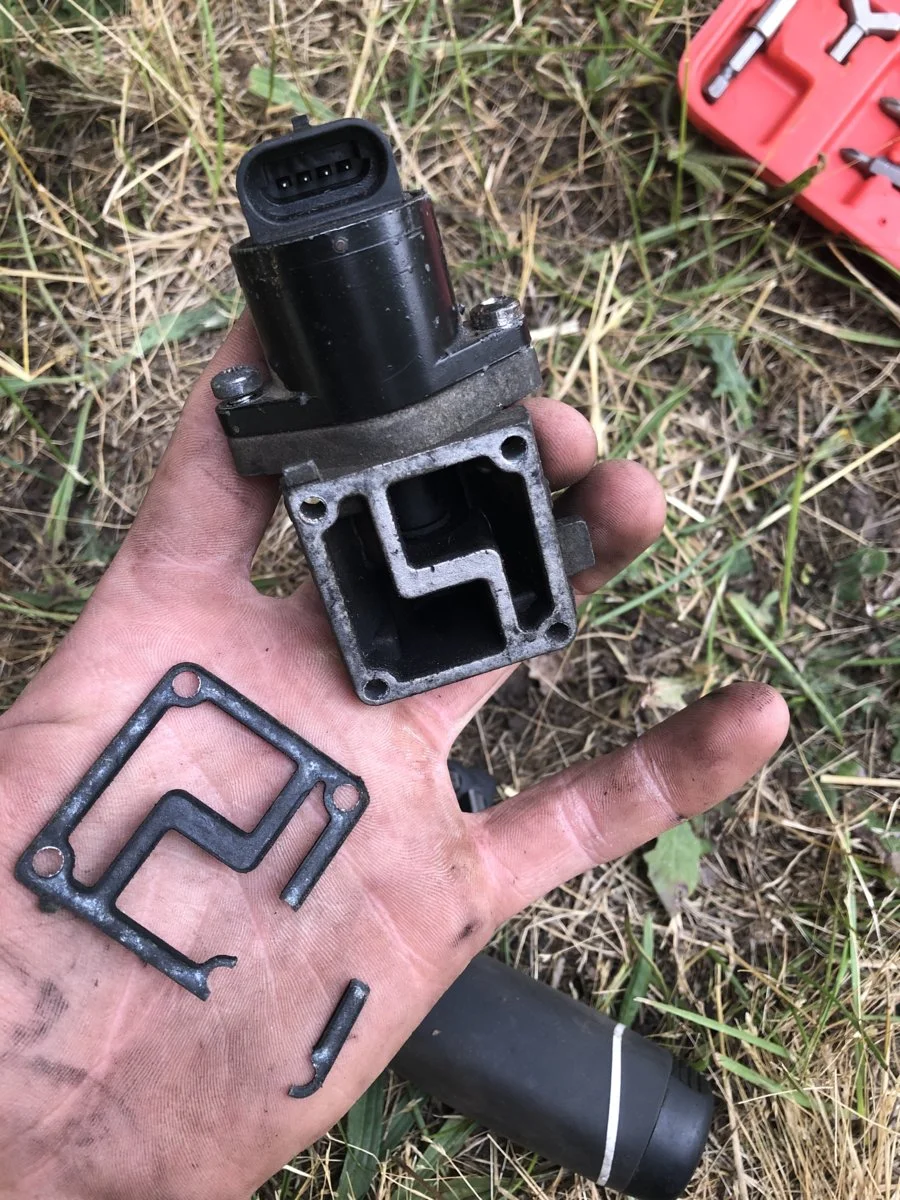

I was going to replace my idle air control valve today but I had to take the mount off to get to it. I realized it was because the bottom bolt was rounded. I haven’t got it off yet but I also cracked the gasket on the mount. Is there a more exact name for it other than the idle air control valve mount or where I can get one so I can replace that as well?

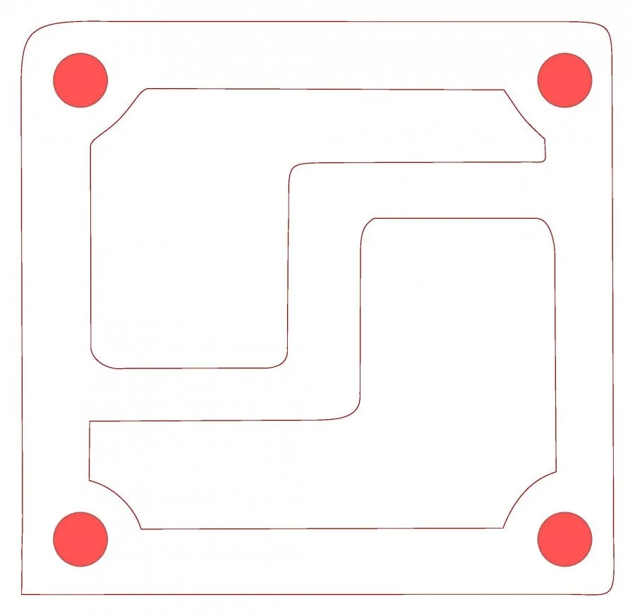

If you have to make your own, this may help instead of trying to trace it. I found this on another Jeep forum.
I have also seen people use RTV allowing it plenty of dry time.

Unfortunately I did try that and there was no movement out of it at all. I just did what jerry recommended and just cleaned it and put it back together. I’ll probably just grab it off a part out Jeep one day.
