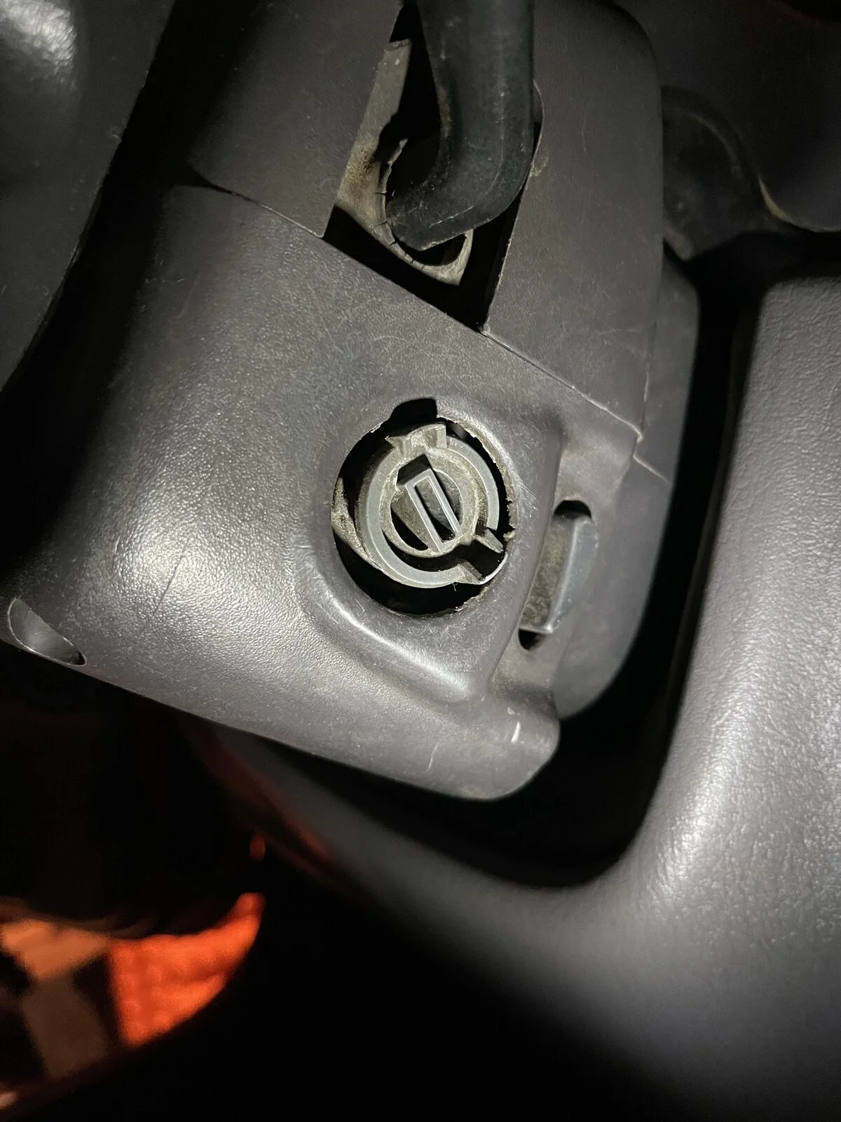

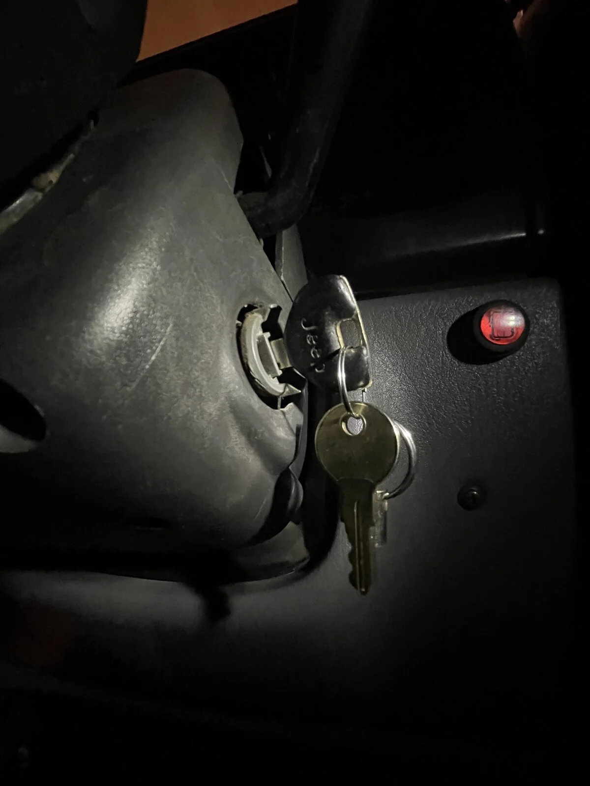

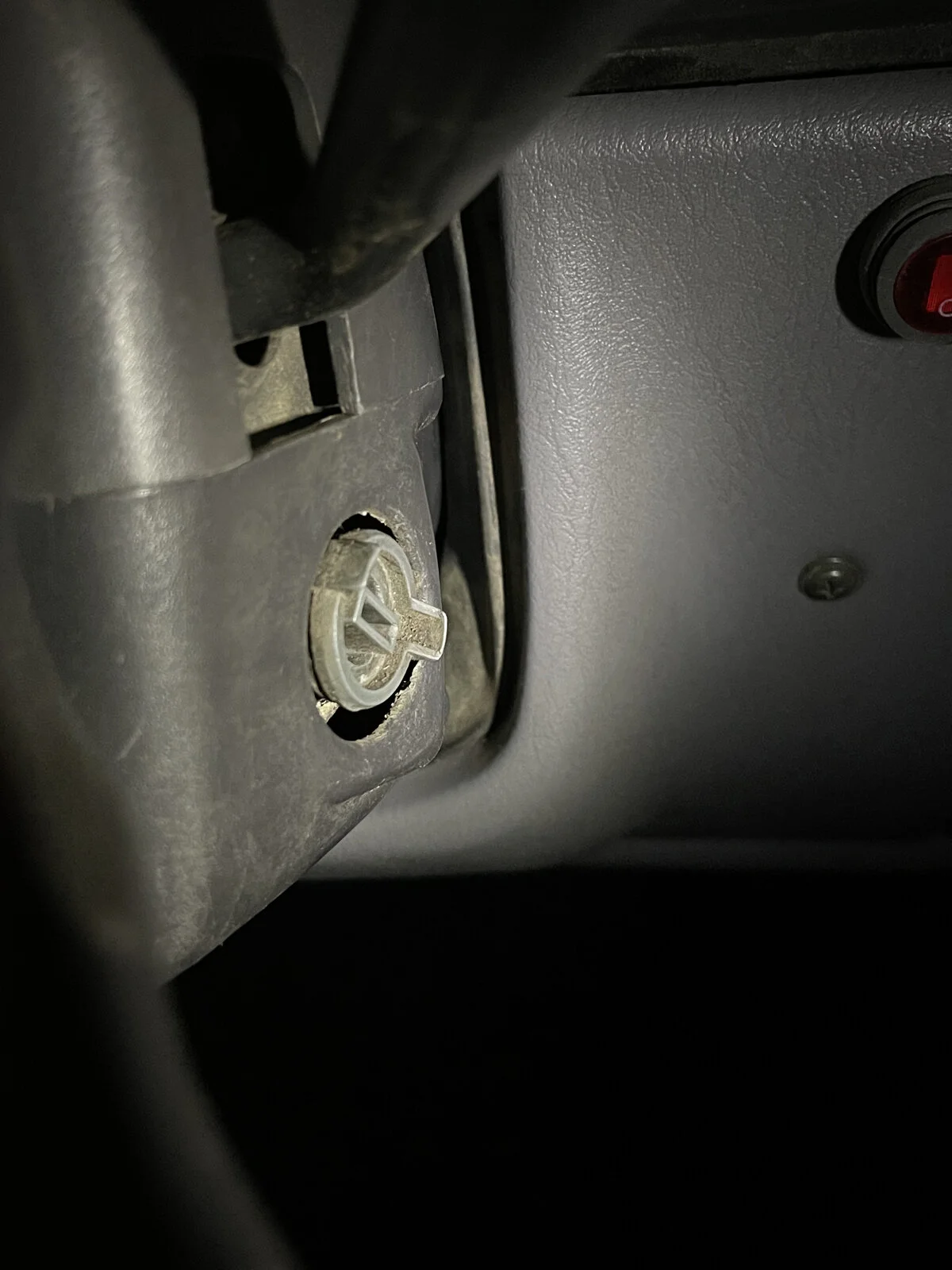

Haven’t been able to find anything like this on the net. My recently purchased 1997 TJ has something weird going on with the ignition cylinder. There seems to be a shroud or guide missing where you insert the key. What happened here?
It functions fine, just makes putting the key in a little awkward. I’d like to repair this. Am I gonna have to replace the whole lock cylinder?

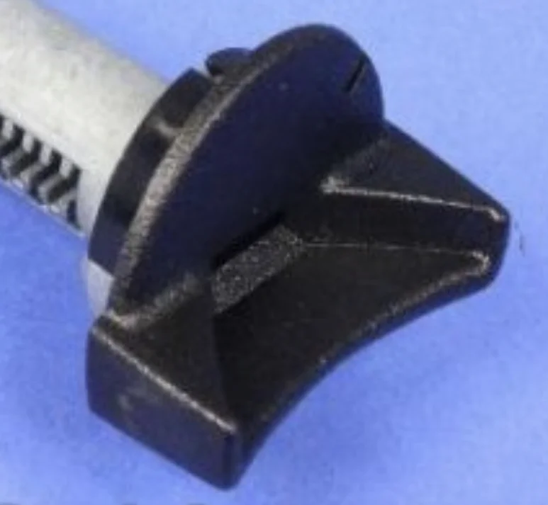

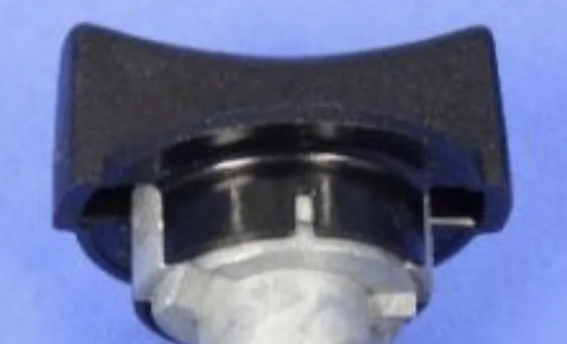

It clicks over the end of the cylinder and engags the metal ears which allows it to all turn together. Basically you’re lifting up the inside edge and popping it off, then lining it up on your cylinder and snapping it on..
