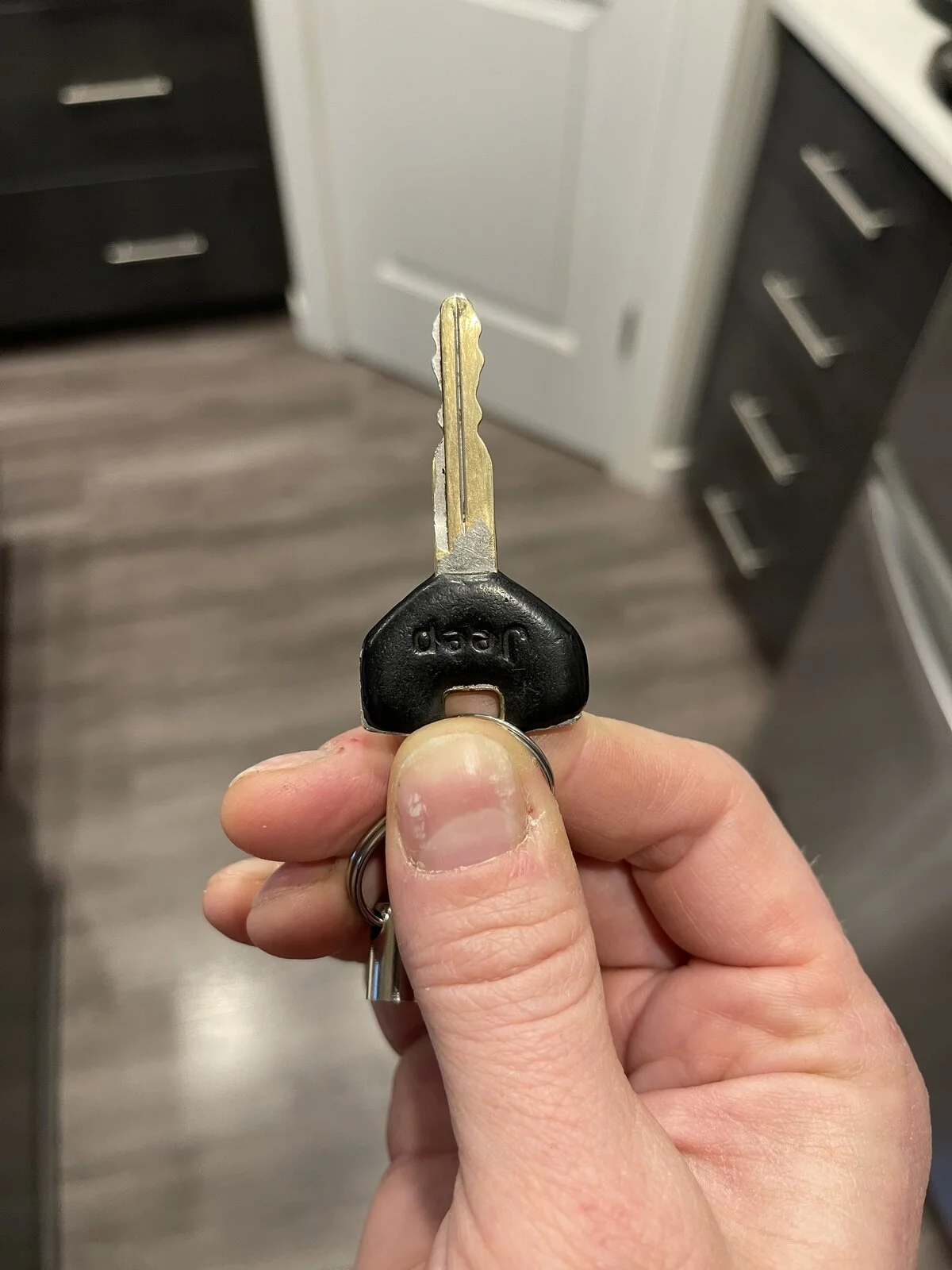

Here’s the well-used key for reference.

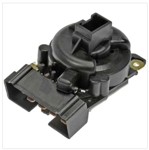

No, not the lock cylinder, the actual electrical switch that the lock cylinder turns to engage the starter and ign circuits.
I just replaced mine switch for the same reason. Didn’t help. If I wiggle the key everything comes back on. Will probably replace the actuator and cylinder next just to take care of it. But want all new locks to match. Looking for a set I can buy all together.
You should also inspect the ignition switch wiring harness connectors and wires for signs of overheating...
This can cause intermittent problems with power to accessories.

The ignition switch is a tricky piece, and it only cost about $20.
I'd start there as this is exactly what was happening to my stereo; intermittent shutting down and/or not functioning at all upon startup.

Hopefully. I have a mopar blower and resistor and will replace them this weekend I will let you know if it fixes it. My key was worn out badly too so I pulled the ignition cylinder and had a locksmith replace the plates and cut some new keys based on the plate numbers he pulled out. This gave me new keys that still work on my doors and stopped the key falling out of the ignition :)

he charged me $20.00. $3.00 for each key and $14.00 to replace plates in cylinder. I just took him the cylinder so no real labor it only takes 10 min to change out the plates.
