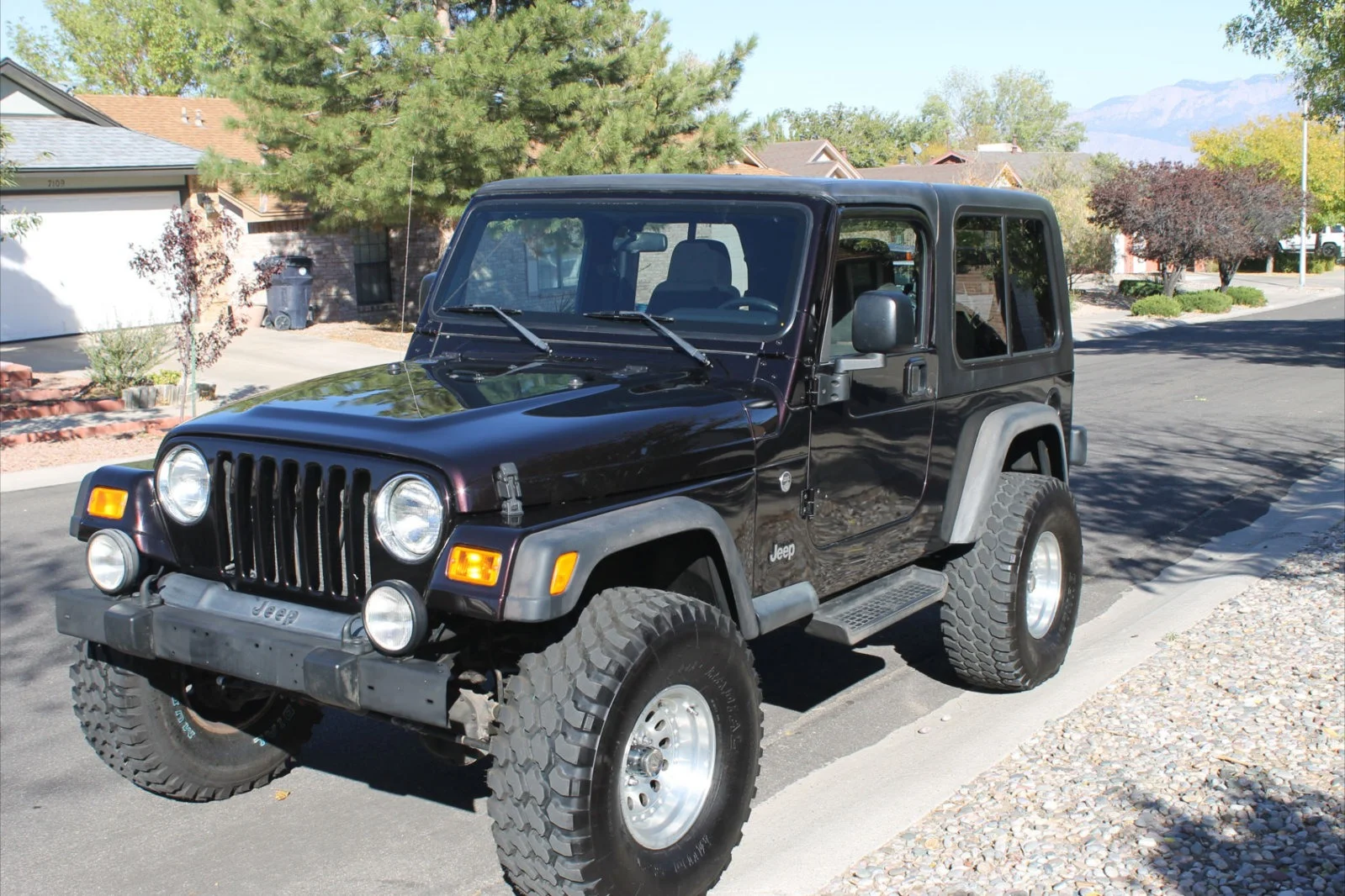

without going down the line over the years of various jeeps, I'll keep it to the last 4 years. Bought the Black Cherry 05 LJ while living in New Mexico. Already had the 4" lift and 35" tires but nothing else and not one scratch underneath. Apparently no high curbs at the mall. I did bumpers, Engo 9K winch with synthetic, Crown HD steering, RE adj track bar, all new u joints front and rear, all new front end bushings
and discos as well as Rancho 7000 shocks. Installed a Spartan locker in the front and it would go anywhere you had the stones to point it. Also put the Fat Bob's Garage seat risers in it and bedlined the tub. More, but that's the gist. BTW, the seat risers are great! I always felt I was sitting in a lowrider with stock seat height.

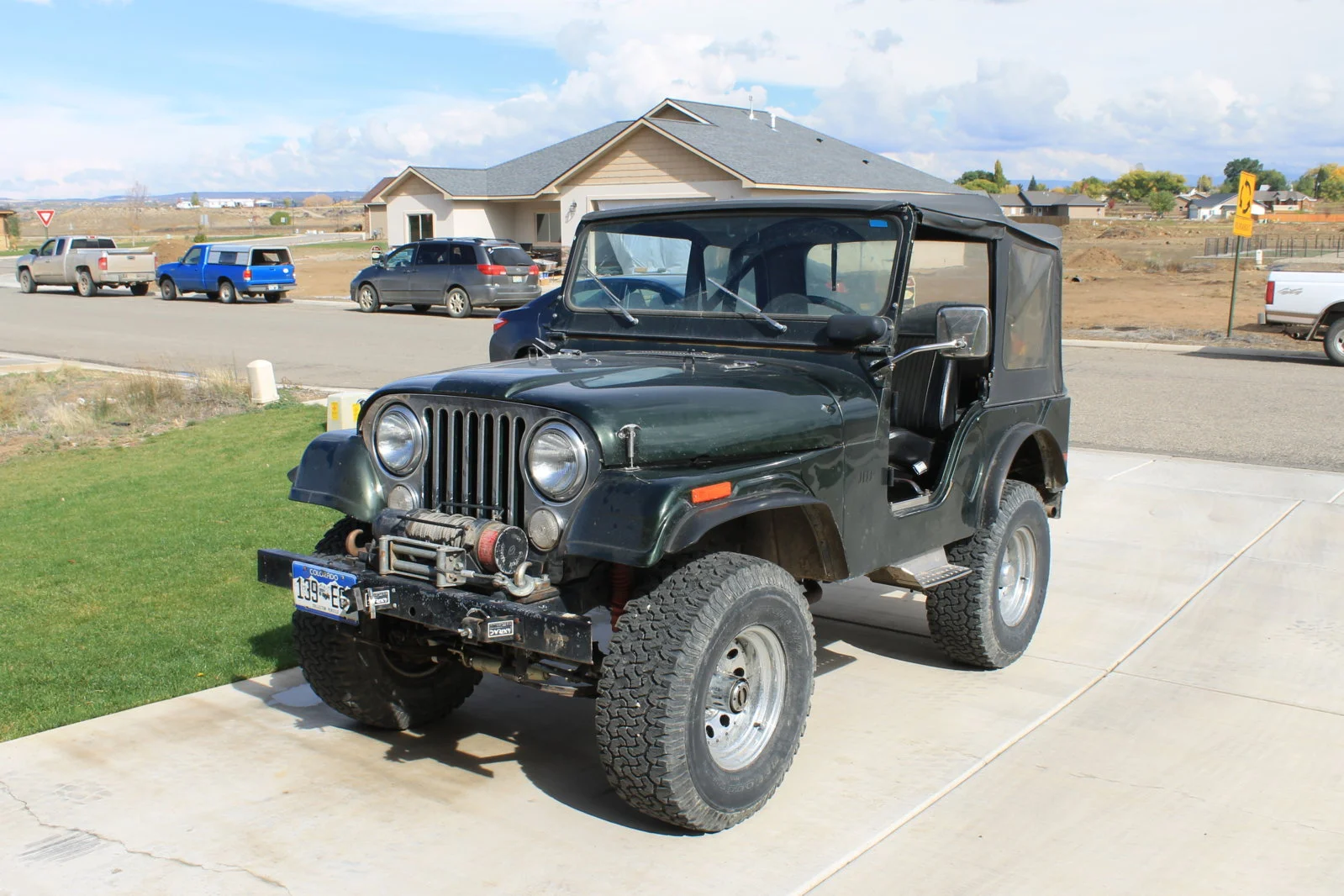

So sold that one and picked up this little 71 CJ5 with a V6. Took it home and won't print what the wife said. Anyway I rebuild the Dana 27 front end and called it good, sold it and on the hunt.

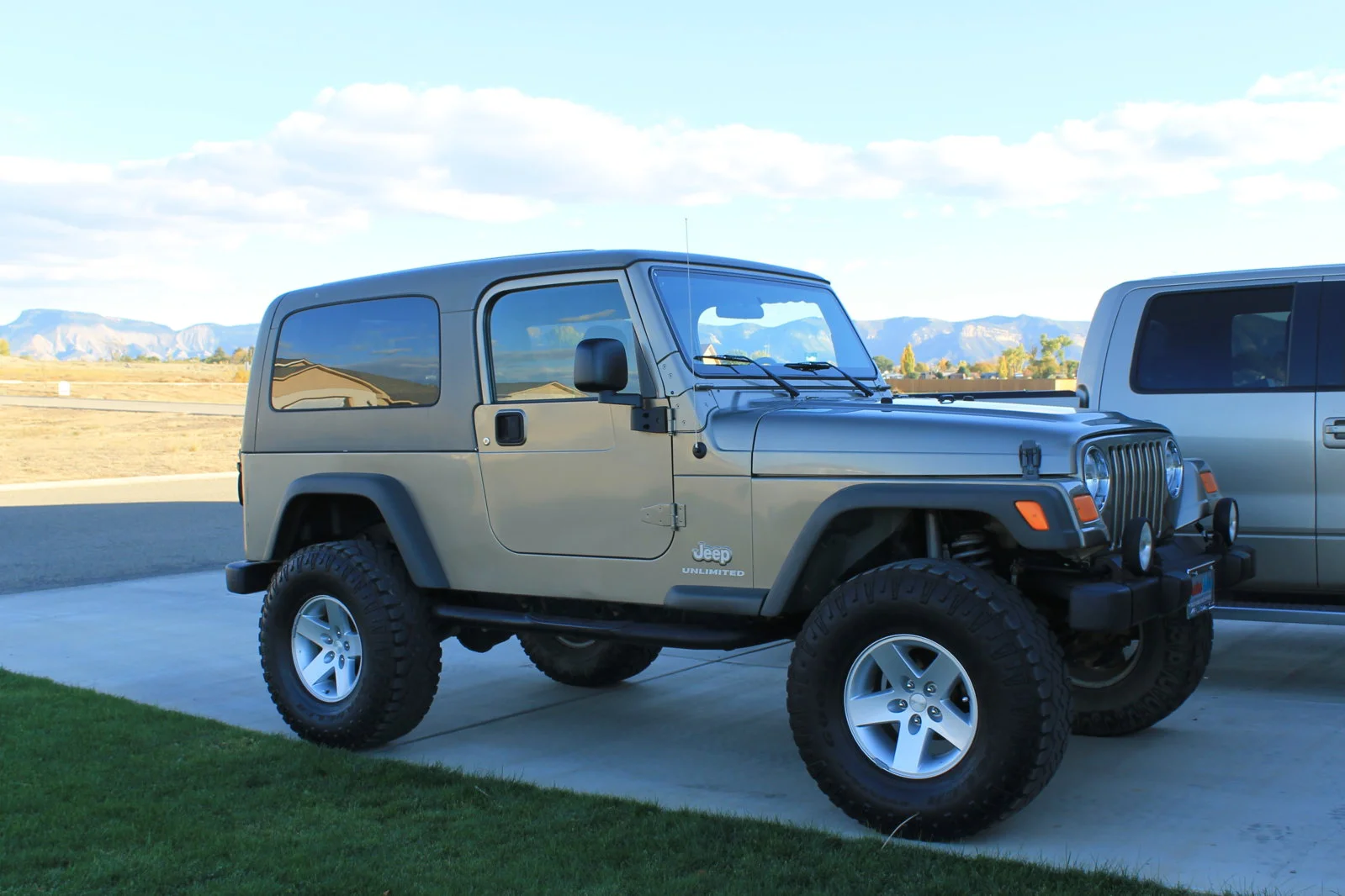

Which brings me back to the latest LJ in Khaki. Way and beyond my favorite Jeep of all time (LJ). Another 05 already lifted with RE 4" and adj uppers. Another mall queen apparently, no scratches underneath. The bad however was not quite death wobble but close. Back window hinges held together with looked to be welding rod without the flux coating. Drove it home and the work began. New ball joints (all 4), new Crown HD steering and replaced drop pitman with stocker. New Rancho 5000x shocks and stabber. New rear window hinges solved the loose window banging issue. New American Racing AR23 15x8 wheels and Cooper STT pro tires in 33x12.50x15 are ordered. Still have to do bumpers/tire carrier and winch plus plus plus.

BTW, what kind of hard top is that on your LJ? It clearly isn't factory.
I forgot the name of it. It was on that LJ when I bought it. I looked it up one time and it sells for 2800! Nice top all carpeted inside and the front section comes off and has a sun roof. Best part is the back window has locking latches, not held in place by the tailgate like a stock hardtop like my current one.
Nice! The TJ hardtops go for a pretty penny, but the LJ ones go for quite a bit more considering how rare they are.

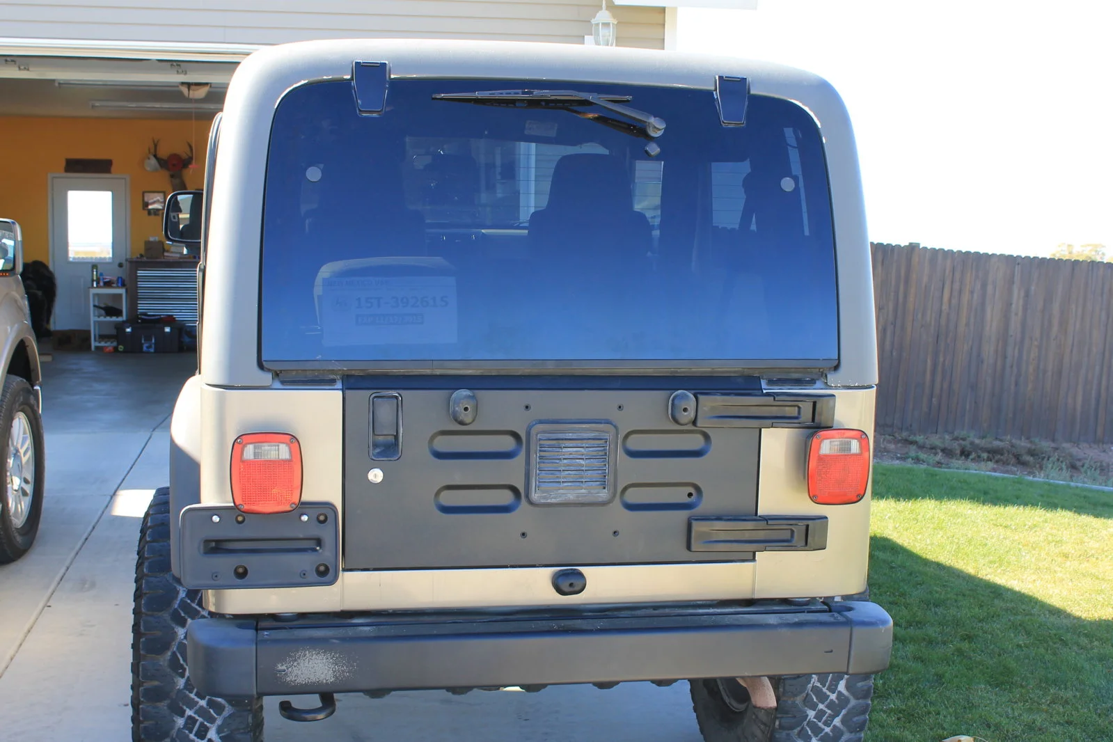

next project in the build was to remove the so called oversize tire carrier from the tailgate which was causing some sag with a 315x75x16 tire and wheel with 2 spacers and accoutrements to make it work like spacers behind the bracket. Upon removing this abortion, I found it had eaten the paint off where mounted. So......off comes the tailgate, sanding and taping, then spraying bedliner with 3 coats. After drying, tailgate reinstalled and brackets adjusted to get back to acceptable alignment for closing and sealing rear window. Next project is new tires and wheels (hopefully next weekend if they come in) then new bumper and tire carrier.
next project in the build was to remove the so called oversize tire carrier from the tailgate which was causing some sag with a 315x75x16 tire and wheel with 2 spacers and accoutrements to make it work like spacers behind the bracket. Upon removing this abortion, I found it had eaten the paint off where mounted. So......off comes the tailgate, sanding and taping, then spraying bedliner with 3 coats. After drying, tailgate reinstalled and brackets adjusted to get back to acceptable alignment for closing and sealing rear window. Next project is new tires and wheels (hopefully next weekend if they come in) then new bumper and tire carrier.View attachment 270
Funny because I am about to remove the stock tire carrier as well, so I am hoping I don't find what you did underneath.
Sometimes I wonder if I should just do the entire rig in a primer black like you've done with your tailgate there.
Then I would never have any worries!
Actually this bedliner I used in the tub of previous Lj holds up pretty good. I have seen bedlined jeeps before and what a mess. The commercial bedliner is thicker and rougher and holds dirt better than a cheap hooker. This stuff is pretty smooth (actually about the texture of a hardtop) and will rinse off better. You will probably find some corrosion around the 4 bolt holes but easily fixed with those plastic push in caps. I just didn't fill mine yet. Once the tire carrier bumper is on, it will hide most of the back anyway.
The stock tire carrier is just complete crap. What a stupid idea anyways to try to hang all that dead weight from the rear tailgate.
Next step in rebuild is new spicer u joints, Fat Bobs seat risers this holiday weekend. Btw back window is adjusted to seal better than previous picture lol.
I just put a new back window seal on mine as well!
