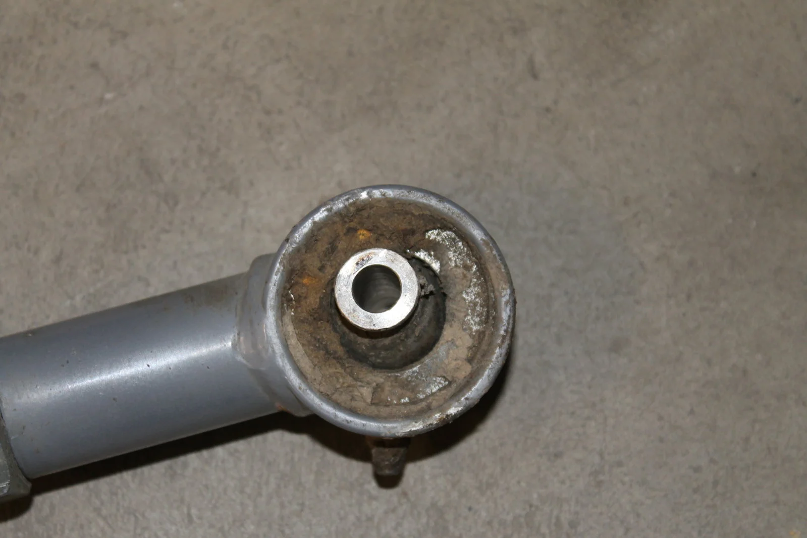

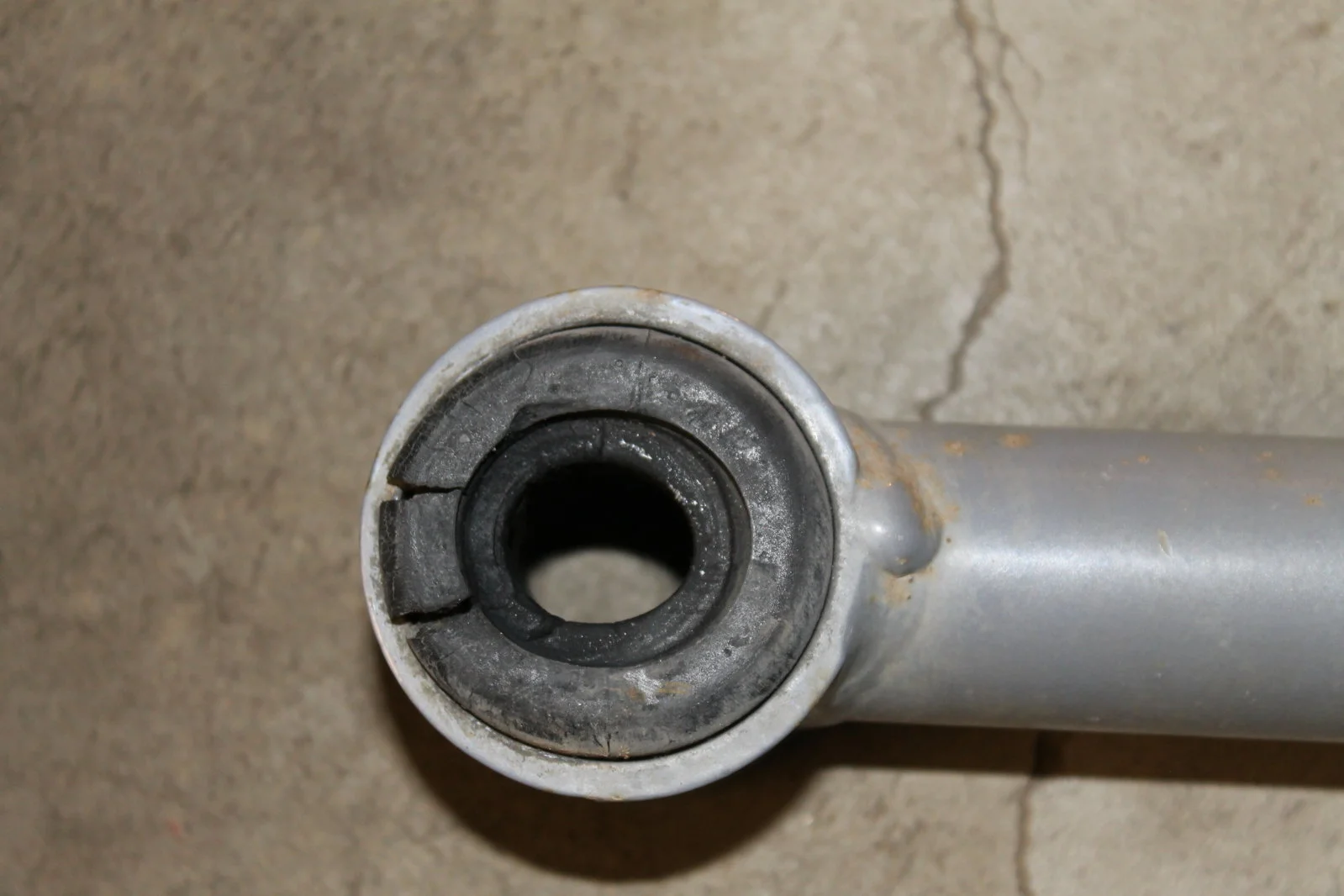

after a little more thought and some more research, I believe rebuilding the CA's are going to fix the issue. Reason being under acceleration the torque is changing the pinion angle because the bushings are so worn out. Not a big problem but never had this issue with poly bushings in previous LJ, but had other issues like almost tearing off front control arm brackets. So, lesson here is, rubber bushings won't last as long, but less overall damage in the long run. Always something new with a new project, every jeep I have had has taught me something new.

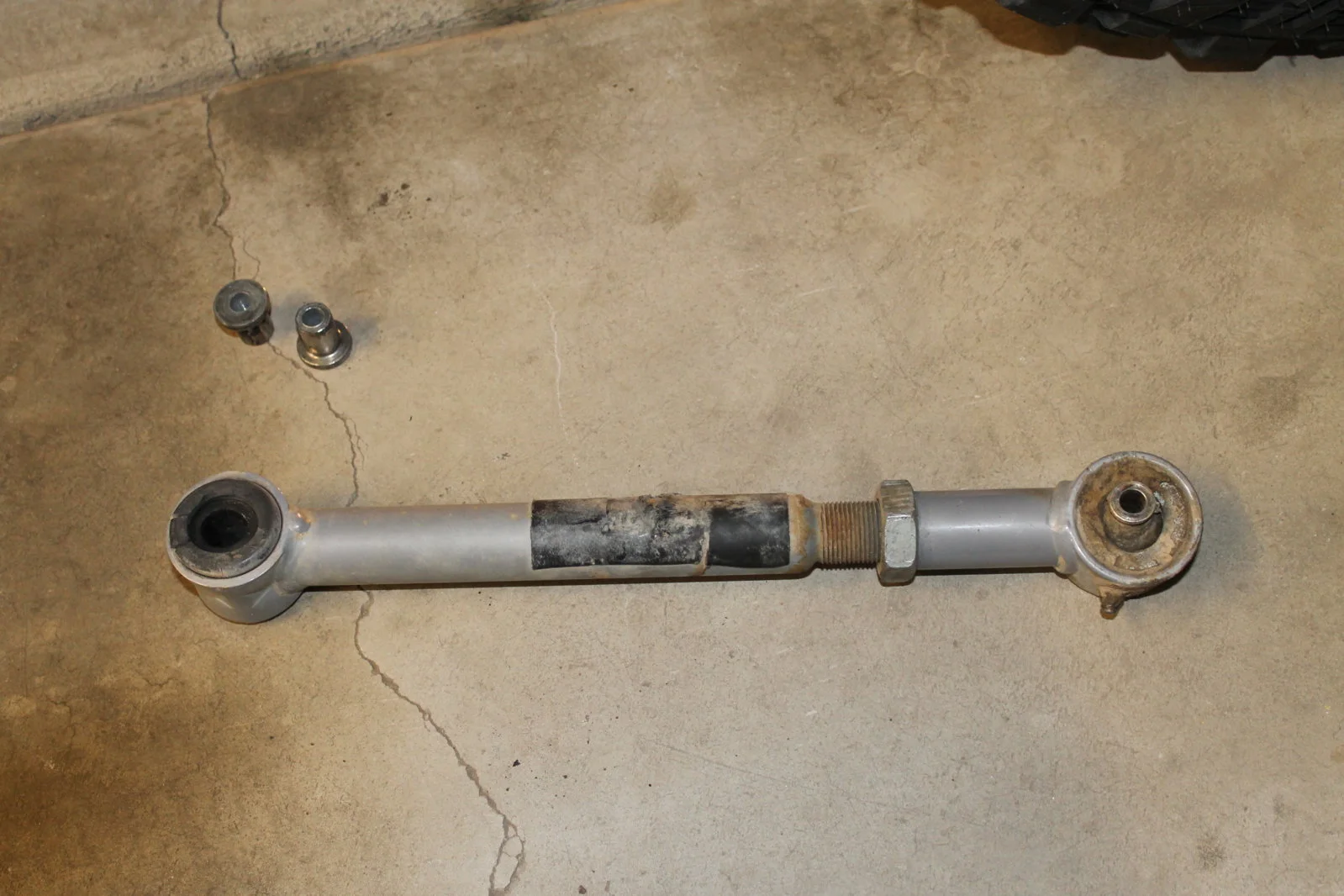

pics of the bushings. will be ordering rebuild kits Monday. Kind of disheartening only because I had previous LJ already dialed in but knew this was going to be a project going in. Got all winter to be ready for Moab in the spring.

Rubicon Express. I have never run these before (the lift was already on this jeep) but I do like the idea of rebuildable ends. (I think, time will tell I guess) I forgot what they call the swivel end and their website says they should last a long time, but I may just rebuild all the ends anyway just to start with a clean slate.

update on rebuilding. Should have taken pictures but I get in the moment and don't think about it. Pulled RE adjustable uppers and lowers in back for rebuild. Thanks Rubicon Express for the free bushings and info on adjusting the joints. BTW, this info is also on Stu Offroad website if anyone needs it. Found out my OTC ball joint tool works pretty good for pressing out old rubber bushings. pulled joints out, cleaned up and reinstalled with proper tensioning on the joint. They were verrry loose, just wobbling around. Also a good thing to do is put a shot of grease through the zerk when you have everything apart just to make sure it is unobstructed. Put everything back, used angle finder to set pinion and good to go. So I thought. Upon a test ride, found out I had a pretty significant vibration. Back in the garage and reset pinion angle by eye. Now we are good to go with no vibes, had it set a little low. Pulled the fronts and found everything to my liking there. Next project will probably be front axle and driveline u joints as already did rear driveline.

Yes real easy. Press out old rubber bushings press in new ones. The spherical joints on other end are adjustable if not gone. These were ok just took apart, cleaned up and reset tension. At some point I will get new joints and replace but these still looked good enough to clean up and reset the tension by tightening up lock ring.

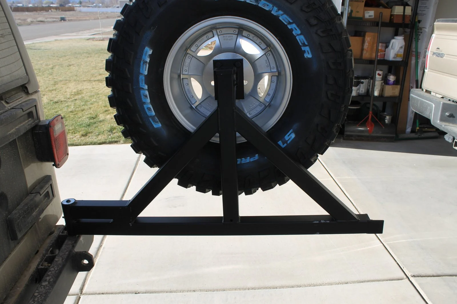

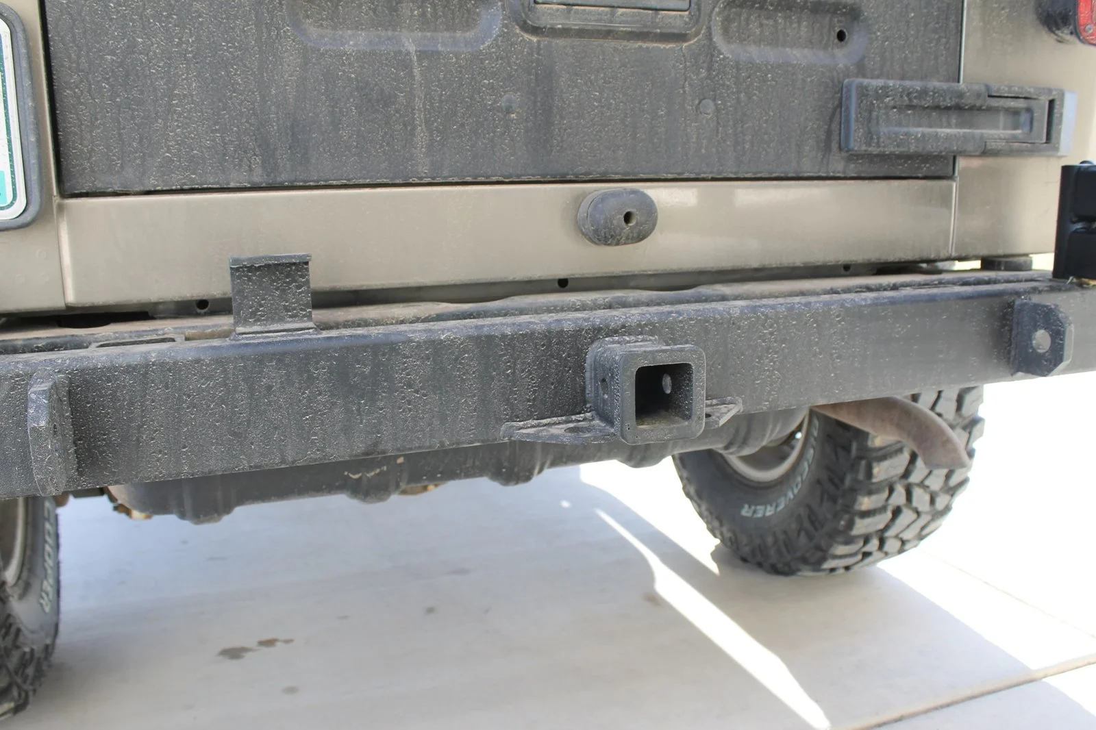

OK, the build continues. Got Dirtworx bumper and tire carrier last week and got it primed and bedlined this weekend. Had bumper on and drove through sloppy roads Sat for grandson's wrestling match so it got a little grime before installing tire carrier this morning. All in all I have to give this bumper pretty high marks for quality and fitment. Thanks Robert for the quick service. I like this bumper better than the one on the previous jeep because of ground clearance for one and hitch is integrated into bumper not hanging below. Well worth the money imo.
