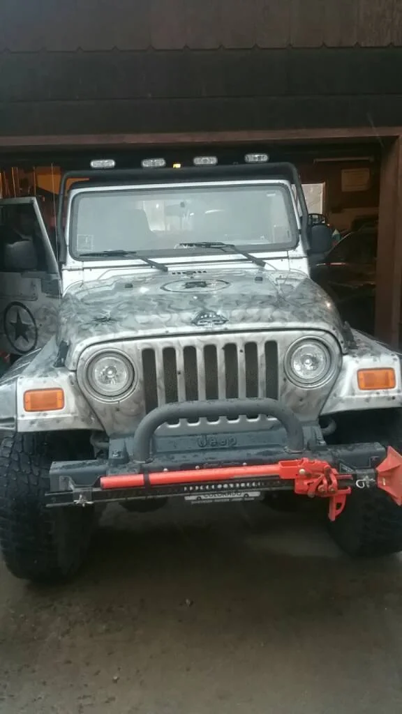

So it's getting warm enough for me to pull my soft top down during the day, I cannot leave it down at night due to rain and security against animals.
I'm not strong enough to put it back on by myself, my light bar resists and it just generally needs more weight than I have.
Back in Texas, I had my dad to help me out, and on occasion my boyfriend can help, but for the most part I'm alone and not strong enough.
Any ideas on how to fix this? I really wanna drive with the top off, and I can get the whole thing off and on within 10 minutes except getting it close enough to latch down.
Pic for attention / jeep tax. It looks so much better without the top too.
When you put the soft top up leave the rear unattached and hook the front into the holes but don't latch them down. Then then attach the top at the back then latch down the front since its hooked on already. That's how I do it.
