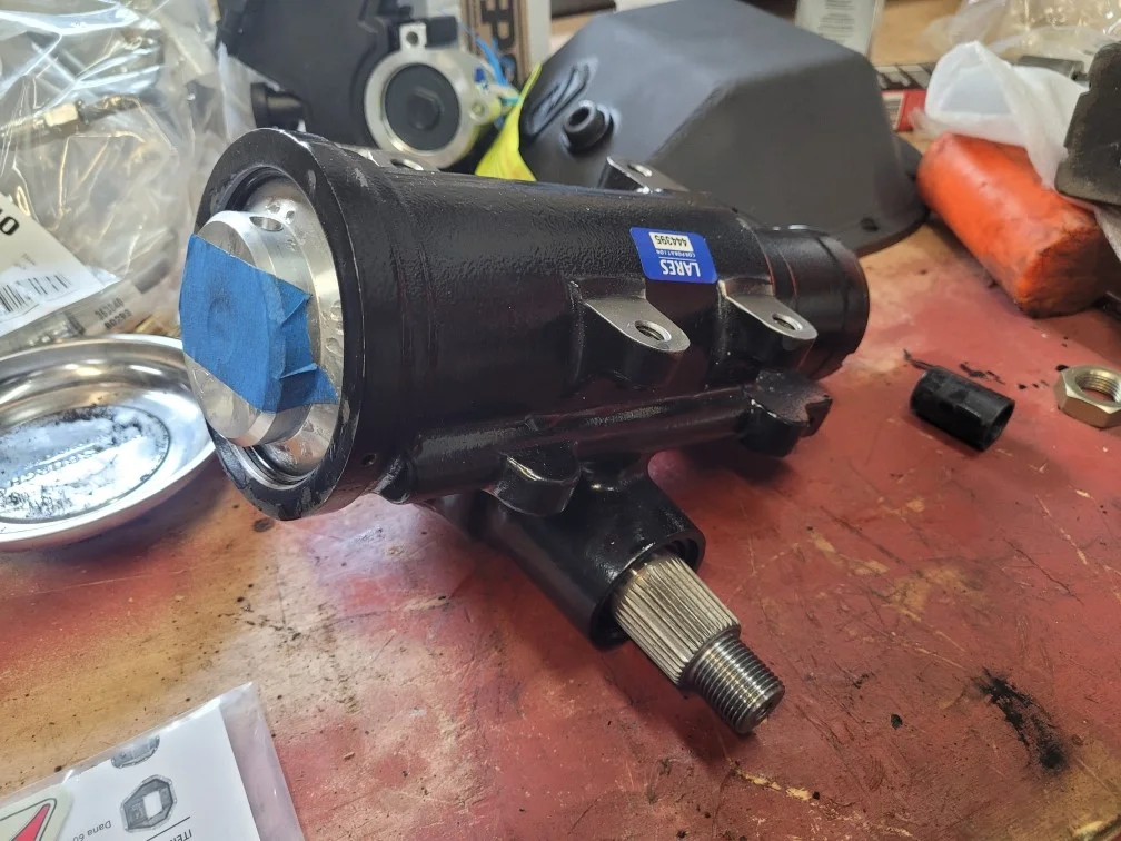

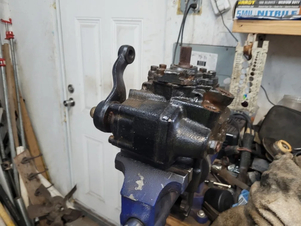

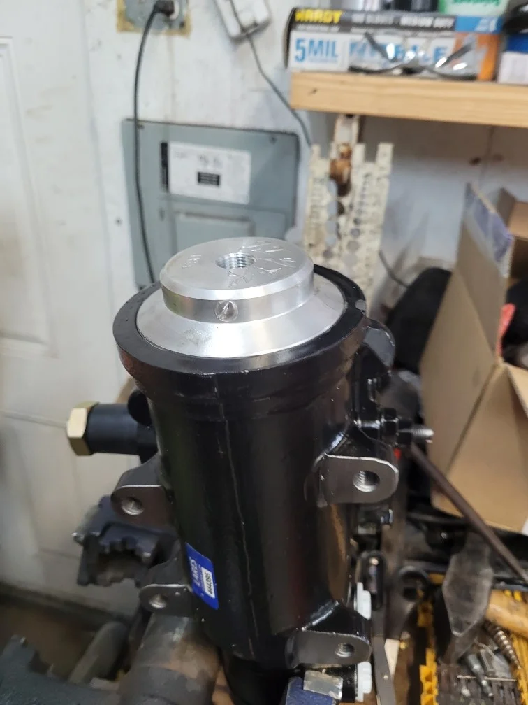

We have been planning Hydro assist for a while. I was going to order the PSC kit but as we were crunching numbers and doing some research. We figured we could do it for about half price. On my friends Jeep (2000) he installed a PSC ram with a drilled out factory pump. Tapped the original Saginaw box. Had custom made hoses made at local Hose Makers. It works pretty good. Since I have a Mercedes box I planned on replacing box. I found a Lares "Rock Crawler" box that they said was more heavy duty. It had an 13/16" input shaft and a thicker sector shaft. Was doing research on pumps that had more flow/pressure. Found write ups on the WJ ps pump and thought that would be a good fit. Figured we would go with same PSC ram that my friend had bc we have very similar set ups. So here is the parts list was ordered .
1. PSC 1.75" Ram 8" stroke
2. New Lares WJ pump(bored) pt# 12762
3. New Lares "Rock Crawler" box (tapped) pt# 11430
4. Lares power steering filter with magnet 3/8" pt# 298
5. Derale fluid cooler PT#13215
6. MY 2000 TJ Gates pressure and return hoses(353840 & 353780)
7. DIY4X steering box 3.5" pre tapped end cap
8. Borgeson 13/16" Steering Universal Joint pt# 014940
9. Royal Purple Max EZ p/s fluid
10. Safeplast Hose protection Wrap
11. PSC pp2401 pulley(1" smaller than factory)
We will get hoses to ram made locally

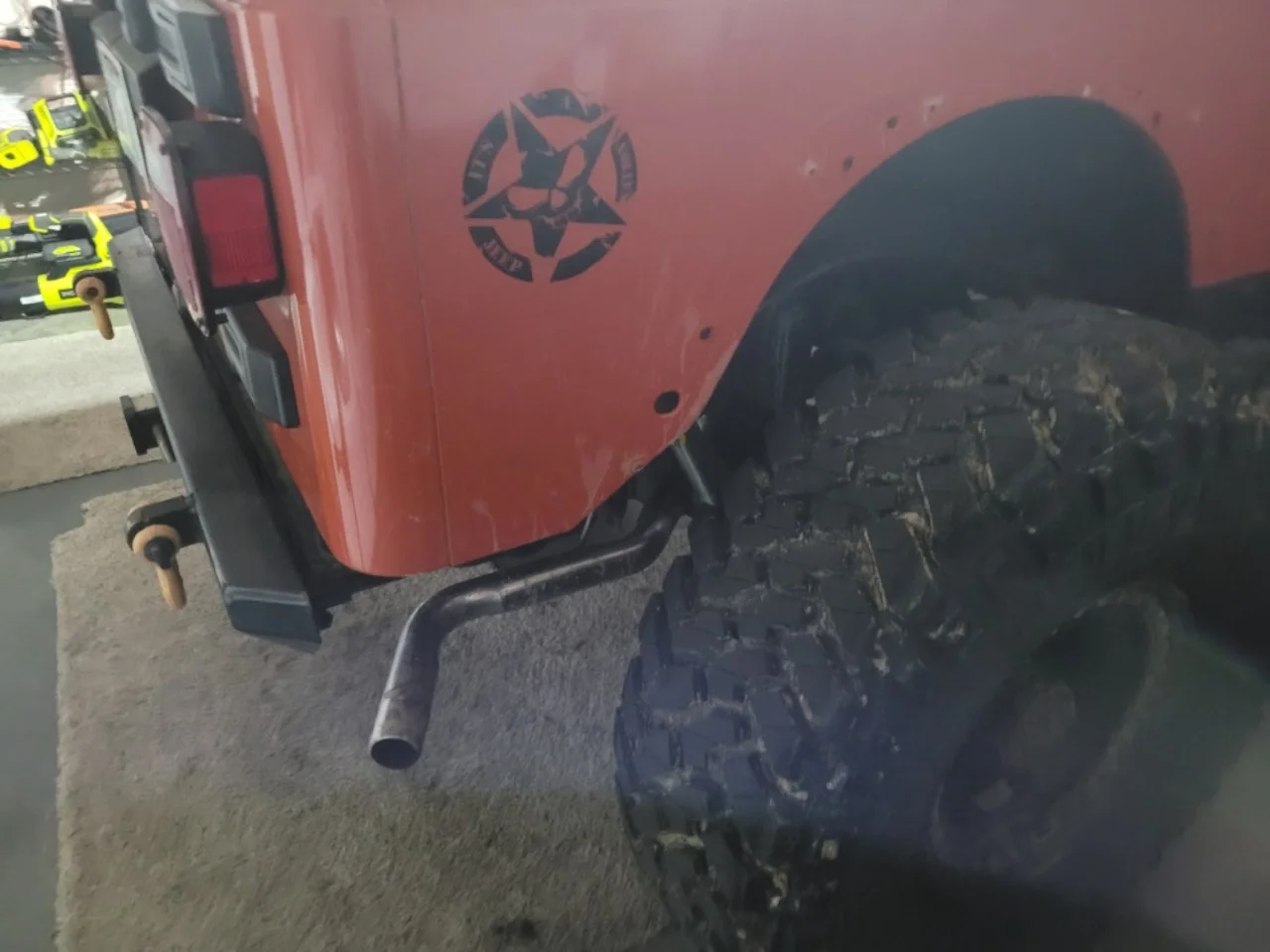

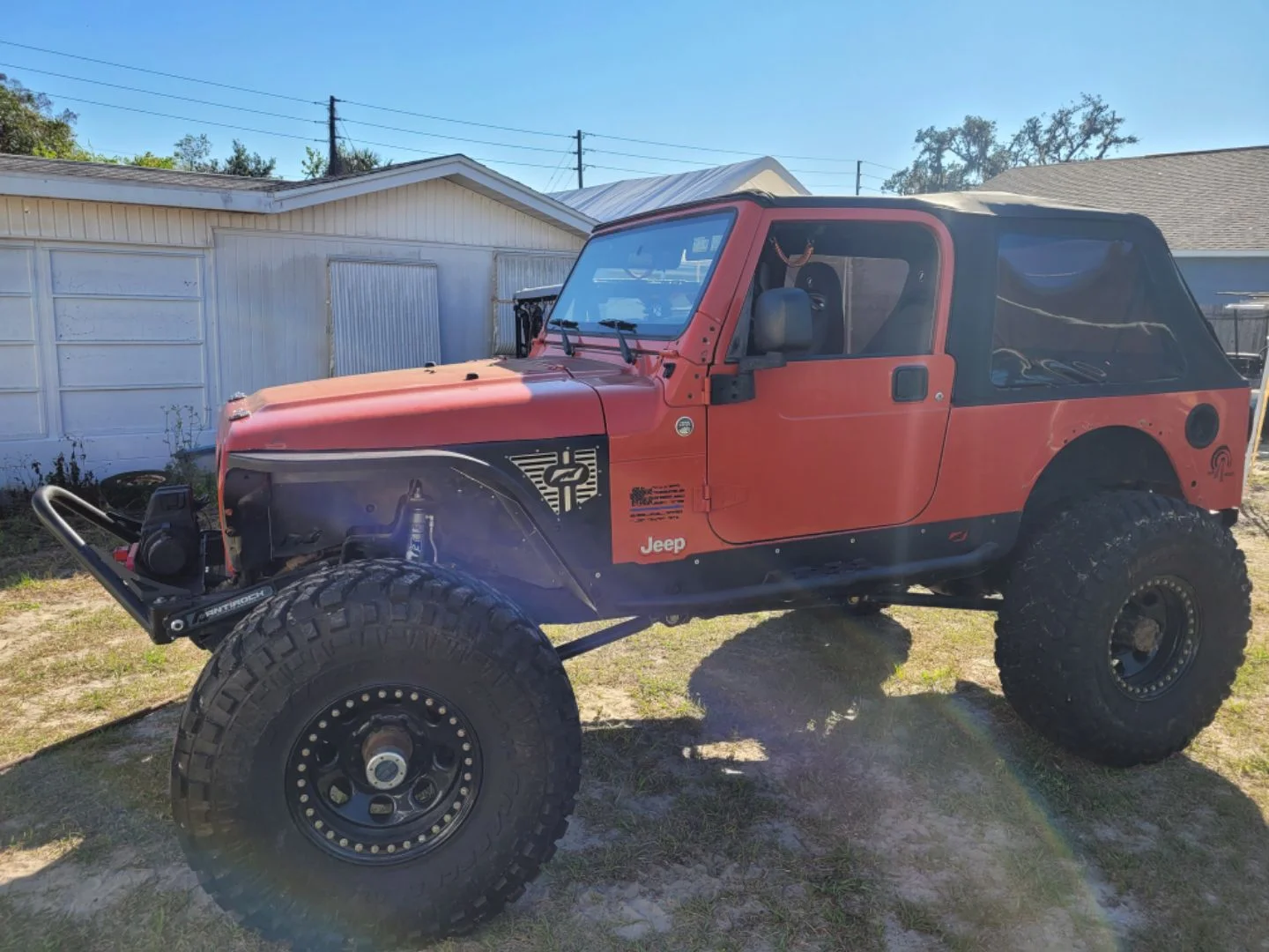

Here is a pic of the way I cut the rear fenders for now. I plan on putting corners on in the future. We are going to stretch the rear between 2 and 4 inches. So we are throwing around different ideas. Also put a new exhaust on. It was crazy loud with no muffler. It is alot better now. Still has some rumble. The muffler got cut off before the rear was 4 linked. It doesn't look the best but it does not interfere with anything when flexing

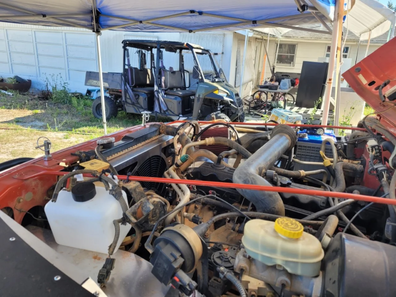

I absolutely love the kit I went with(Derale TJ direct fit). Most of the problems I have read about have been a generic set up or a cheap kit. Mine moves so much air and fully auto

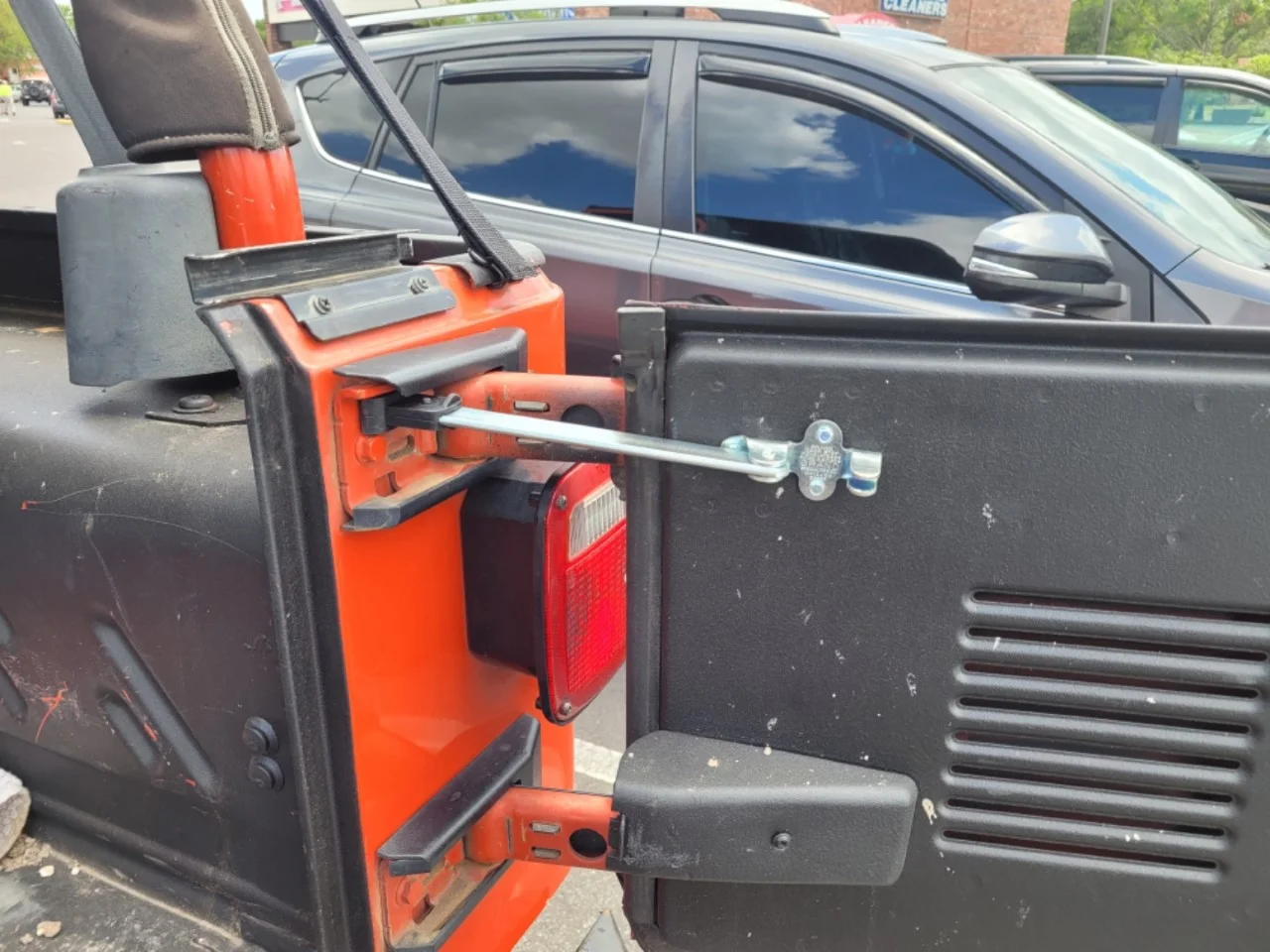

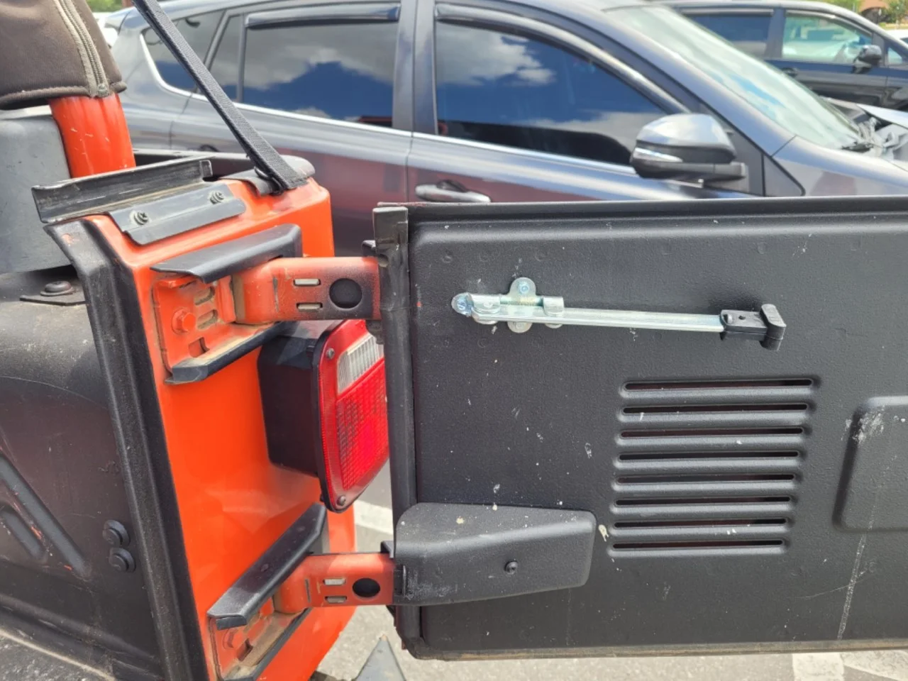

Just a small mod I installed last night. On a hill my tailgate wouldn't stay open at certain angles. Found this cool little product on Americanoutlaw.com. It's called The Gatekeeper. They also make the best mirrors for when removing doors and other cool Jeep items. You can also get them on quadretec.

Finally got to start the next Stage. Hydro steering. Alot going on so it took a little longer than anticipated and Jeep Beach. Pics coming soon. All day Saturday is set aside to get most of this done.
