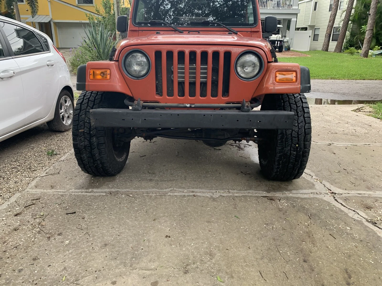

Here she is at the dealership the day of purchase.

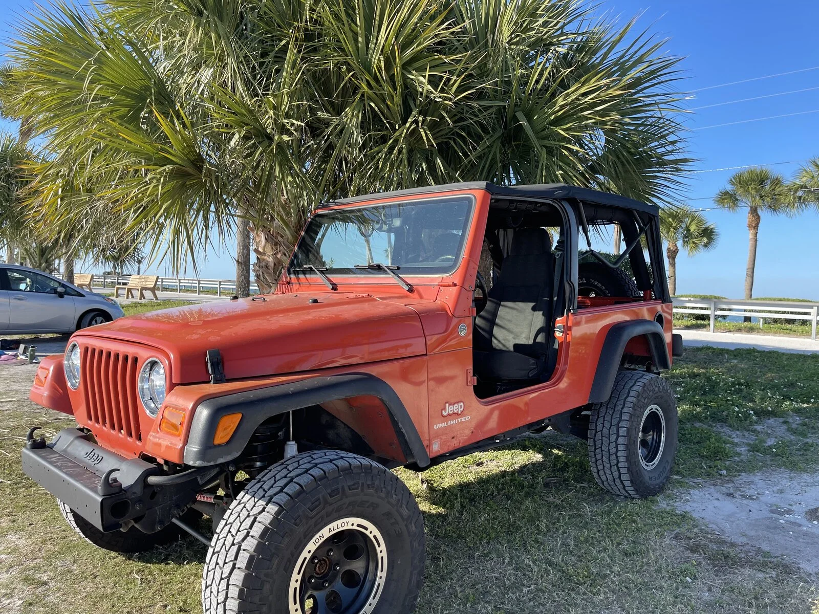

And how she looks currently. (Dealer installed a new soft top. Maybe it looks familiar to someone that could tell what brand it is?)

Welcome to the forum and LJ family. This looks like a relatively unmolested find. As you stated, a Rubicon would be nice, but overkill in your area. Drive it for a while, soak in some of the knowledge here, and make it what you want it to be!

Impact Orange LJ, bad ass. I love the color. I really wanted an LJ, but around here they are few and high priced. Looks clean, enjoy it!
Wait, is it orange or red? Hard to tell in the pictures, they look way different. Either way, nice Jeep.

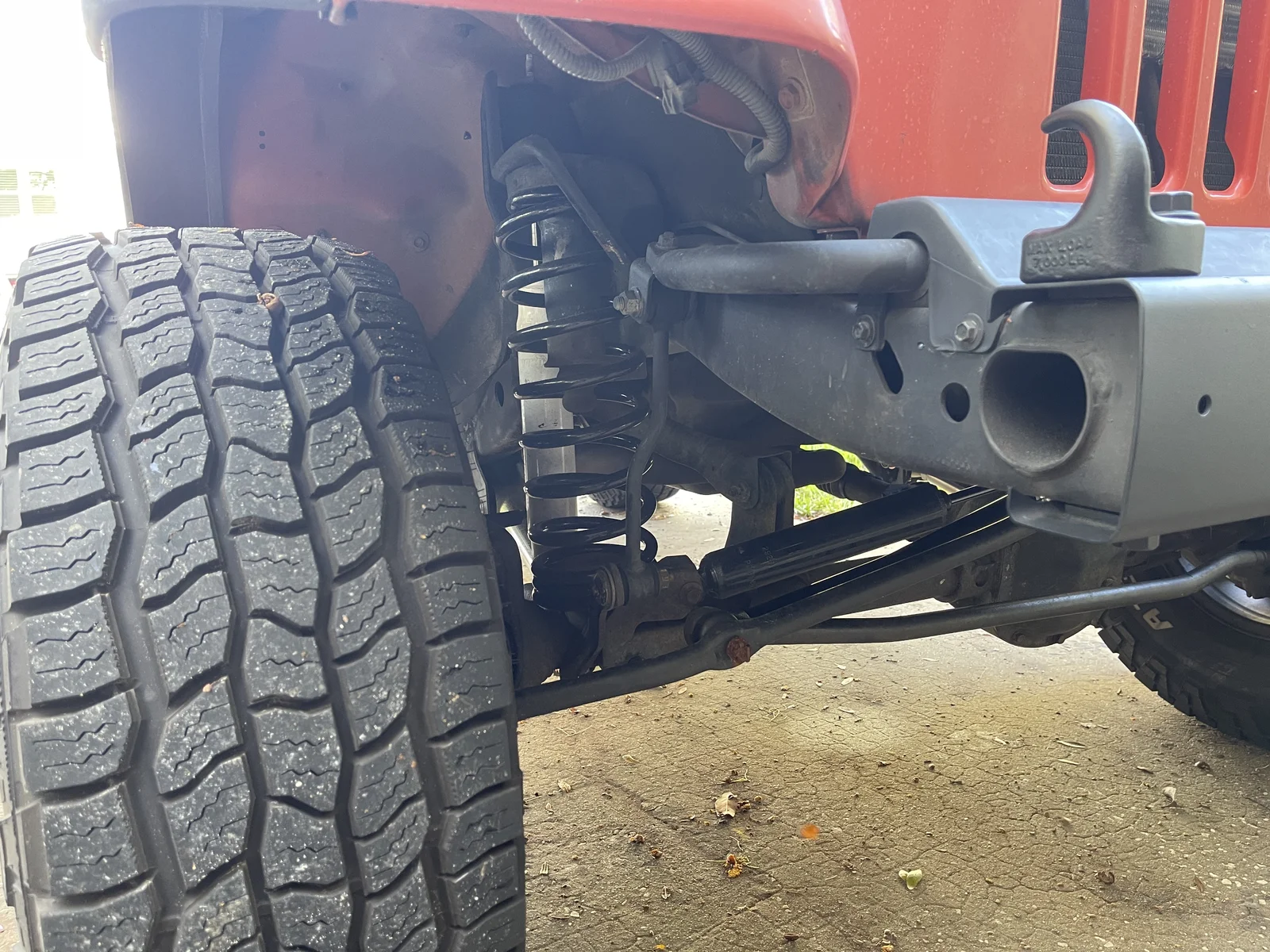

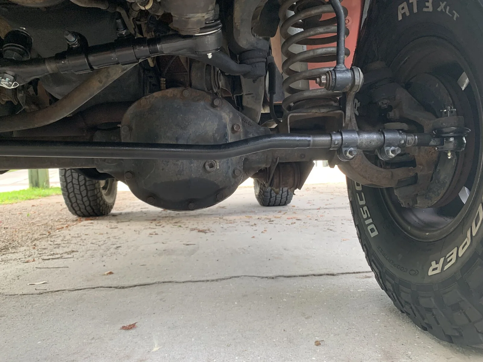

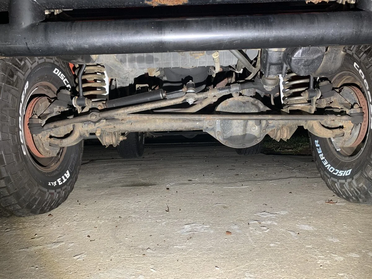

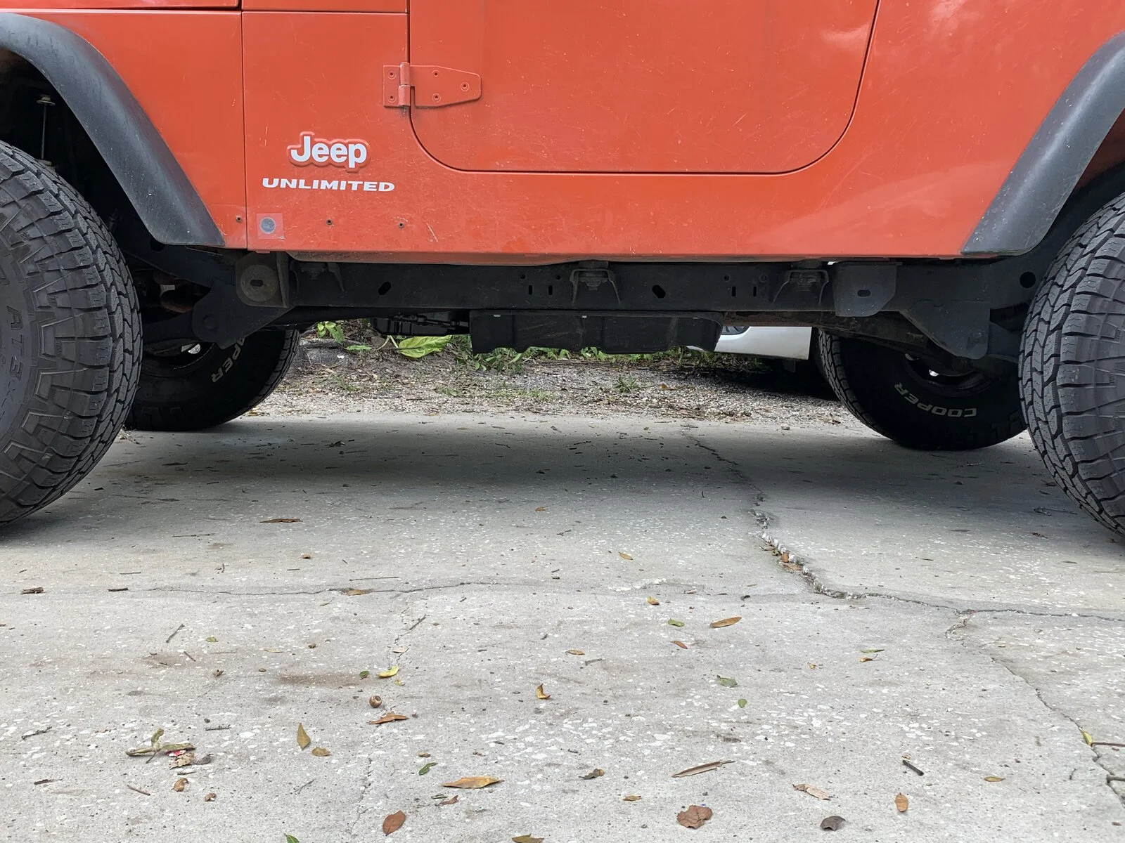

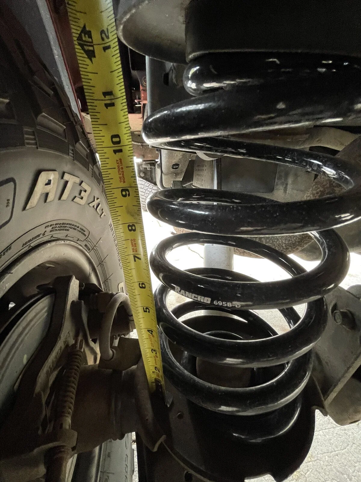

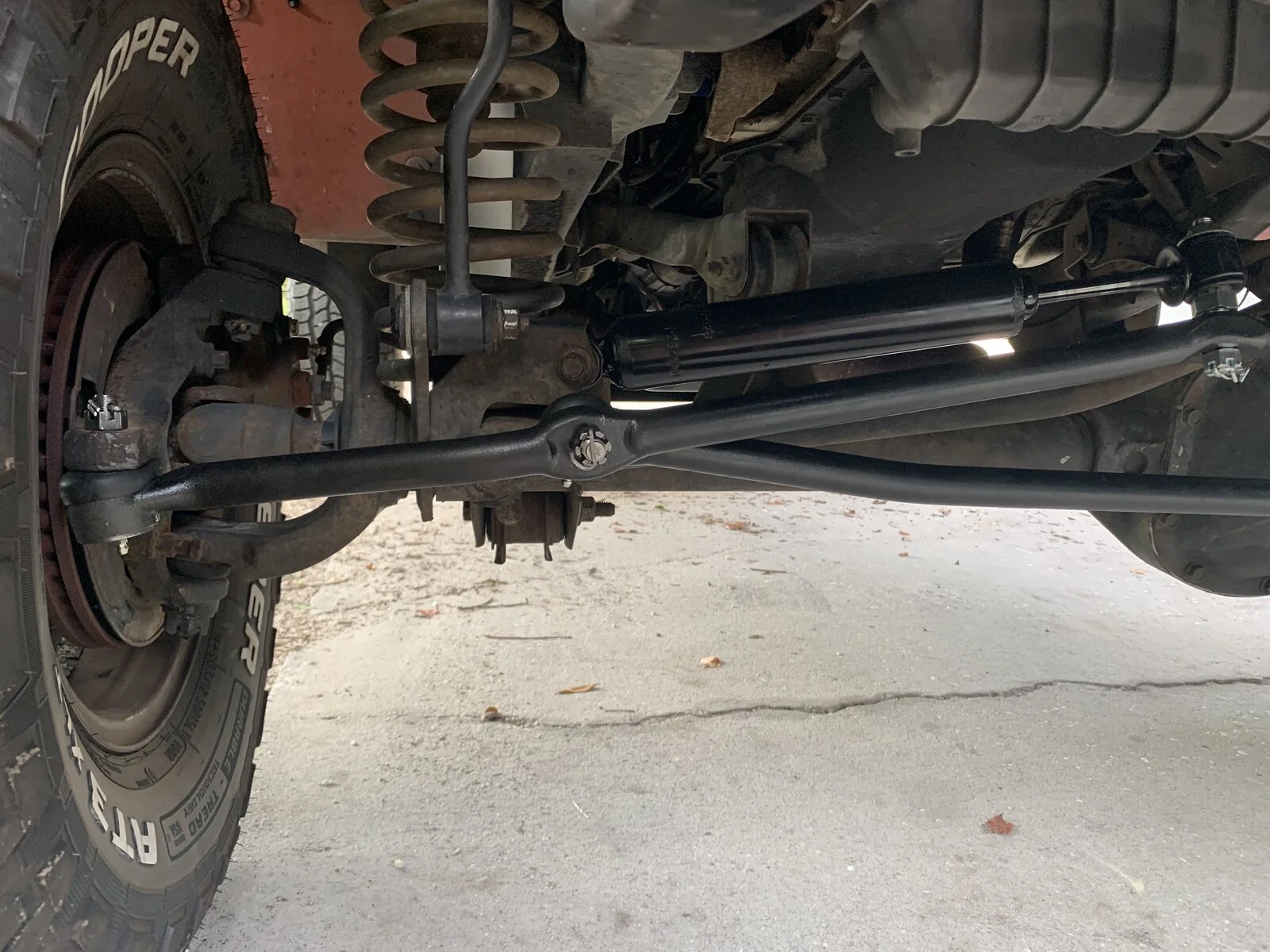

One of my more favorite colors for a LJ. Welcome. First off, let's determine what lift you have. Measure the coil springs at ride height, minus any spacers/cushions. Front is 12", rear 8" in stock trim. Anything over that, including spacers is lift. Let's also see some pictures of the steering up front to see what has been done there.

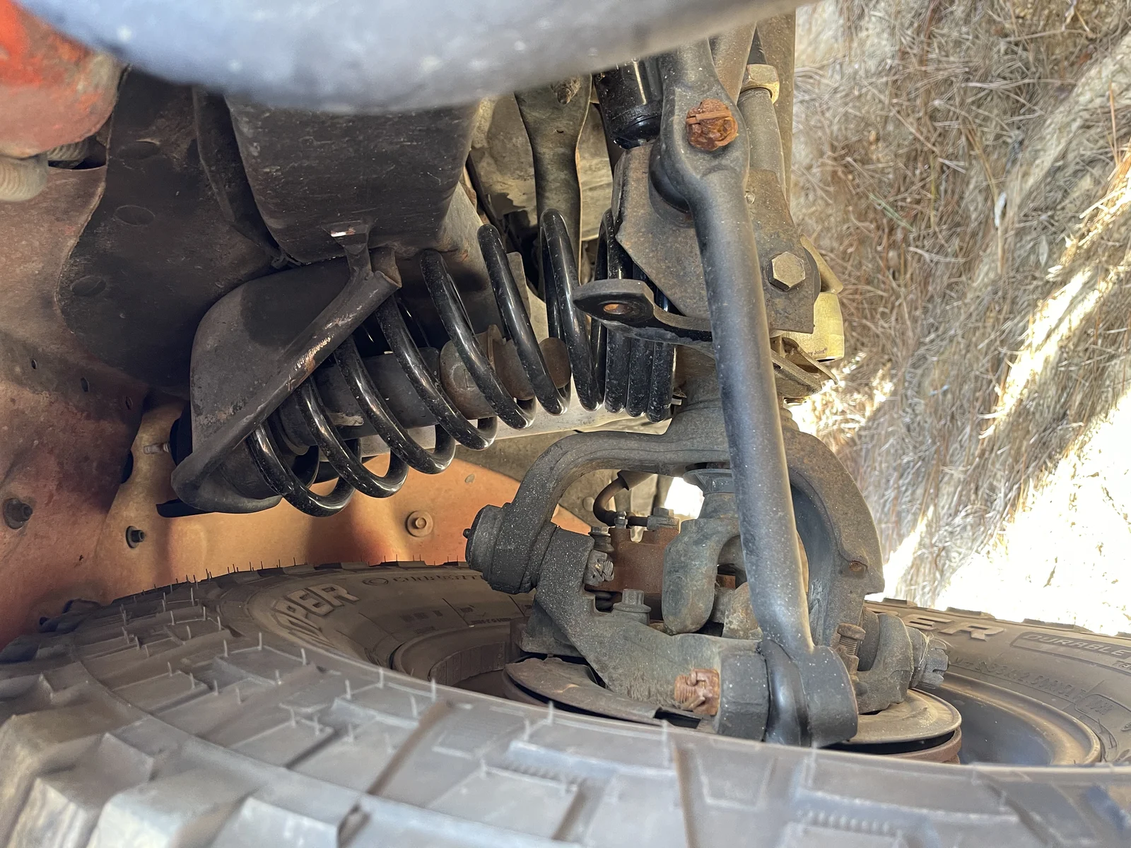

Thanks for the warm welcome everyone!
Here are a couple pictures I just took.
The steering setup
The springs measured at 14" in the front with a 1" spacer(?) and 11" in the rear.
Based on that, this would be a 3" suspension lift?
Also, I had just installed the Rancho RS5000X for a 2"-3" lift before I had started reading about proper up and down travel. So that is what you're seeing there.

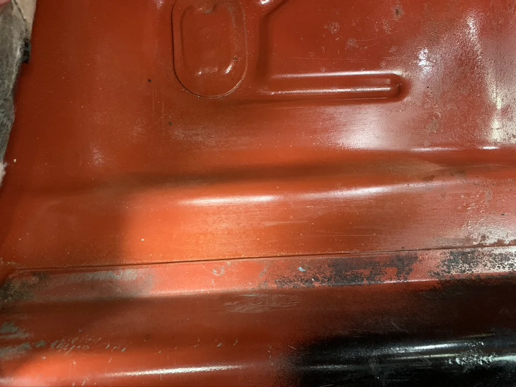

Wow that's one clean looking LJ. Is that the original paint?
As far as I know, the paint is all original. Neither of these pictures show it, but the front clip has pretty bad clear coat failure. Will have to be repainted at some point.
And I have found some rust:cry:
The black paint you see there is Rustoleum spray paint that I used to cover bare tub after buffing off surface rust.

Over the weekend I installed the Moog parts for the ZJ Steering Upgrade. This was a pretty straight forward swap with the only issue being getting the tie rod end connected to the pitman arm removed. Ended up just needing a bigger hammer, nothing a trip to harbor freight can't fix.
Also, it may mention this in the thread but I needed to buy a second tie rod end (ES3096L) and adjusting sleeve (ES2079S).

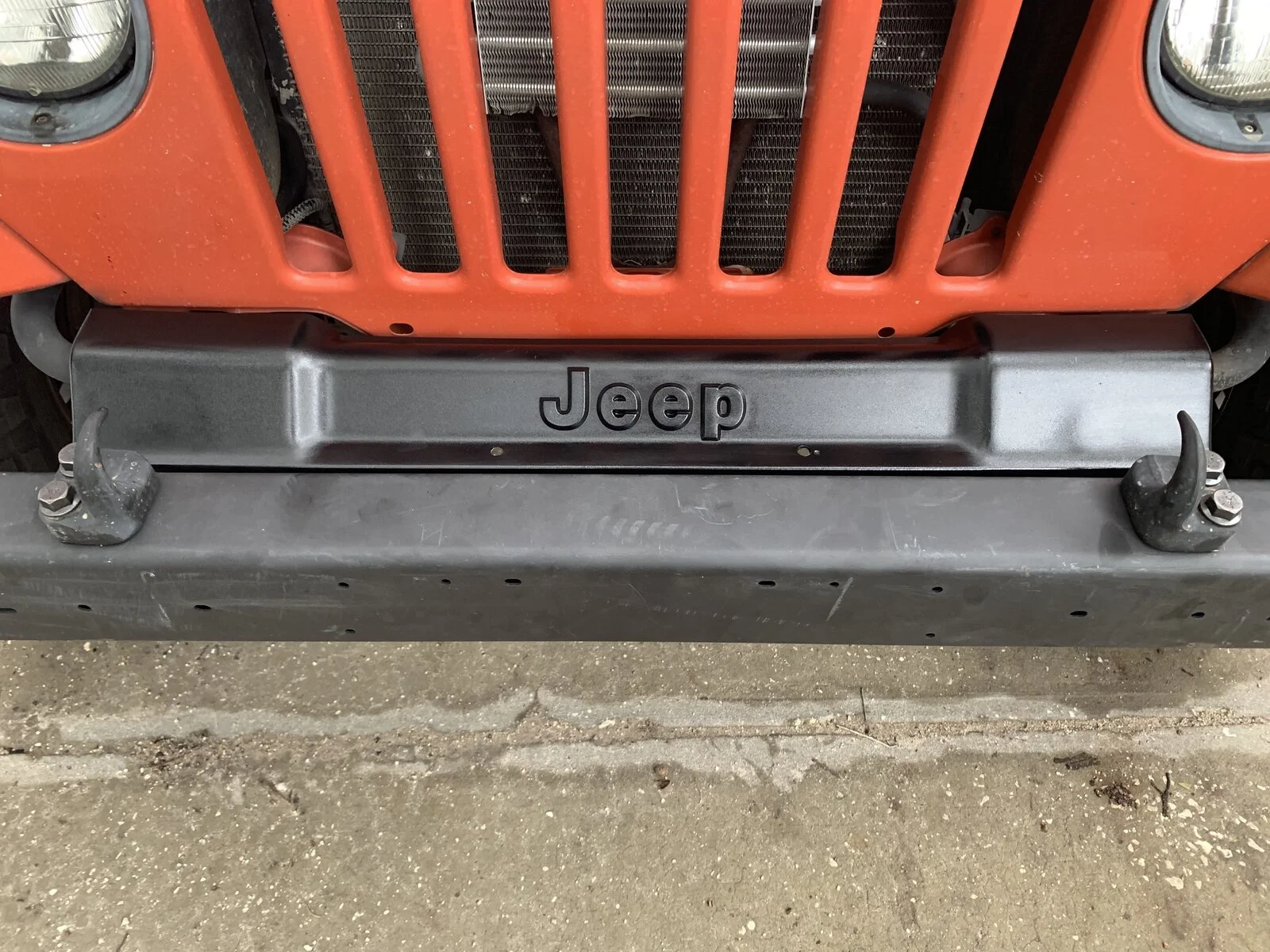

The new to me bumper. I plan to cut this to frame width while I wait for the $600 it will take to get a Savvy bumper to FL. Also removed the KC lights that were creating a rats nest in the engine compartment and didn't work anyway.

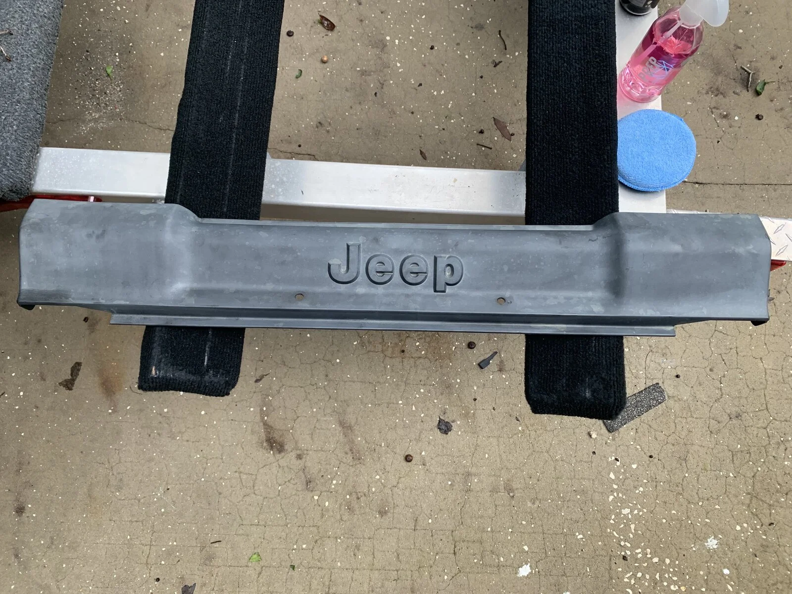

Also threw some Solution Finish onto the sway bar cover. Just had to clean it up with some IPA or similar solution and it takes the product pretty well. The second picture is right after application and before final wipe down so it has less of sheen now.
I plan to do the same to the headlight rings before I decide if I want to go with chrome or black with the new headlights.

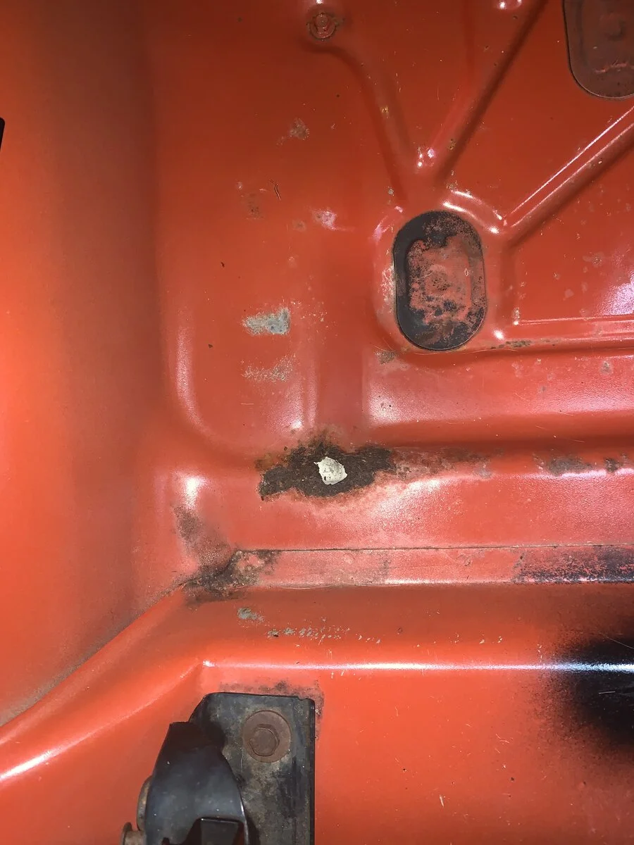

Got the rust fixed! Now I can put the carpet back in and cut some that heat coming up through the tub.
I'm super happy with the work, but paying what I did for it really makes me want to get a welder to start to learn the art.

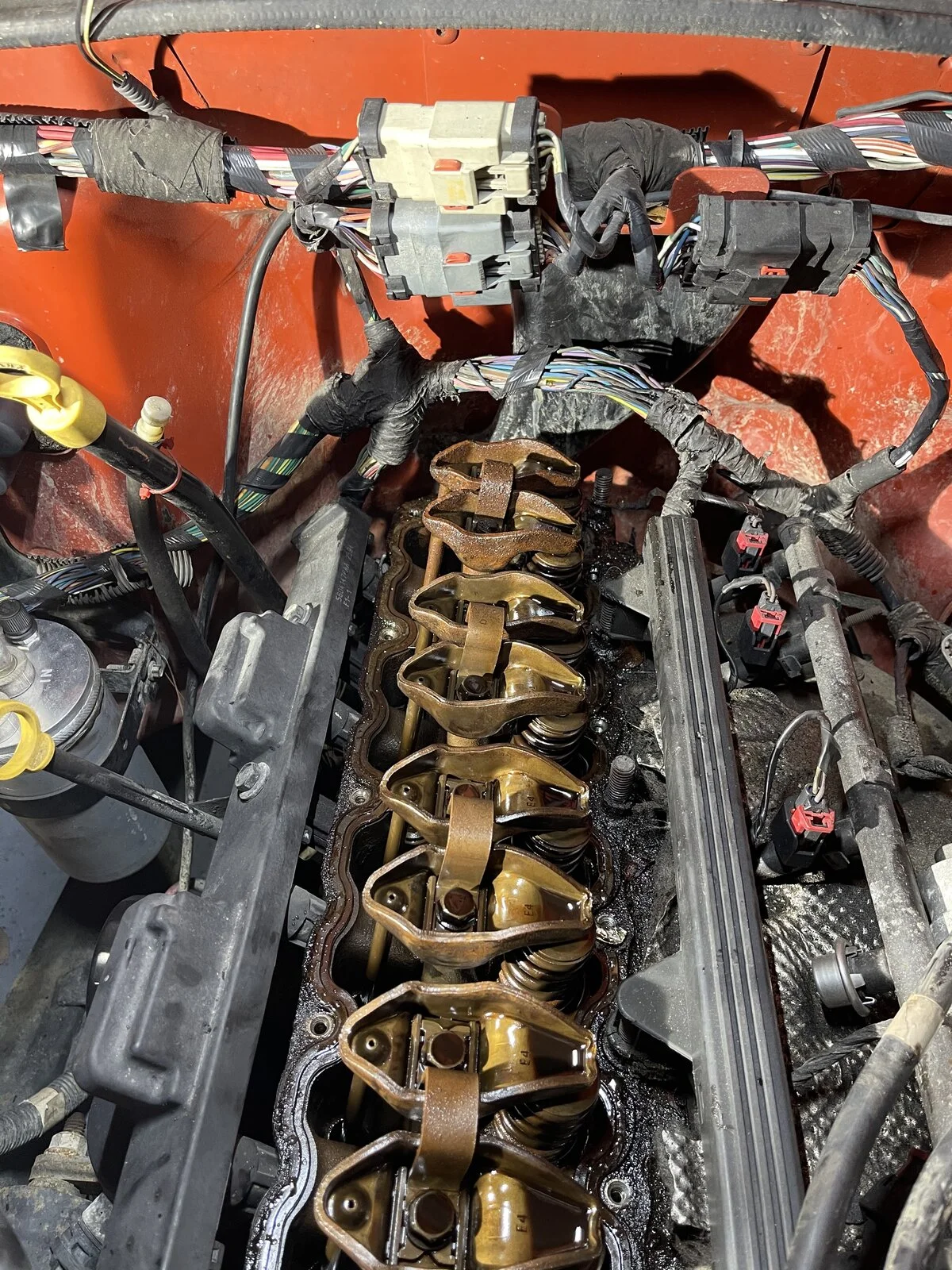

Got the valve cover changed and while I was there switched over to conventional oil. The leak has pretty much stopped at the valve cover but I do still see some small drips hanging off of the bell housing. The rearmost rockers are looking a little rusty for my liking.
Also, you may notice the lack of the super annoying plastic wiring harness bridge. I broke it off while doing the cover and it lead to some check engine lights from a chafed wire.

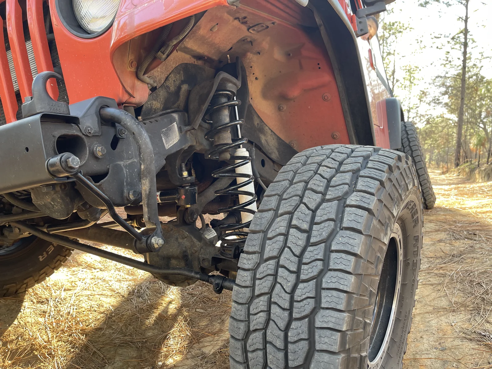

Ended up getting some new springs to replace the unknown brand that came with it. The ones I got are from the Rancho 3.5" lift kit mentioned in this thread: https://wranglertjforum.com/threads/anybody-want-rancho-3-springs-for-dirt-cheap.42365/#post-766547
They ended up giving me 3.5" in the front and 4" of lift in the rear. Doing this brought back the driveline vibes unfortunately so I was off to the hardware store for some washers, maybe dropped it around 0.25" with 2 washers at each corner the skid. This mostly took care of the issue but not completely.
I'm debating on whether I should get a SYE/DC Shaft or the upper rear control arms first to take care of that. I can get some Savvy arms for $200 so I am leaning that way.
That's strange. I don't recall anything like that when I did my valve cover gasket. I wonder how common/uncommon that it and what causes it.
I broke a piece off of mine but managed to keep it usable.

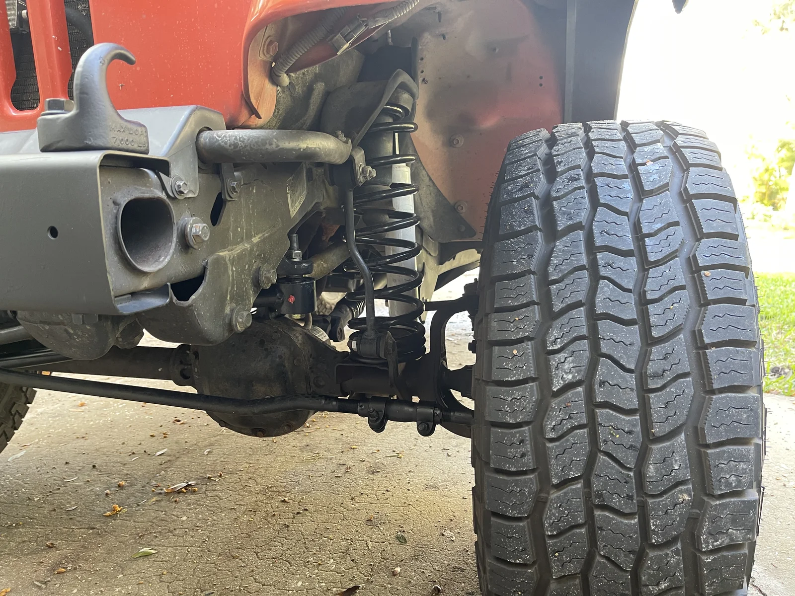

Was able to take it out to test the changes that I've done. Had some rubbing that damaged the fender. I noticed that when one side was stuffed, the spring was banging each coil on the frame as it passed over. Is this a common problem? The spring is seated fully against the perch.
