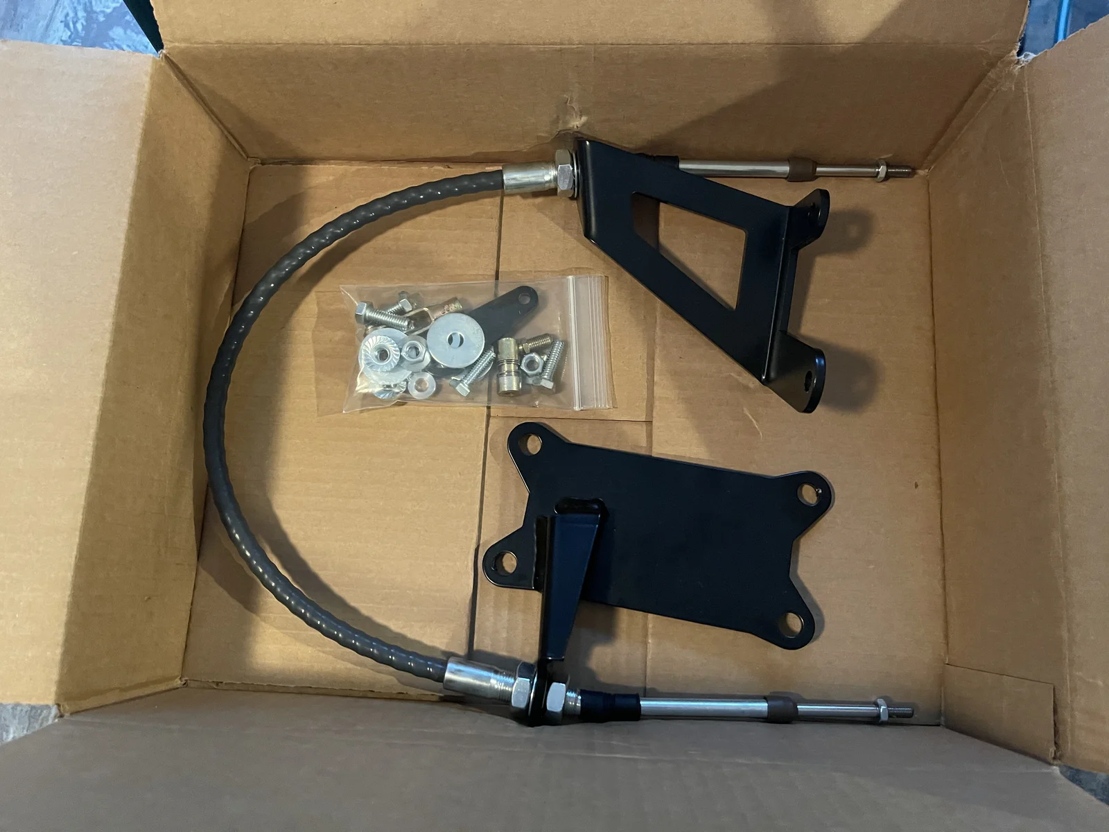

Savvy Shifter is here! Showed up 4 days before expected when ordered from Amazon.

Awesome. Mine should arrive this week also. Hopefully the install is straight forward.

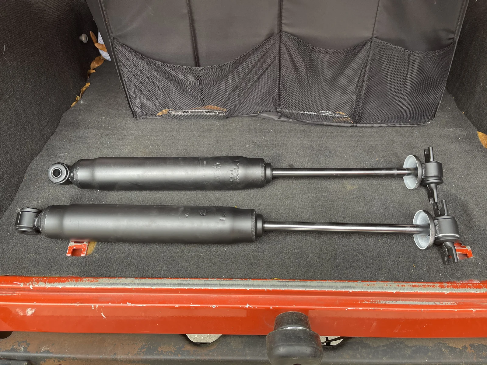

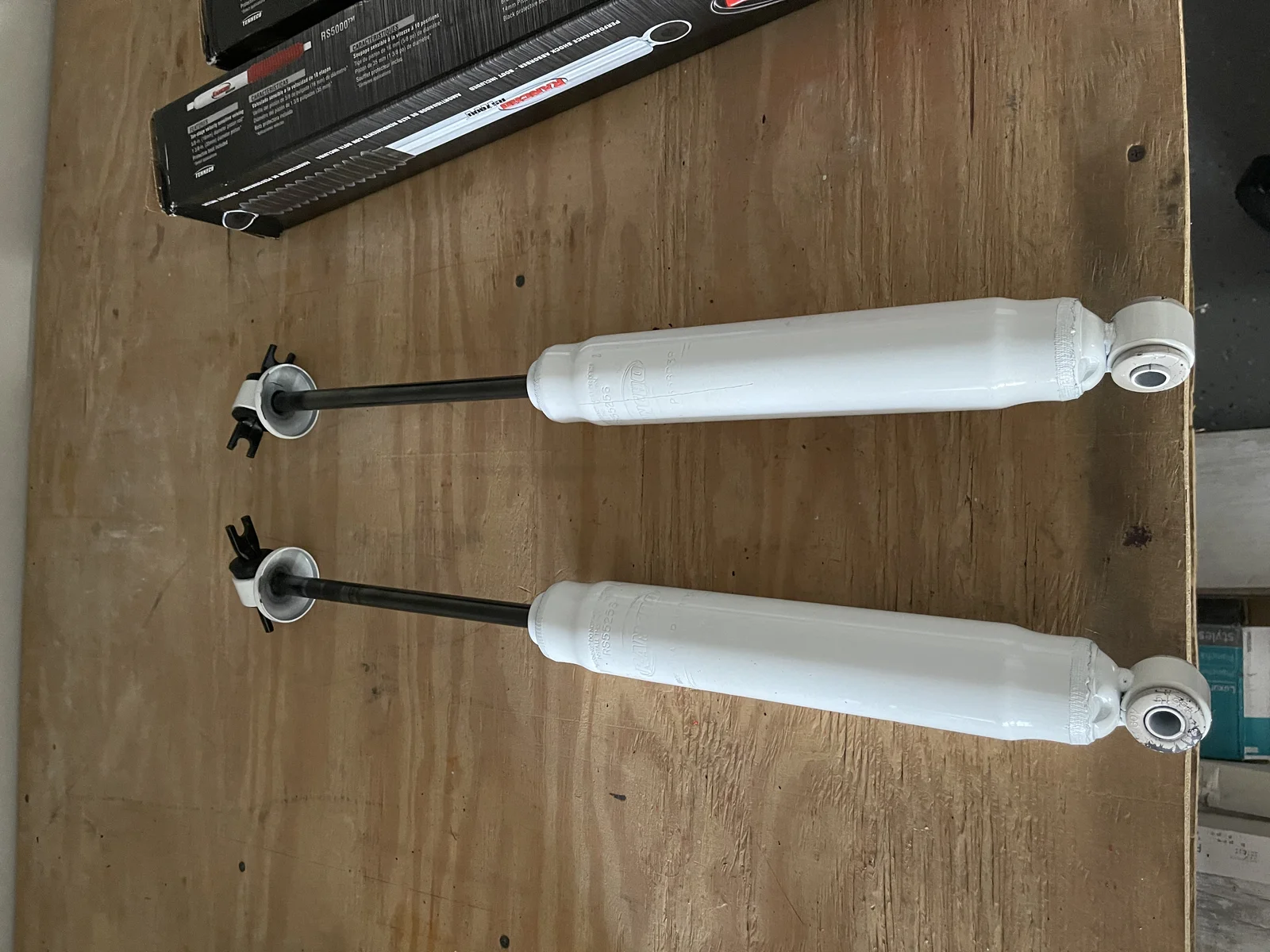

Got longer shocks (RS55256) in the rear along with currie relocation brackets. Threw some paint on the and on they went. These were off a few months ago so no issue with rust on the upper bolts.
The previous shocks were making contact at ride height with the spring perch. This along with them being almost fully extended at ride height made for a terrible ride. They had no room to expand and were dragging the ass end into every hole.

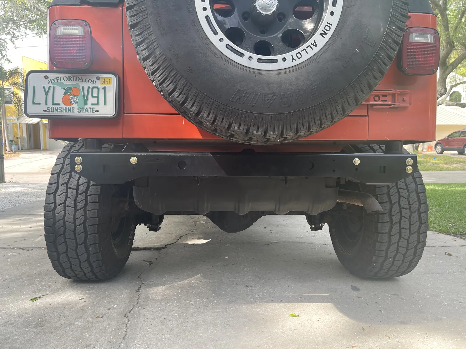

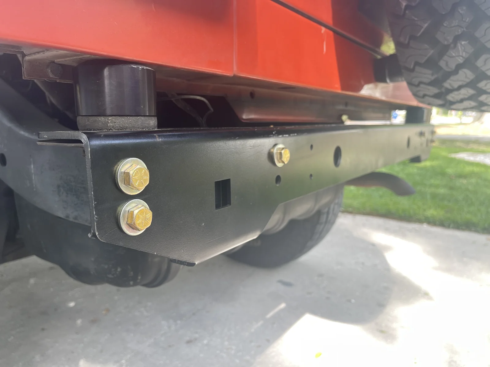

Found a Genright rear crossmember locally and traded a case of Naturdays for it. I'm interested in having some shackle mounts welded to it but don't know the best way to go about it. Looks far better than just the factory crossmember.
