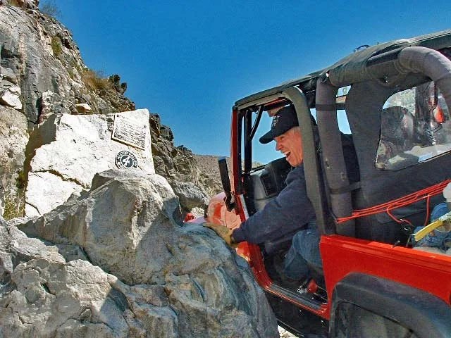

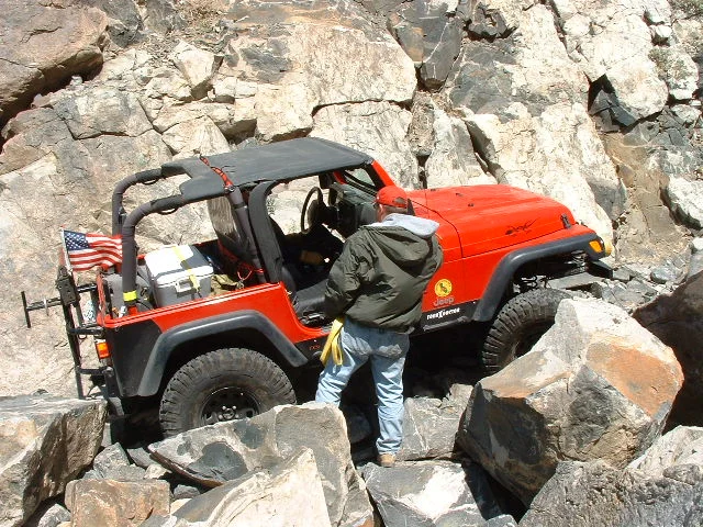

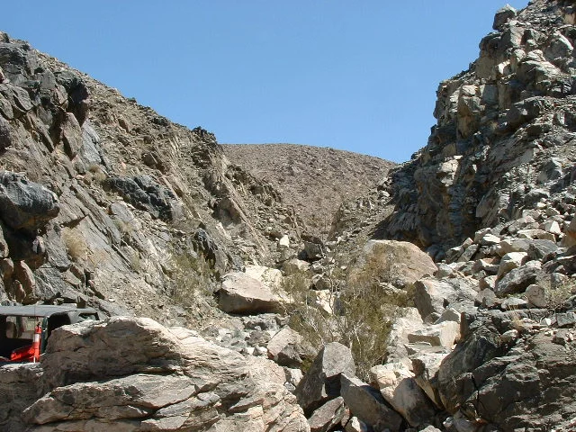

P.S. I broke my front axle shaft that day... these are from that run in 2003 that convinced me to convert to an automatic.
View attachment 231507View attachment 231508View attachment 231509View attachment 231510
