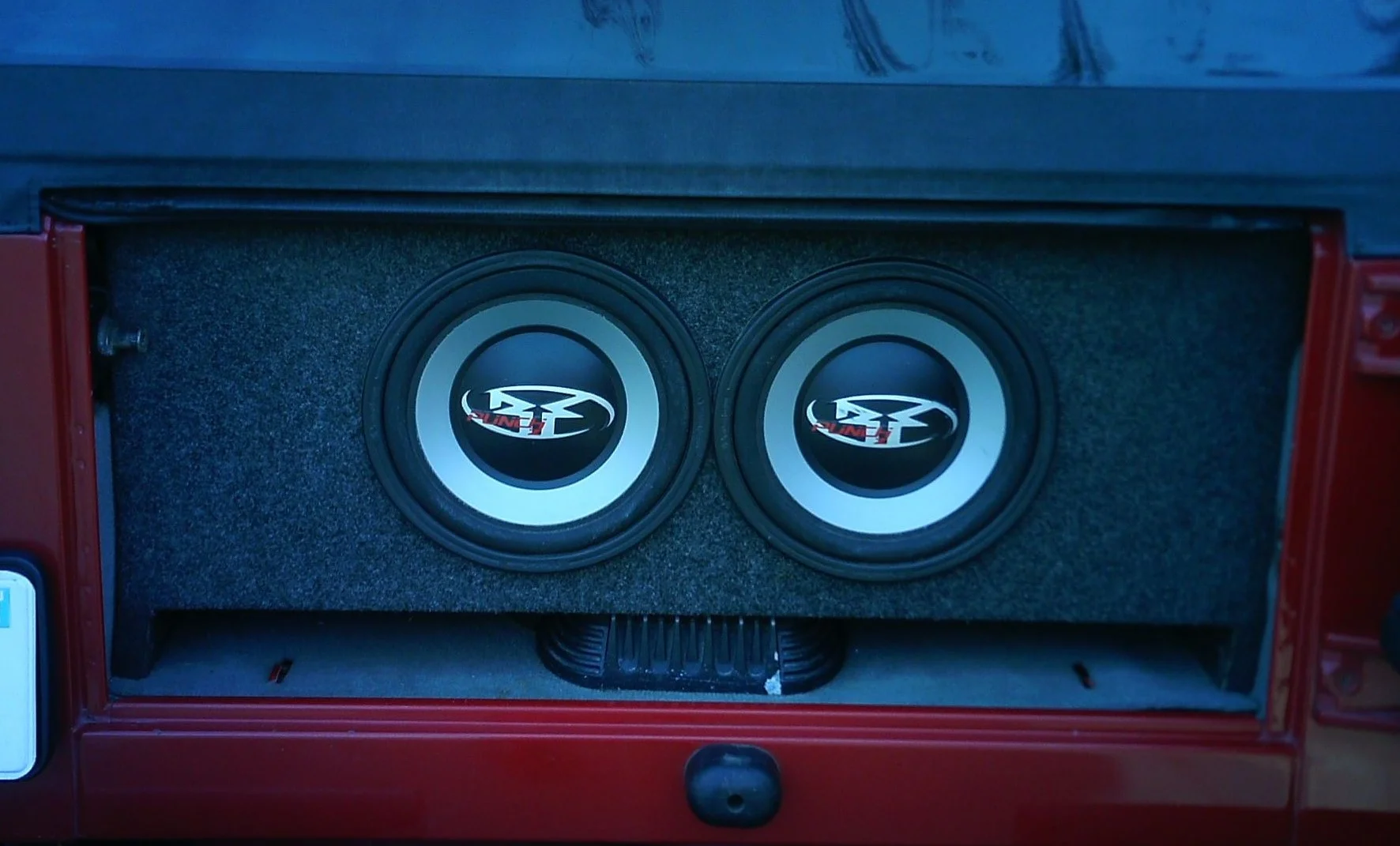

Get a high quality/powered amp with speakers, if you want to keep the crappy stock head unit. Get a 8" sub (minimum) if you want good sound with any type of music. I went one step further with mine.
p.s. Crutchfield is your best bet and free installation gear with most stuff they sell.
