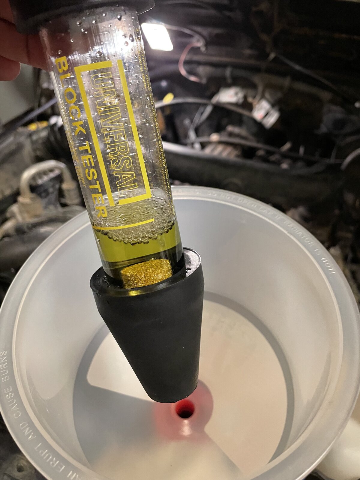

You are screwed. Sorry:). Head gasket or the head itself in the worst case.
Well....I flushed out the thermocure and put in prestone stuff, then I tested for an exhaust leak again.
This time I pumped more slowly and was more diligent in keeping the fluid out of the tester.
Passed.
I think I bit off on bubbles from incomplete burping and fluid ingestion from being too quick with the pump.
Now, what about the attached video showing a possible crack in the block under the oil cap?
My last oil change analysis mentioned the possibility of coolant in the oil.

Your theory is that a mix of thermocure and distilled water would cause the tester fluid to become yellow? This would an interesting experiment. I would try to mix thermocure, water and tester fluid just to check the theory.
