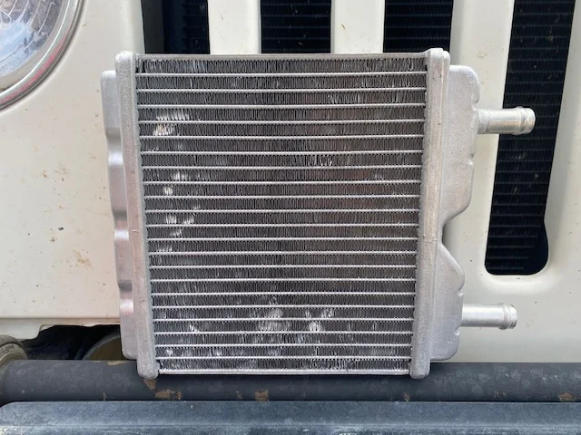

Just add an Auxiliary radiator plumbed to the heater hoses and be done with it.
I have been do this for over 50 years.
You can fit it behind the grill.
He is a CJ3 heater core, $35 from Rock Auto,

I bought this YJ heater core and 6 inch fan, for which I need to build a small frame (similar to what Derale cooler for 42RLE), and add a thermostat for the fan to activate at around ~200F ish,
The location of the aux unit will be in the back, under the tab. There a place under the tub, close to the where the ebrake cables are, where it will fit perfectly. This way it takes the heat out of engine Bay Area, and does not have negative impact on the airflow to the main radiator.
The sole purpose of this aux radiator is to help with hot idle, or very slow stop and go traffic, this is why i want to put it far from engine bay.
