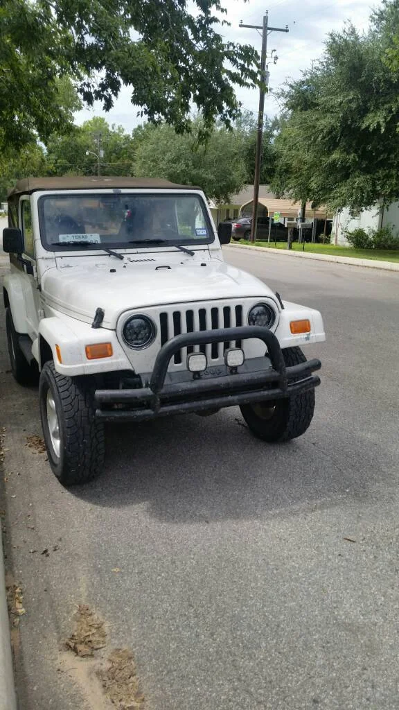

I absolutely love mine http://cloud.tapatalk.com/s/57f62727d3d52/20161006_051045.jpg?

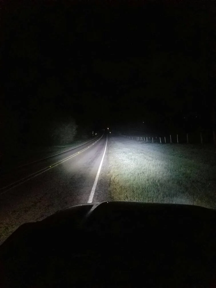

Lowbeam http://cloud.tapatalk.com/s/57f62755cfb67/20161006_051038.jpg?

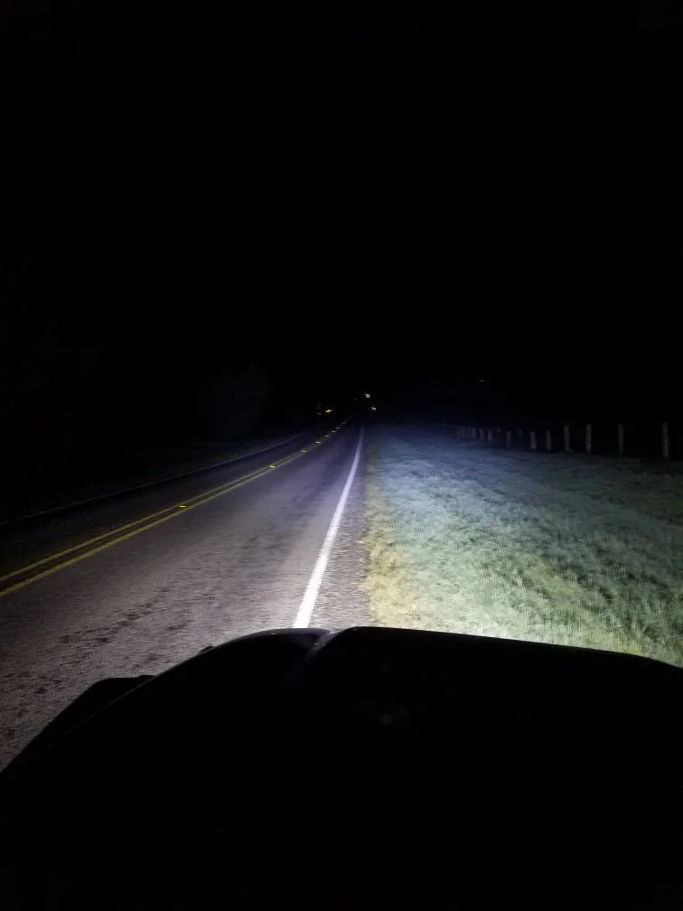

Highbeam http://cloud.tapatalk.com/s/57f6279332237/20161006_051052.jpg?
Lowbeam with driving lights.
The driving lights alone are brighter than the stock sealed beam halogen headlights
