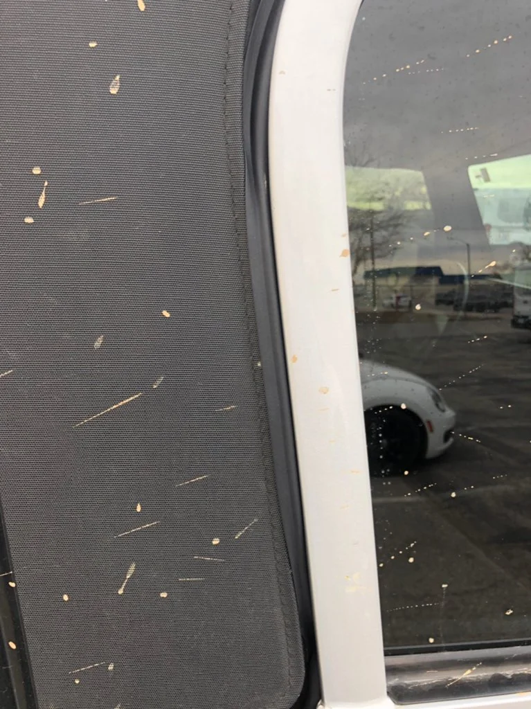

I just installed the OEM seals. I figured the vehicle went for 10 plus years before they started to show signs of wear, so I wanted the best. I could close my doors with my pinkie because the seal had no pressure when closed. So, I installed the new seals the other night. It’s amazing how much tighter things seem to be when closing the door, it’s like closing a JK door now. The glitch now is that part of the seal remains outside the door, hung up on the soft top material. I took it by Jeep and he believes either the door is bent or it will work it’s way in. Both doors do exactly the same thing in the same place. I can tuck it in with a finger. It’s supposed to rain tomorrow. We will see if the leak stops.
