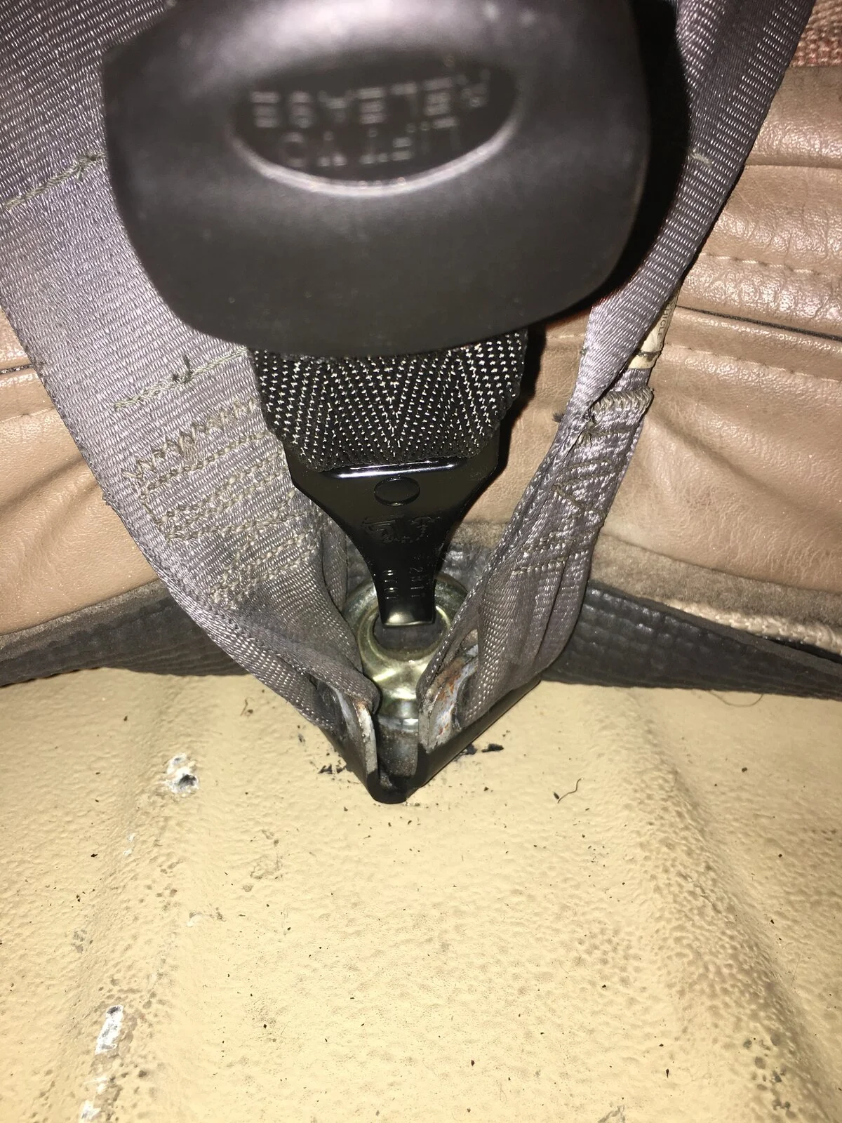

2000 TJ, so no latch system. We used the Chicco Keyfit system for a little while in rear facing mode. We now use the Chicco Myfit forward facing. Both were placed it in the middle of the rear seat with the seatbelts cross fed through the seat or base. The extra room between the front seats was needed for the rear facing, and is still nice with the front facing. Kiddo crawls in and plops down in her seat on her own. I have plenty of reach to buckle her, but it’s a stretch for momma. I replaced the bolt holding the rear seatbelt latches on the floor with a racing restraint eyebolt (not a hardware store eyebolt) to attach the top strap.

Hi there. I too have a 2000 TJ and am facing the same issue with my soon to be 4 year old as he so badly wants to ride in the jeep. I also bought the Chicco Myfit and would like to install it in the TJ however, I've struggled with finding the OEM top tether part to get it retrofitted. SO, I'm VERY interested in the work you did where you replaced the bolt holding the rear seatbelt latches on the floor. Would you happen to have any before and after photos? Obviously after photos would be the most helpful...Also, would you happen to have any photos (and possible URLs) you could share of the racing restraint eyebolt you used? I so badly want my son to be able to go for rides with me but I really want to feel comfortable that he is safe/secure and I'm not familiar with the hardware so I don't want to guess! TIA :)
I used the G-Force 109L which screwed into the existing threads. I think the thread pitch is 1/2”-13. It’s hard to tell from the picture, but you just screw it in until the shoulder below the eye is tight against the plate holding the belts.
https://www.summitracing.com/parts/...NPtSQ1VZdC8DNdGOXVwmgW0x1joY5-ikaAvkJEALw_wcB
