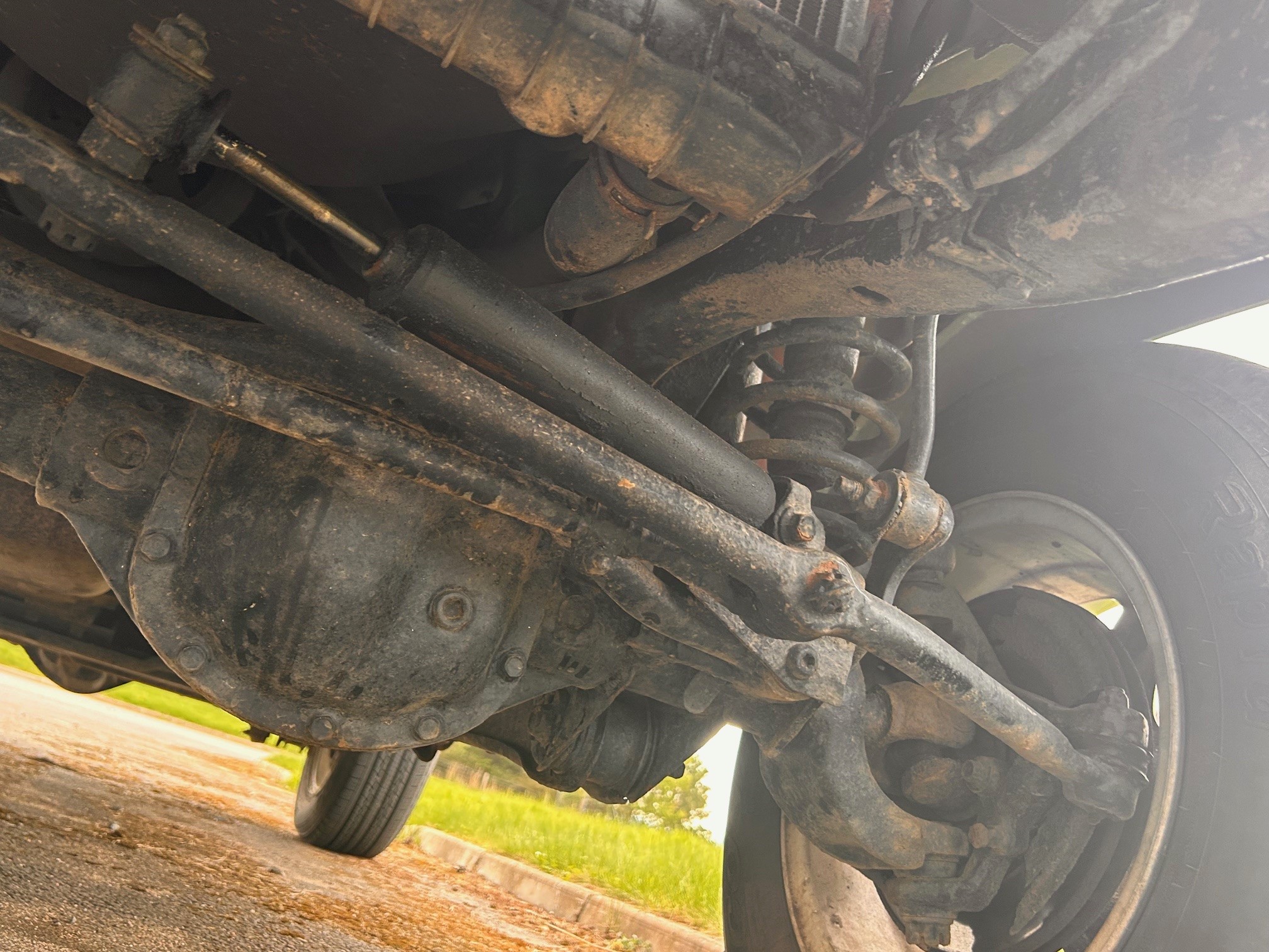

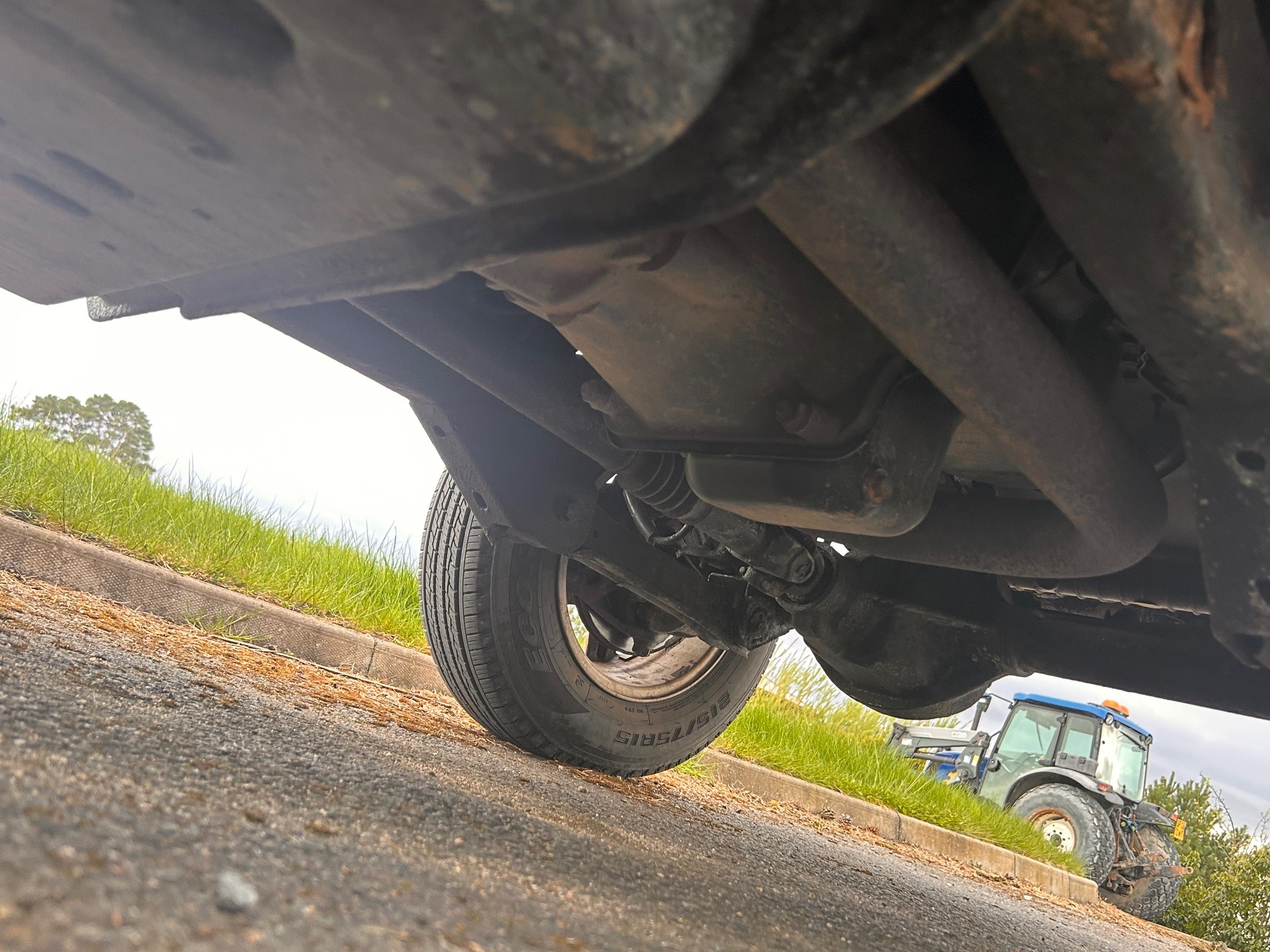

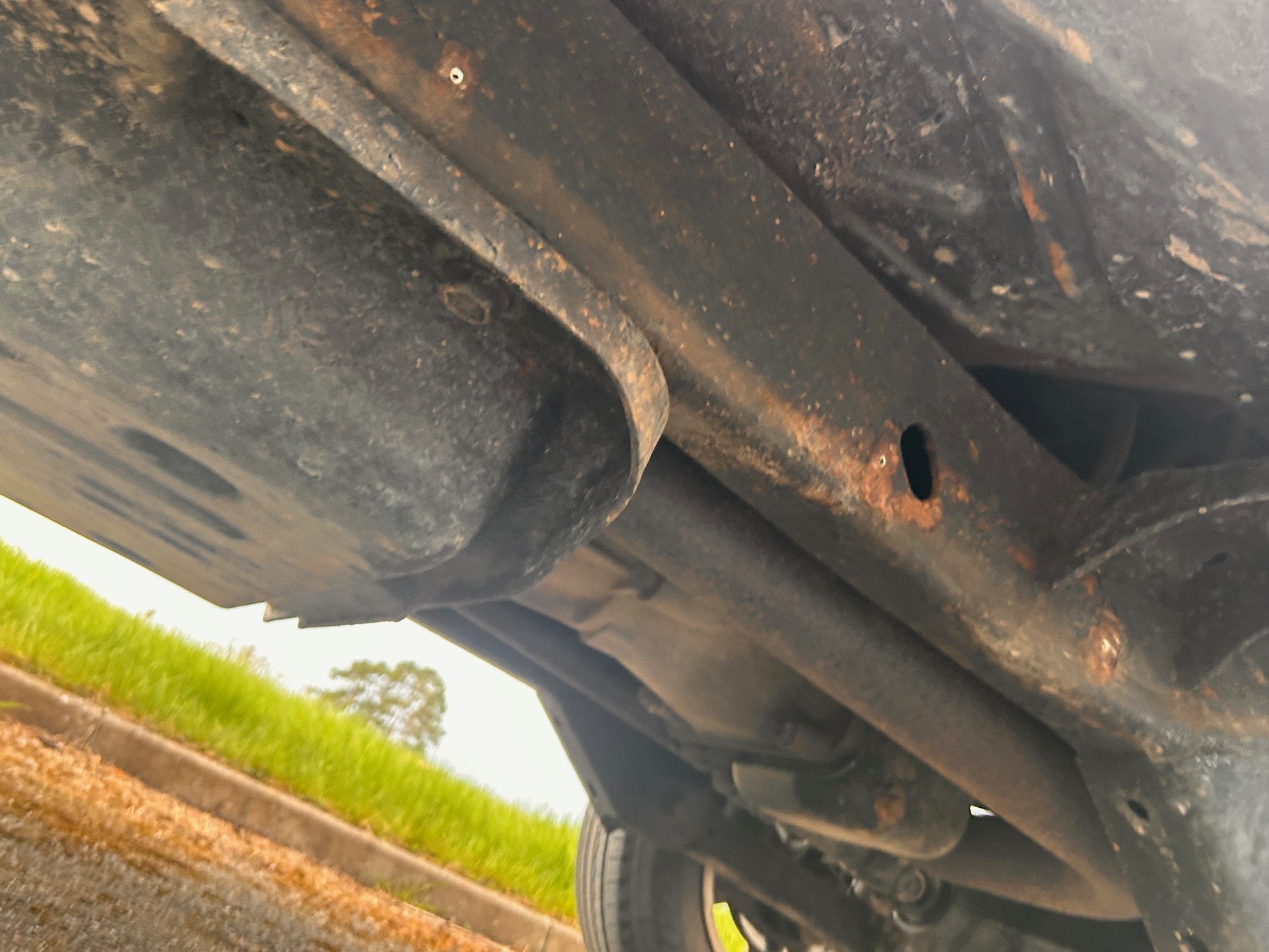

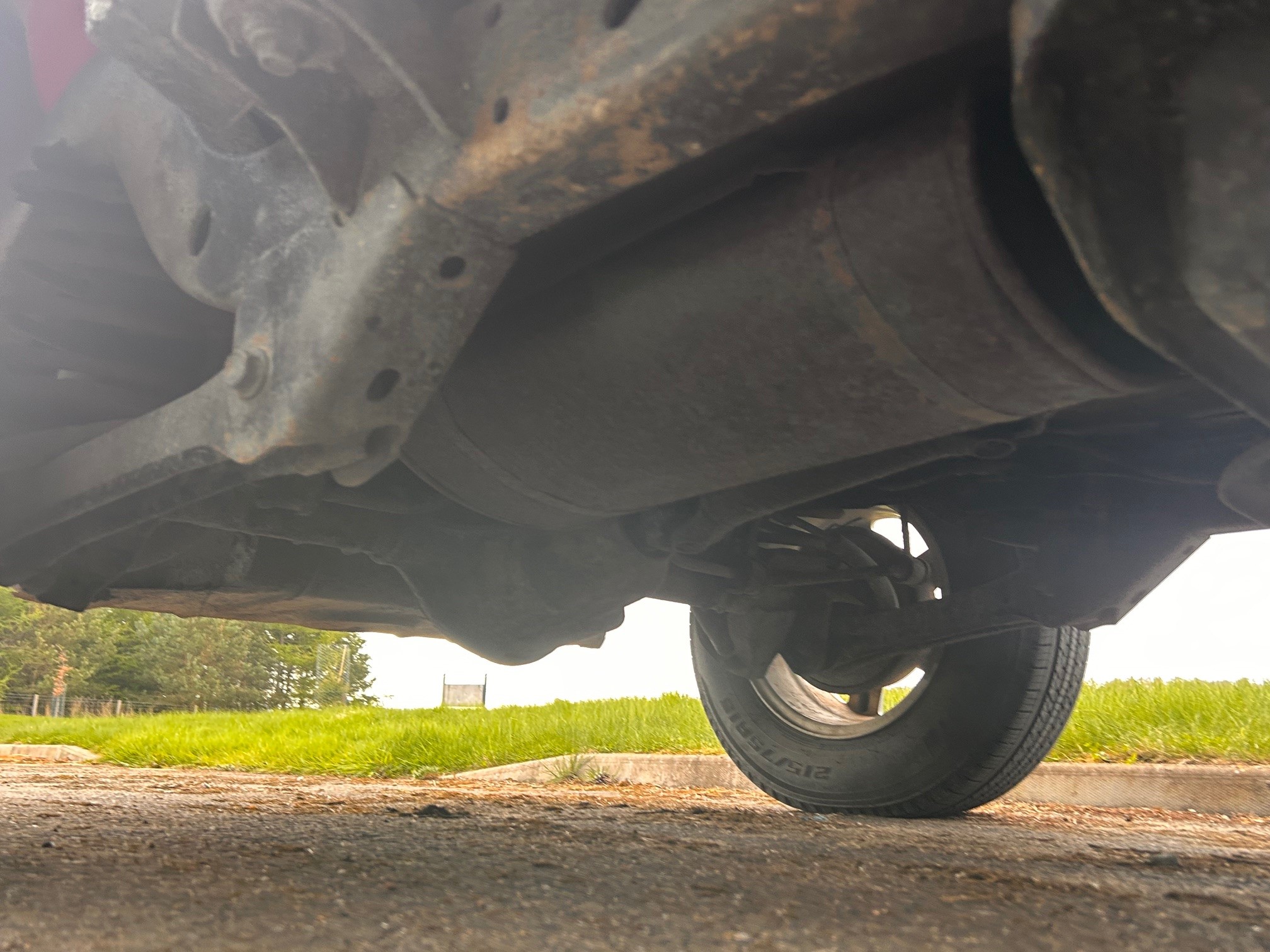

Hello. I just joined the forum and am very excited to learn more about my recent purchase — 2003 TJ Wrangler (Rubicon) jeep w/64k miles. Before I purchased it, I was well aware of the problems w/a boxed frame (which I believe is a design flaw) and how it is prone to rusting from the inside out. Would like to know if anyone on this forum has any options or recommendations on how to remove the rust from the inside of the frame. I've viewed a few YouTube videos and some owners have suggested using various tools (plumber auger w/chains) to remove the rust. But I think that is cumbersome and may not remove all the internal rust. Note — my jeep has some rust inside, but it is difficult to tell...there is also very little surface rust on the frame (i.e., nothing is rotting; and I can take care of the surface rust myself). The concern is how to deal w/inside rust. Thank you very much for allowing me to join this forum.
I agree that a clog hog, or any kind of sewer jetter, is a good way to go.
I did this a while back and my notes are here.
Reactions: Rut Row
The clog hog is the only way. Tip...do not get one intended for an electric 1500psi jobber. Buy one for 4-5,000psi and rent a pressure washer of that caliber for the day.
Also, a 20 dollar endoscopy off Amazon will have you looking inside the frame, not guessing.
There are ways to remove the remaing rust that is not chiseled off from the pressure washer. Then a proper coating will have you safe.
Jeeps rot from the inside out. Visible rust on the outside has a high probability of originating on the inside.

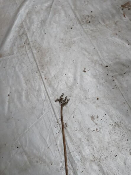

All good suggestions above, in the end I prefer to use multiple form of attack starting with a chain flail. We ran his short piece of 1/2 snake with chain threaded in thru every opening and it cleaned everything in its path.
