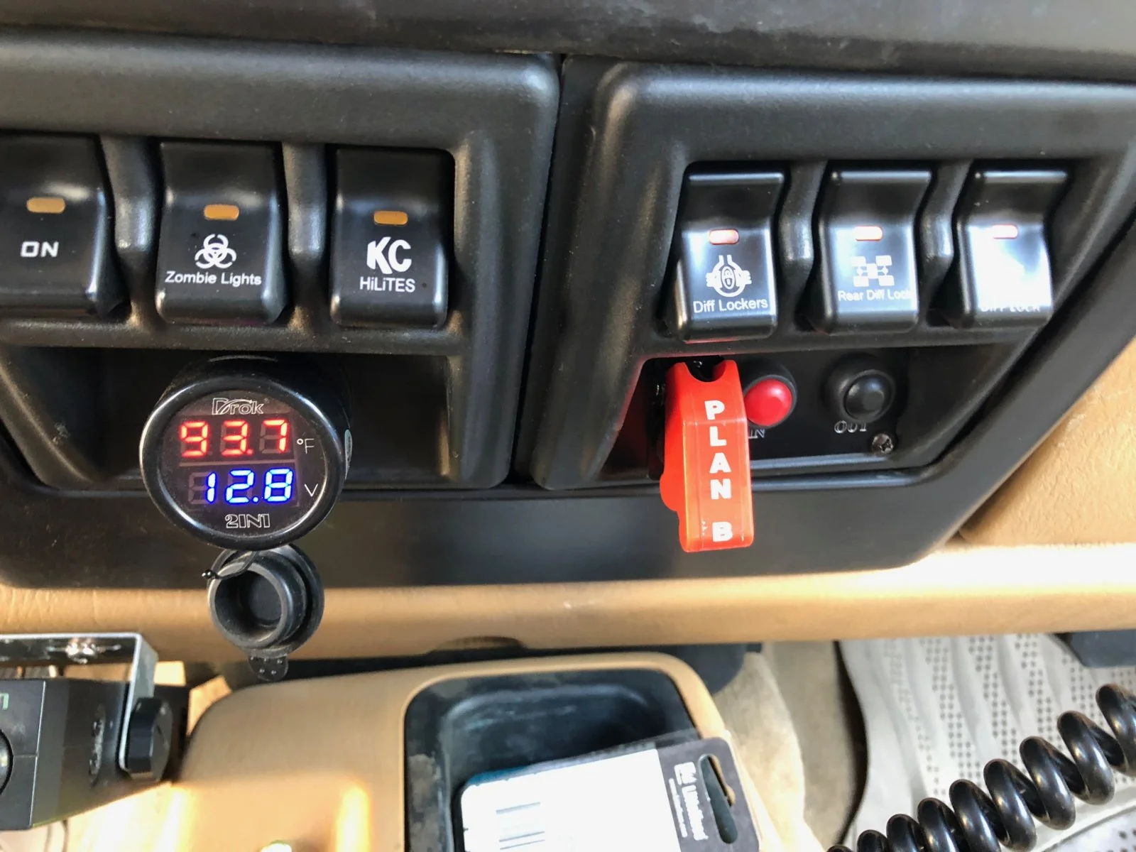

I like the switch modification....very cool. So you removed the ash tray and added another standard switch module, great idea! I was thinking about. Going to an 03-06 bezel and switch module, but this mod would give me 6 switches.
Reactions: ac_
I like it a lot. The picture looks wonky, in IRL it looks normal. I think it is where and the angle of the camera that makes it look a little off.
I like that mod a lot. The other switches are hard to see in the picture, but they are main power for the diff locks one says rear locker and the other says front locker. I spent a lot of time wiring all of that up, but it is rally worth it.

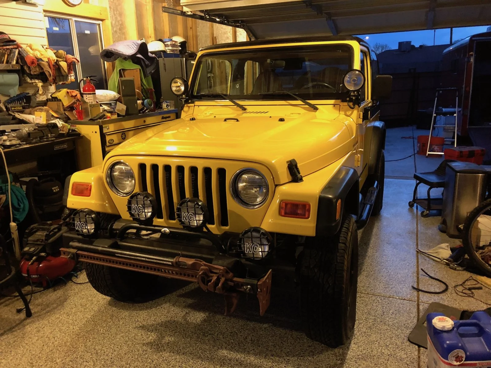

Just for your viewing pleasure of KC hilites. Here is my and my wifes Jeeps:
Also my switch inside:
Judging from the massive mounts, I'd surmise that Zombicon has Daylighters, and the ones mounted on the yellow one's windshield frame are also Daylighters. But what are the one's on it's bumper? Are they Slimlights? Also, do you know what brand the windshield frame bracket mounts are? Are they also KC, or something else?
