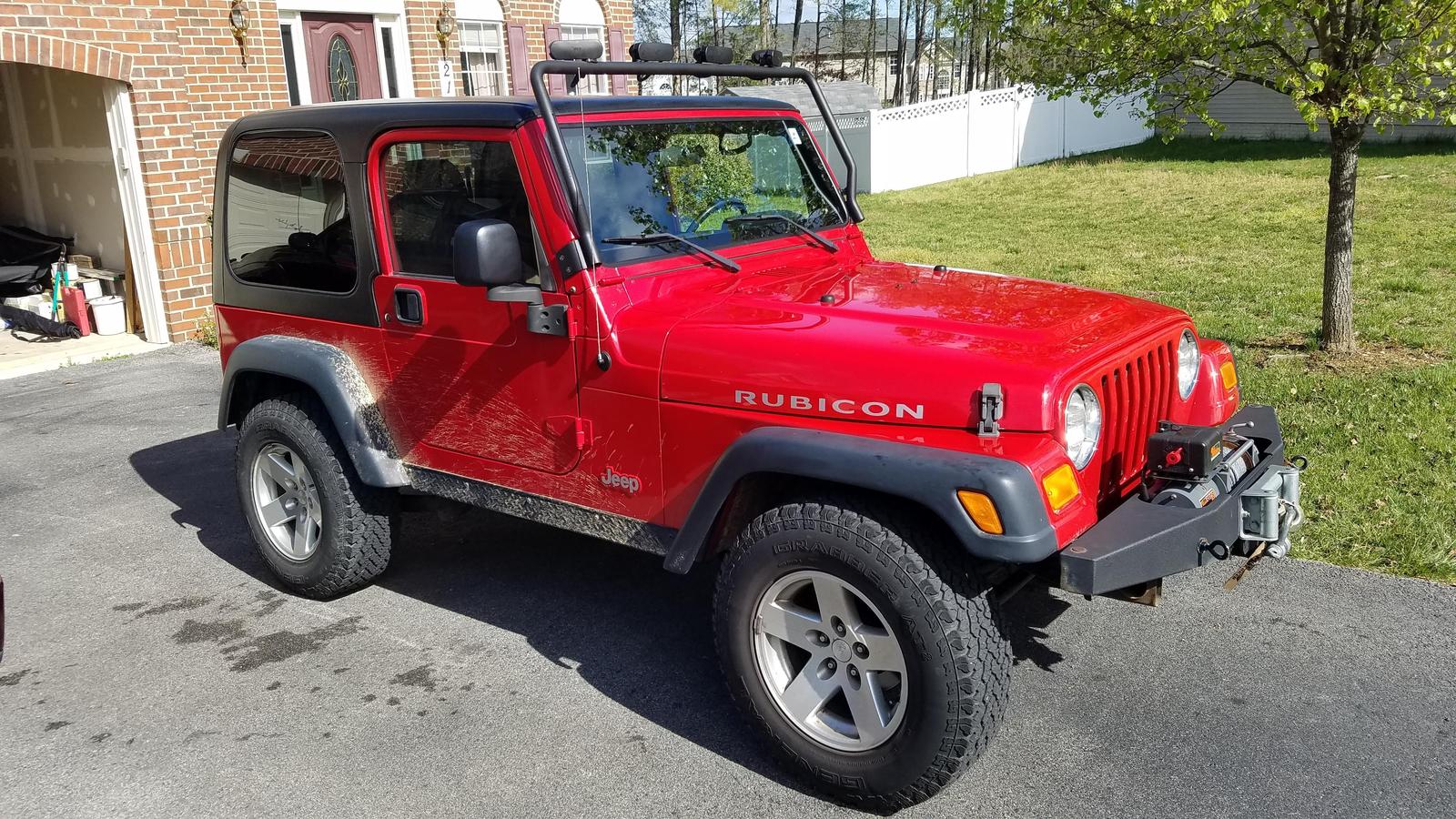

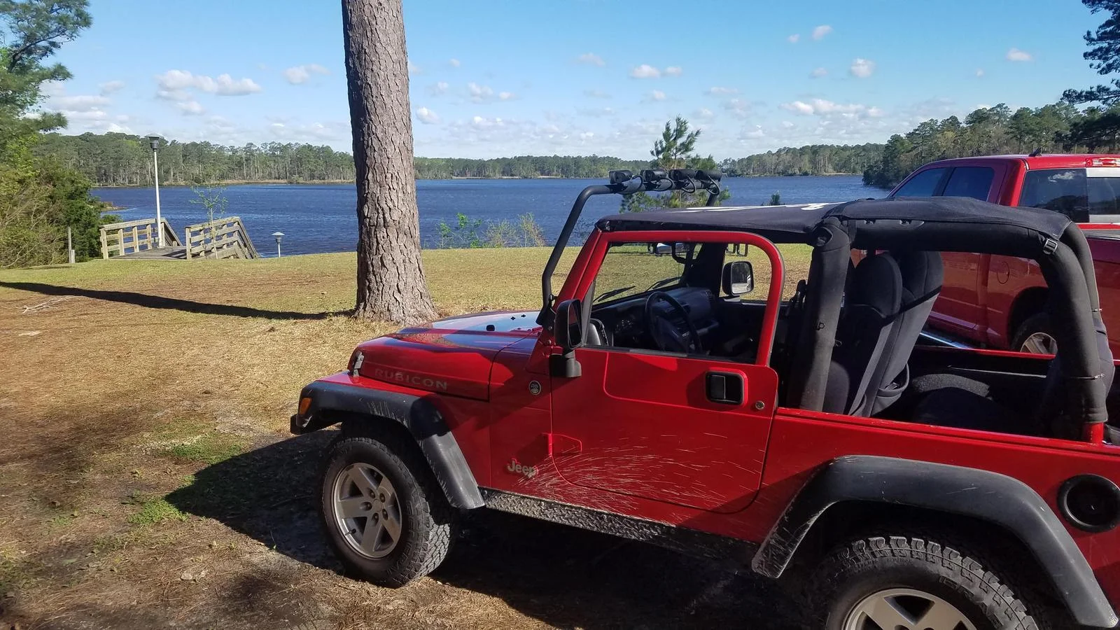

So this thread serves two purposes.
1: It will catalogue progress as I mod and fix various parts of this Jeep.
2: It allows me a venue to bitch without tagging on to other people's threads.
So the vehicle in Question is a 2006 Rubicon, automatic, that's starting it's trip almost bone stock.
Nope, no nickname for it yet.. though "Bitch" is the strongest contender.

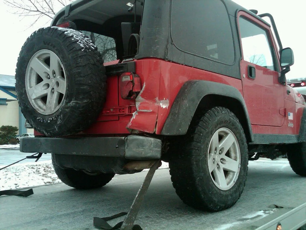

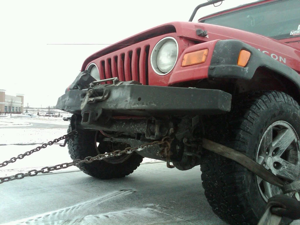

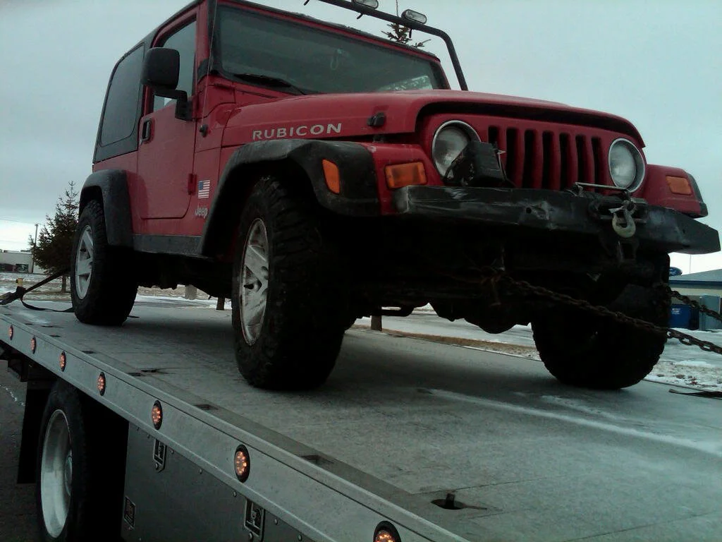

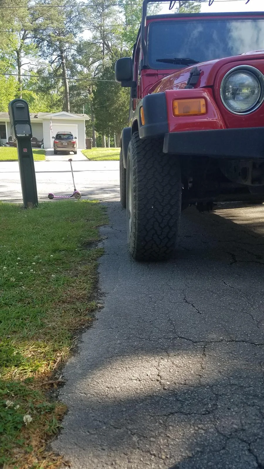

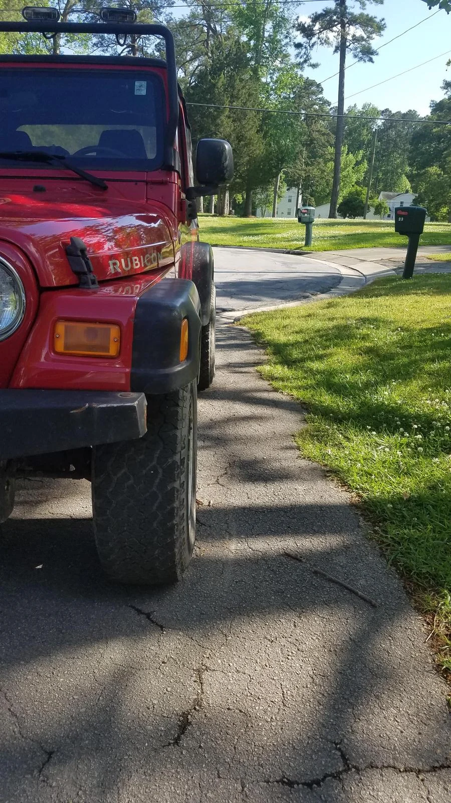

2: Can't really take her off road at the moment because the front control arms and control arm mounts need to be replaced. An after-effect of the collision that happened a few years back when my father-in-law lost control on a patch of black ice out in Chicago and put it nose first into a guard rail. The shop that did the work on the Jeep somehow missed the fact that the lower control arm mounts on the axle were bent over to the side a bit, so now the axle is being pushed out to the passenger side by about an inch, putting some stress on the rest of the components under the front end. Rear end was fine despite some corner damage to the body.
The sway bar end links were also pretty much destroyed in the accident. I'll replace those eventually, once I get the control arms fixed.
Edit: Found some damage pics
There's actually some rust here along this panel now. Something I'll need to grind out and re-seal.

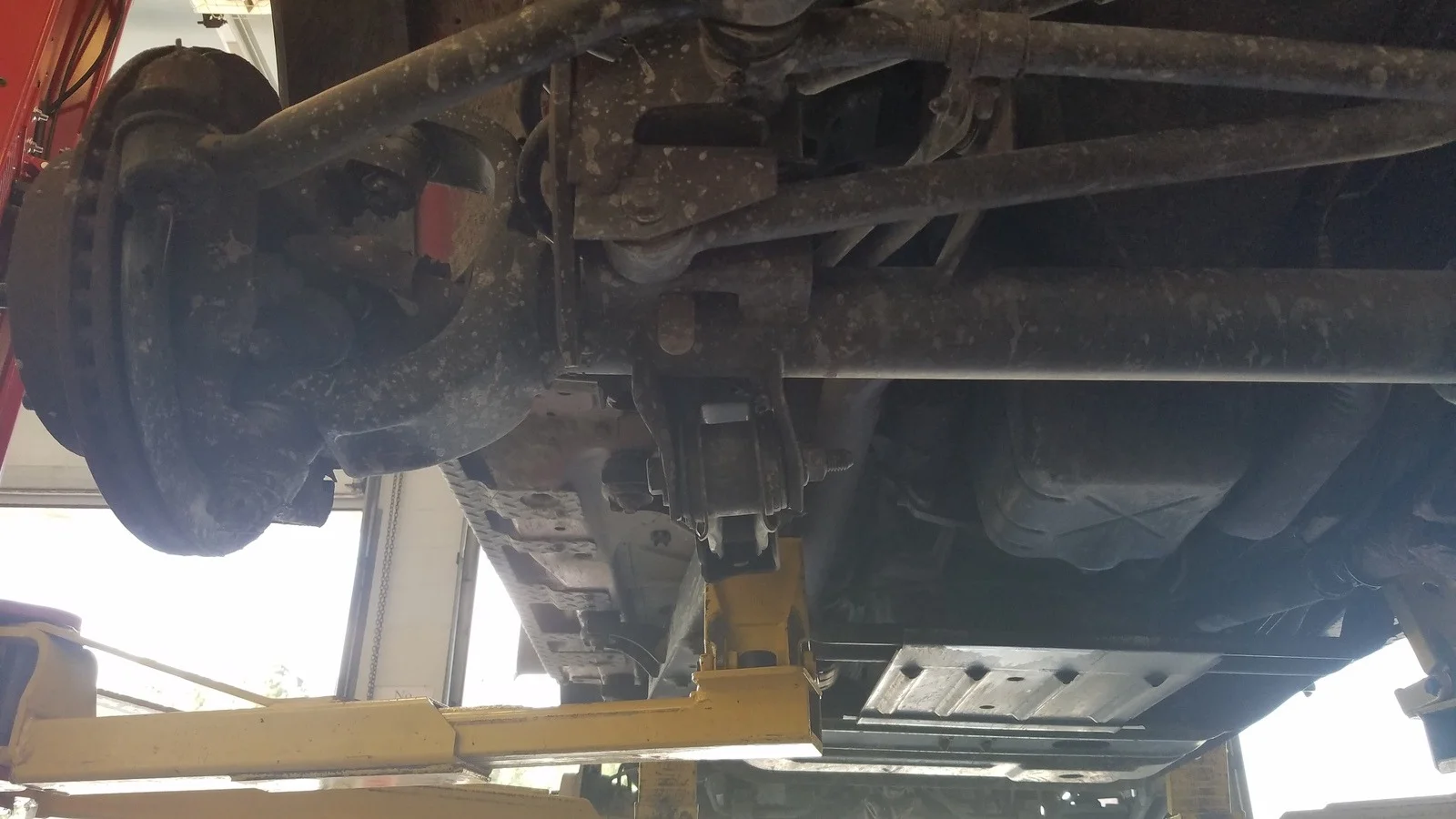

Here's the worst offender:
That's the mount that's pulling everything to the passenger side. Once it's straight (The driver side mount is still straight.. enough) everything will line up properly again and she'll be good to go. All I need to do at that point is replace bushings.

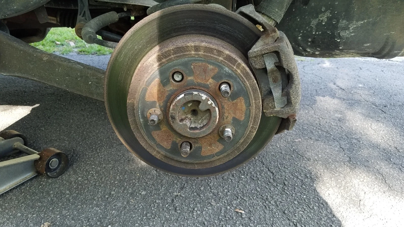

Fixed the missing stud on Saturday and, by proxy, figured out how to remove the rear axle shafts. That was an interesting experience.
Didn't drive it on Sunday save for a few seconds to move it out of the driveway so I could get the car behind it out and then when I jumped into it to head to work this morning my damn front axle locker light was blinking at me.
