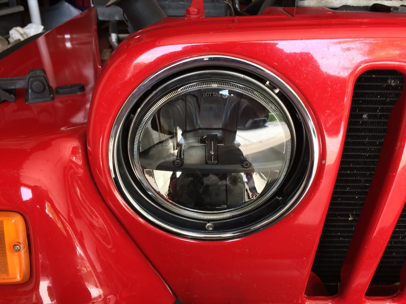

Purchased new led headlights from eBay today, trucklite knockoffs, and was wondering about adjustment. I have read different posts and viewed videos and my question is these lights have a very distinct vertical line when close to wall but have not had the opportunity to back out to 25 ft or drive yet. Do I want to set these with the distinct line on my vertical wall mark or drop it down 3 inches? Thanks
