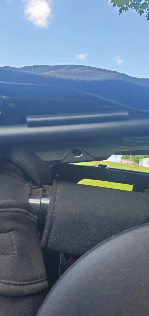

I think I have a picture, I'll post it and see if it helps at all.
I think it's supposed to be a bracket on each side with removable pins that attach in those holes.

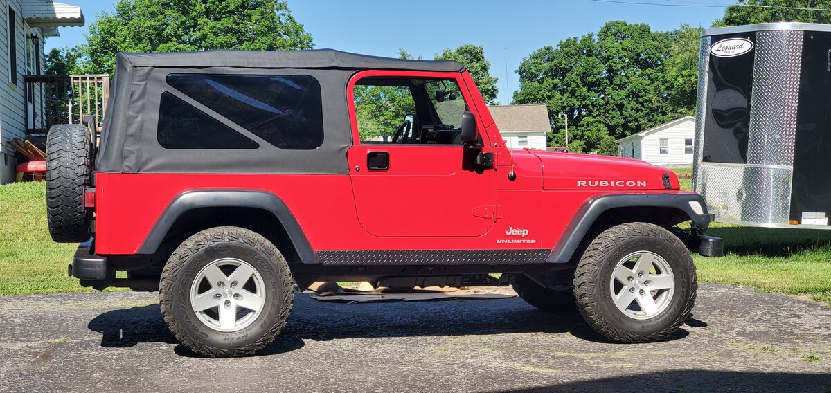

Anyway, here's Big Red with the factory soft top.

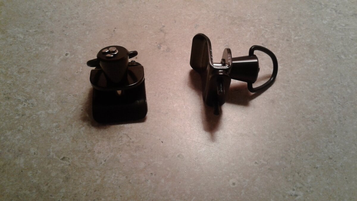

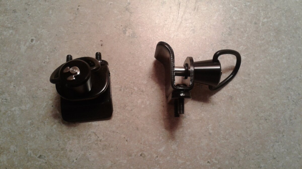

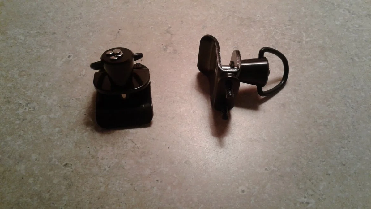

Hey @GorillaBiscuit, I may have the solution if you don't find those brackets with the pins...
When I bought my Rubicon back in 2016, it had the oem soft top still folded up on the bow assembly in the factory sleeve behind the rear seat, never having been put up since new; unfortunately, what was nowhere to be found were the windows, or the door surrounds with hardware...no big deal, I thought, I'll order those from Bestop, which I did. When I received everything from Bestop, and went to install the door surrounds, they had those sunrider spring pivot clips mounted, as their current TJ door surrounds can be used for sunrider or non-sunrider oem or Bestop soft tops. My 2004 did not have a sunrider top, so I removed those clips and threw them in a box 4 years ago. I was cleaning out the shed the other day, selling off the last of my leftover Jeep parts, and discovered those two brackets. I thought I might have tossed them, as I would never need them.
Anyway, I came across your thread, then went out to look in my workshed, and found them in a box...
I think they are what you might need (see photos below), and if so they're yours for the cost of postage. Let me know.
If they are what you need, it beats contacting Bestop...no telling if they sell those (though it would be interesting to know), or if they do, what they might charge...

SOLD!!! 😁😁😁
Oh that's wonderful!! I thought for sure it was going to be a lost cause trying to find those things!
Is there supposed to be another bow that those attach to, or do they just screw into the door surrounds?

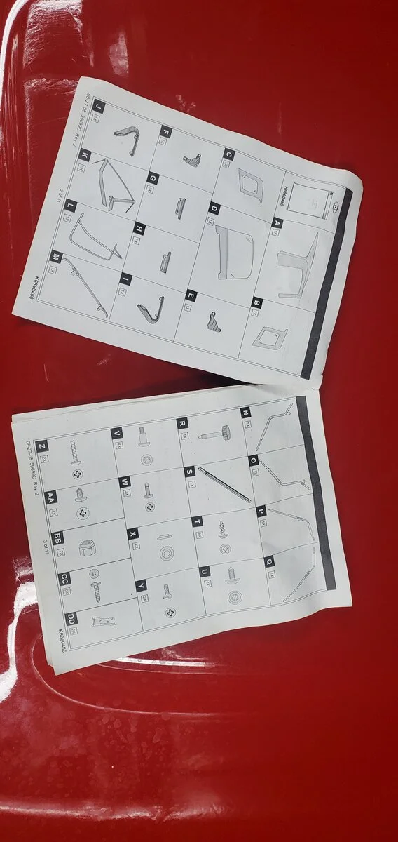

Here's the funny thing, I got the instructions out looking for a picture of the parts I needed, and those brackets are not on the parts list at all!
Here's the parts list in the instruction manual, I don't see those brackets anywhere.

They weren't listed as a separate part when I got my BT door surrounds, as they were installed on the surrounds when I got them. I only removed them as they were sort of in the way of my bow assembly, and were not needed. I believe the two screws on each bracket (hard to see in my photo) go through the two small holes in your first photo, and screw into a small plate on the other side. The small plates & screws are on the two brackets I have.
The only thing I don't know is if the Bestop sunrider bow assembly and the oem factory sunrider bow assembly are the same, and use the same bracket in the same location, or if the unlimited bow assembly is different (besides being longer in the back), as mine was on a 2-door. Maybe @Jerry Bransford can verify if his brackets are the same as mine...

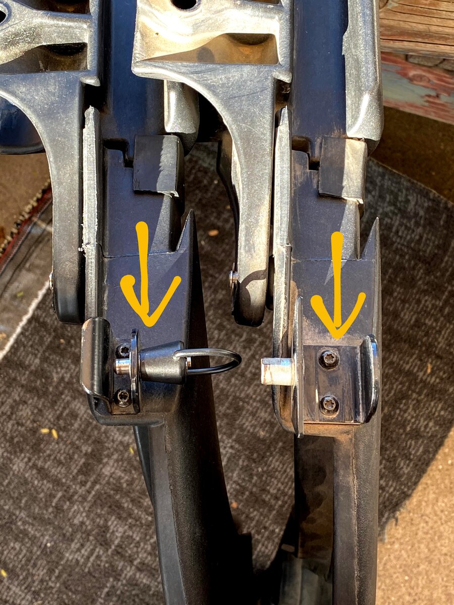

I've come across two different sunrider clips. The clip design below on the right came with my LJ when I bought it last year. It's supposed to have the pin, but it fell off. The soft top bracket it connects to is a bigger block. My soft top is in storage, but the block can be seen here in this post by @FadeToGray.
To the left is a door surround that came with an entire Mopar soft top kit I purchased from someone. As can be seen, the clip is designed to grab onto a much narrower bracket on the soft top, like the bracket shown in the first picture by @GorillaBiscuit.
I'm guessing Jeep/Bestop must have changed designs sometime during LJ production

The clips I have are just like the left hand clip in the photo, narrower.
I'm guessing I will need the narrow type clips since the tabs that I have are thin. Hopefully that's going to be the one. I feel fairly confident. Lol!
