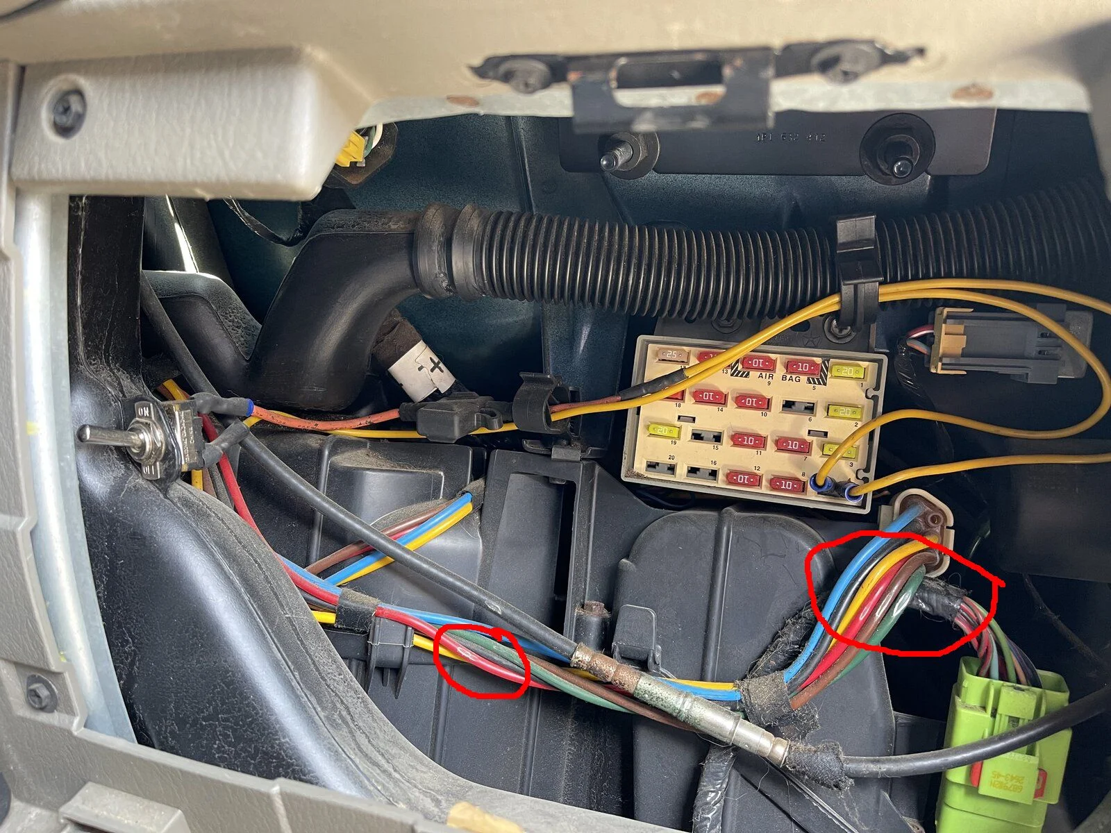

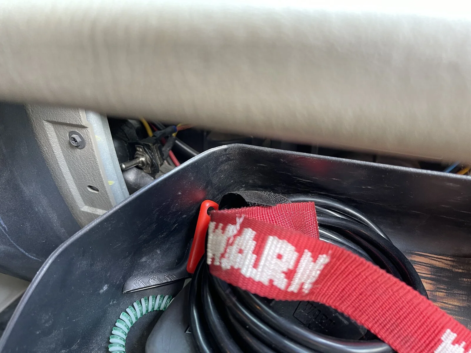

I wired up my own homemade harness to an extra factory fog switch which was easy to get to in the OEM spot under the radio, but I realized I used it so infrequently I decided to use the spot for something else instead and put it back in the glovebox.

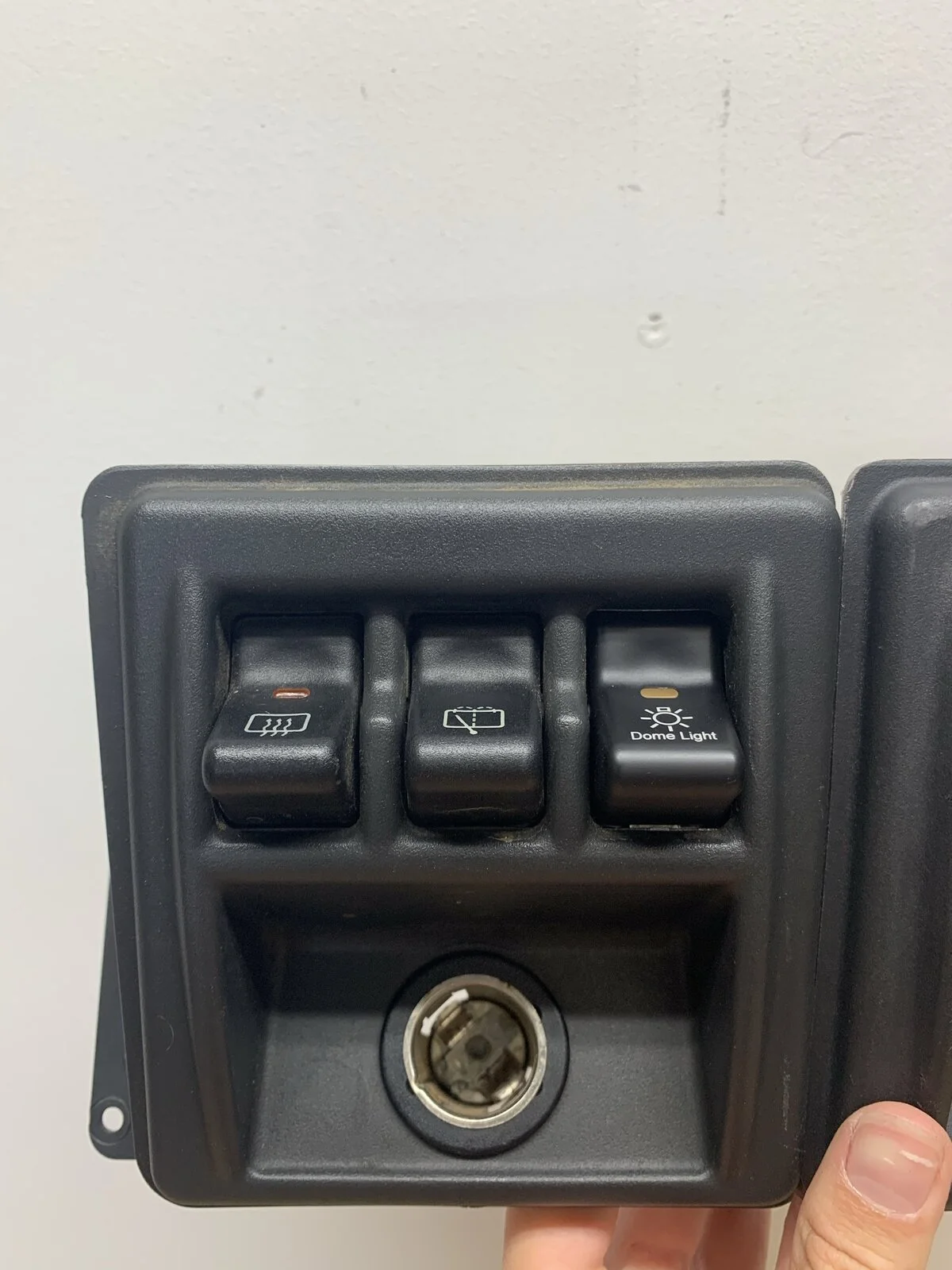

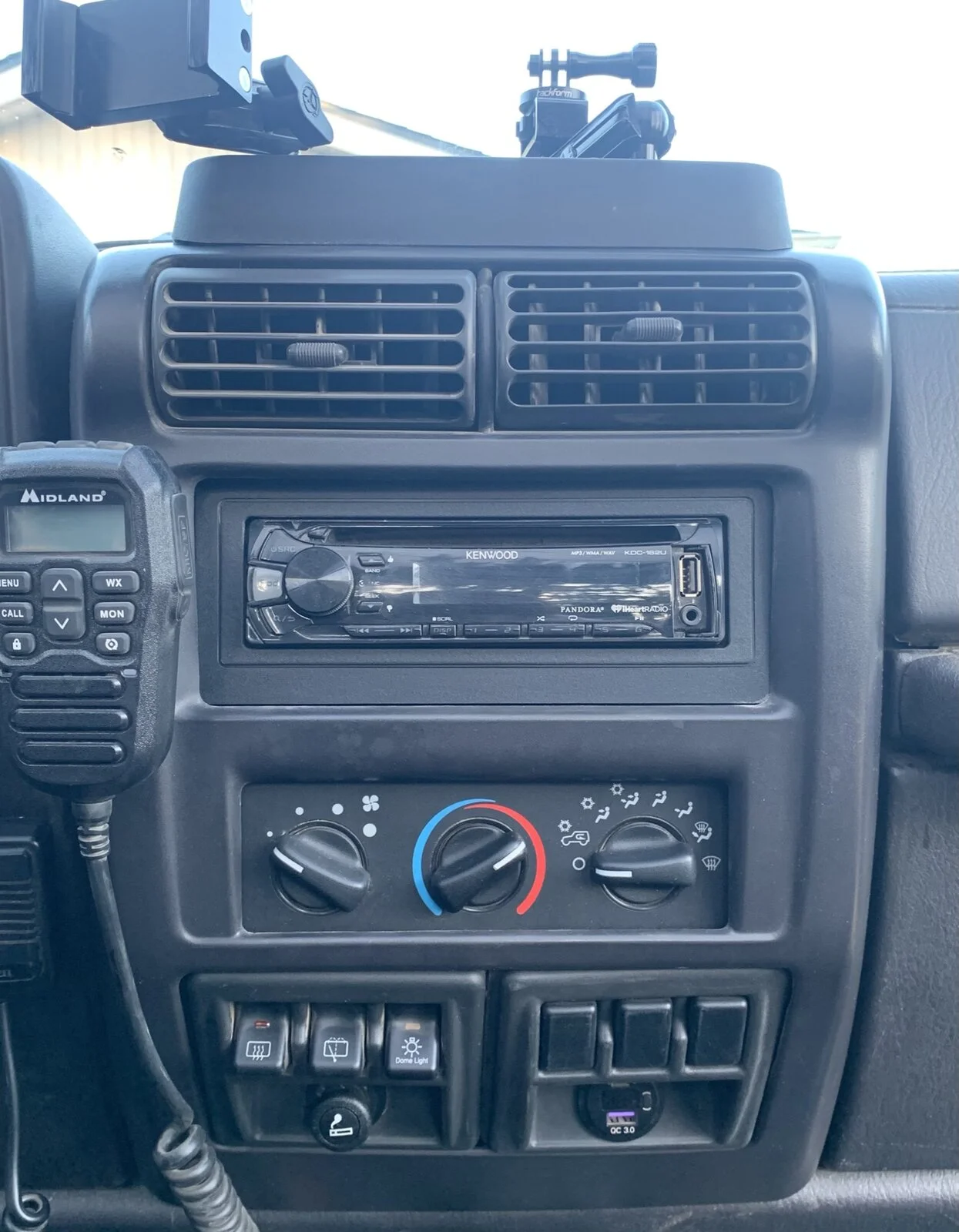

I wanted it to match the other factory switches, so i got a factory looking dome light switch, wire it up with an inline fuse into the fuse slot that the fuse for the door switch is, and that’s it. Works great

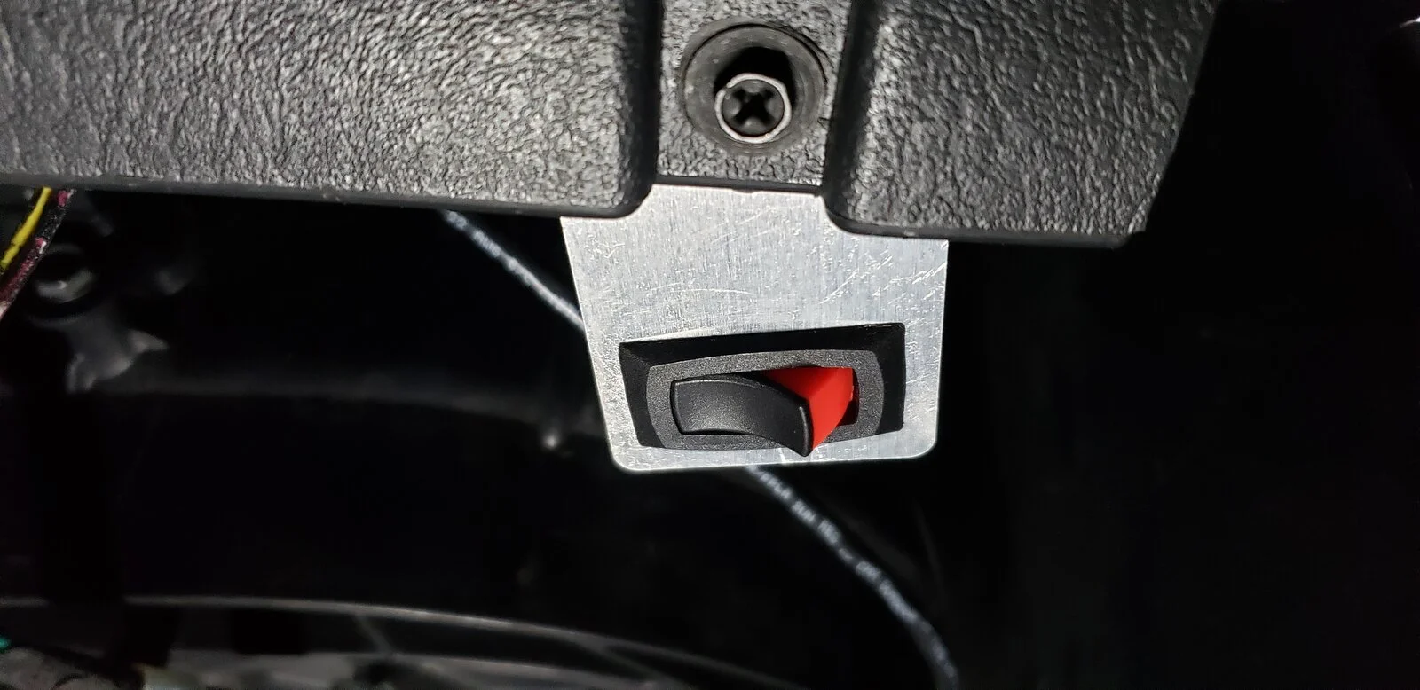

I too did the wiring to the fuse holder and installed a micro rocker switch on the side lip of the glove box opening and is visible when you open the glove box door.

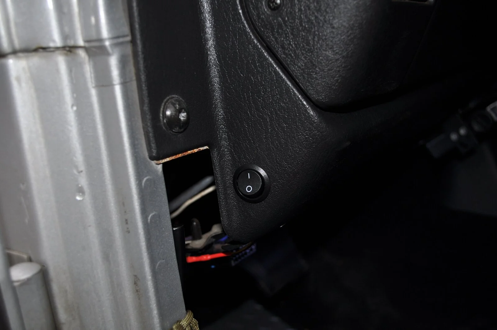

I installed one switch per side on the ends of the dashboard as shown here on the driver's side. I cut one of the door light switch wires and spliced in the switch.
