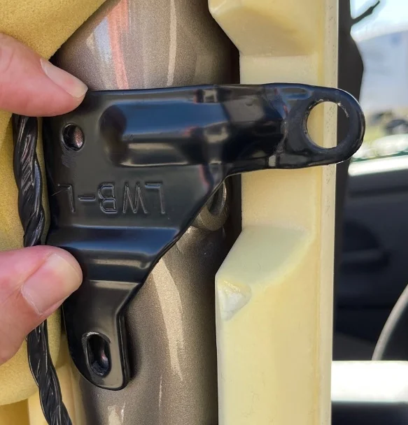

I think my Jeep was sold with just the Hard Top and I don't think it was ever removed (Until Today)
So the holes in the Jeep don't appear to be threaded. Or the threads are filled with paint.
Are the screws for the Pivot Brackets designed to cut threads?
I assume the brackets go on the outside of the roll bar. Nice of Jeep to write the part description upside down on the driver side.
Yes, they are self-tapping. I got all 4 of them in pretty easily.
I guess they might be called 'disruption' tappers. I found this post.
