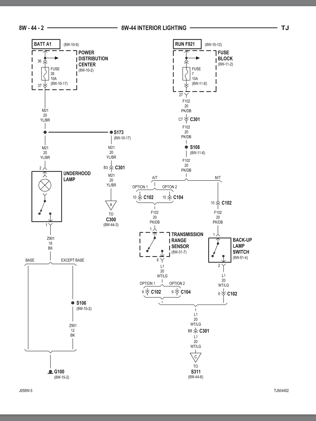

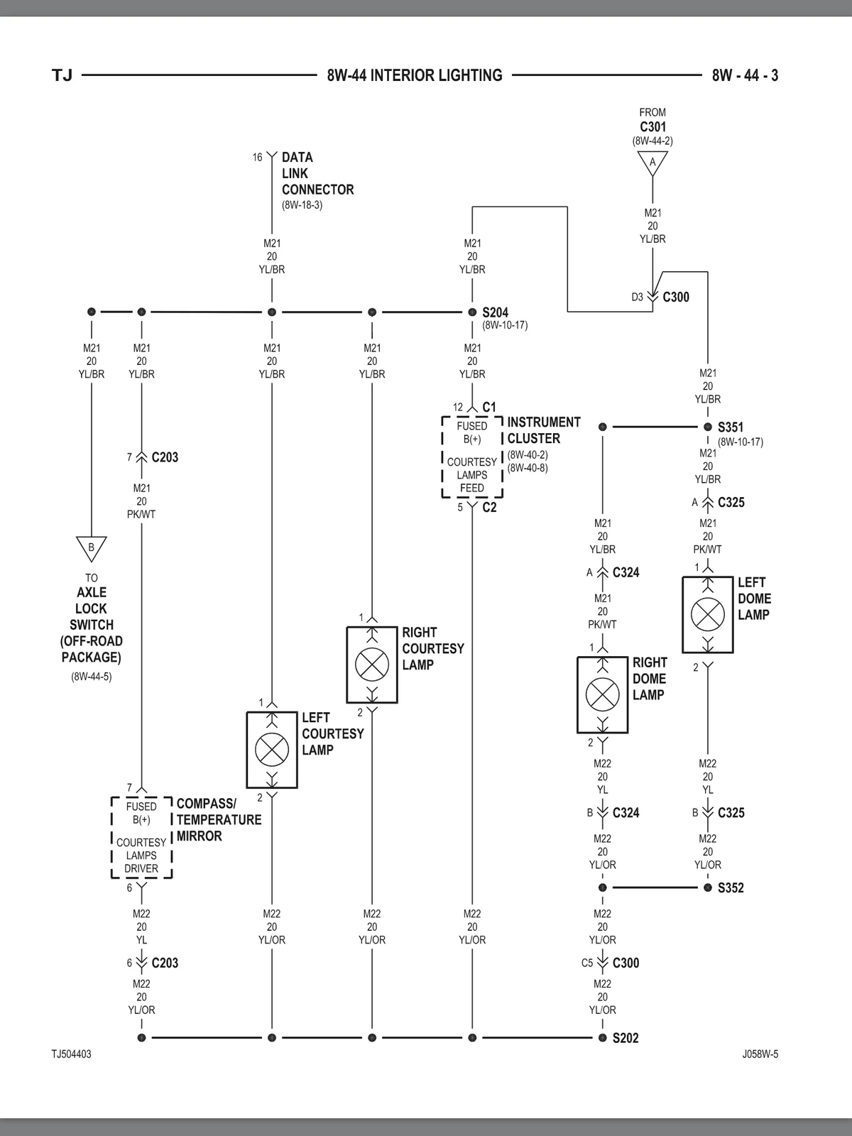

03 Wrangler Rubi - this morning I replaced my headlights with replacement halogens and now my interior lights won’t turn off. I’ve checked the turn signal switch stalk and no matter what position, the lights stay on. Both doors are closed and I know the door switches are good because the driver door, when opened, activates the mileage screen so that tells me it’s “ok” and the passenger side, when opened, will beep twice if the ignition is on so I assume it’s also ”ok”. I’ve looked at This thread and this thread and ran through what’s recommended in those: I’ve pulled the #4 fuse and the lights stay on. When I pull the IOD fuse under the hood, the lights go off. I pulled the battery for 30ish minutes and reconnected and the lights immediately came back on. I am at a loss here. Anyone have any other suggestions for troubleshooting?

Just fixed the issue a few minutes ago. When replacing the headlights, I had to replace the driver side headlight housing because the vertical adjustment was broken. When replacing that housing, I mistakenly pinched the wire for the hood light switch in-between that housing and the body of the Jeep. When I pulled the headlight out to check my work for the millionth time, I finally noticed it. When I pulled the new housing, I noticed that wire was bare - hence the issue. Pulled that bare wire away from the body and bam, problem solved. What a... learning experience. Thanks for all the suggestions!!
