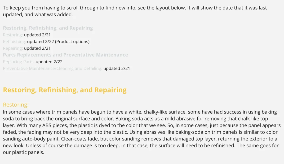

This thread is for all things related to the maintaining, repairing, restoring, cleaning, and parts replacing of our TJ's door and trim panels, consoles, carpet, seat covers, roll bar covers, etc. Hopefully a one-stop thread for many questions that come up. I know there are some things related to sections here that are floating out there in the forum. I've found some and shared their links in the related section, but I'm guessing I haven't found them all. If you have, or know of any that aren't linked here, share the link.
To keep you from having to scroll through to find new info, see the layout below. It will show the date that it was last updated, and what was added.
Restoring, Refinishing, and Repairing
Restoring: updated 2/21 new
Refinishing: updated 4/5 Two-tone color codes, Member projects
Repairing: updated 2/23 new

Restoring:

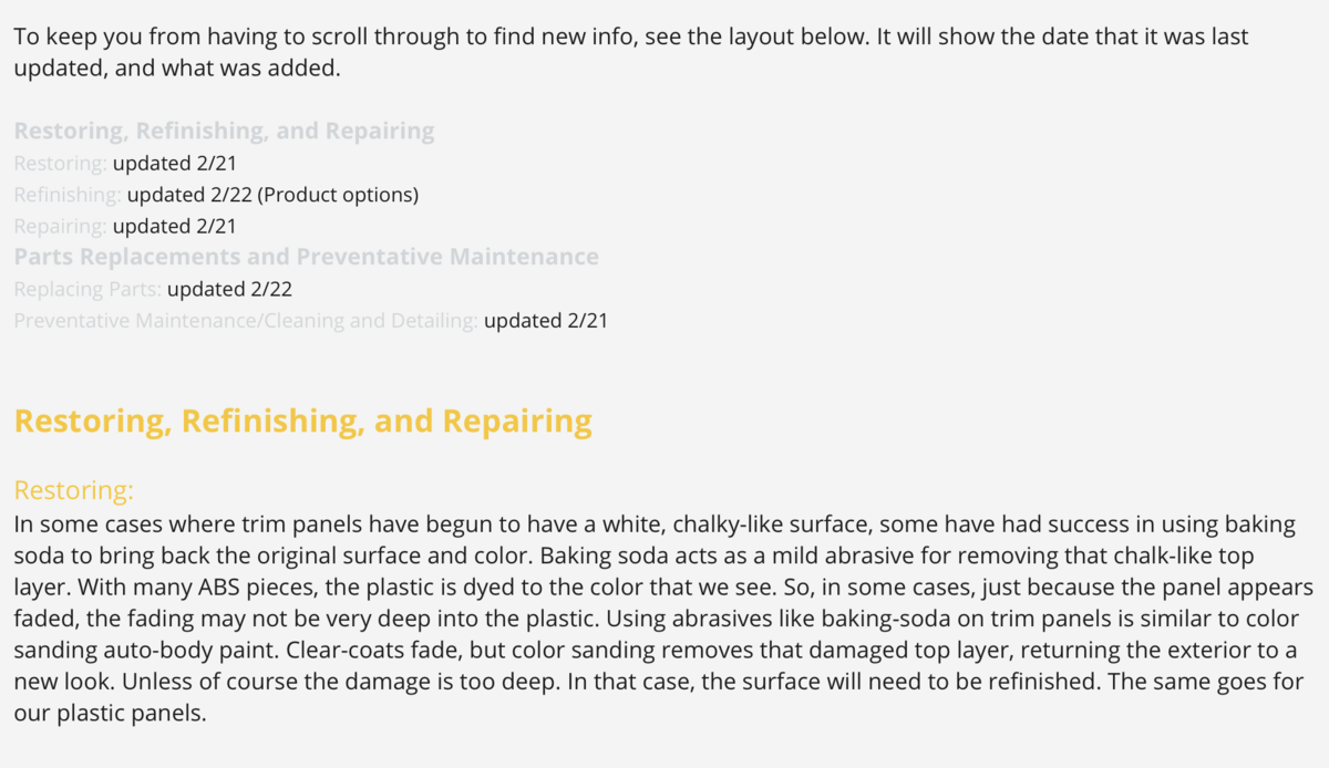

In some cases where trim panels have begun to have a white, chalky-like surface, some have had success in using baking soda to bring back the original surface and color. Baking soda acts as a mild abrasive for removing that chalk-like top layer. With many ABS pieces, the plastic is dyed to the color that we see. So, in some cases, just because the panel appears faded, the fading may not be very deep into the plastic. Using abrasives like baking-soda on trim panels is similar to color sanding auto-body paint. Clear-coats fade, but color sanding removes that damaged top layer, returning the exterior to a new look. Unless of course the damage is too deep. In that case, the surface will need to be refinished. The same goes for our plastic panels.
Watch the video below to see how this guy's TJ dash turned out. Night and day difference!

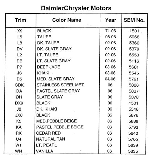

As for the SEM Products brand, for some of the older colors codes of our Jeeps, visit their Classic Coat products. For all others, go to their Color Coat products. If you don't know the color code for your TJ, you can look your Jeep's label to get the code. The label should be located in the driver's door jamb.

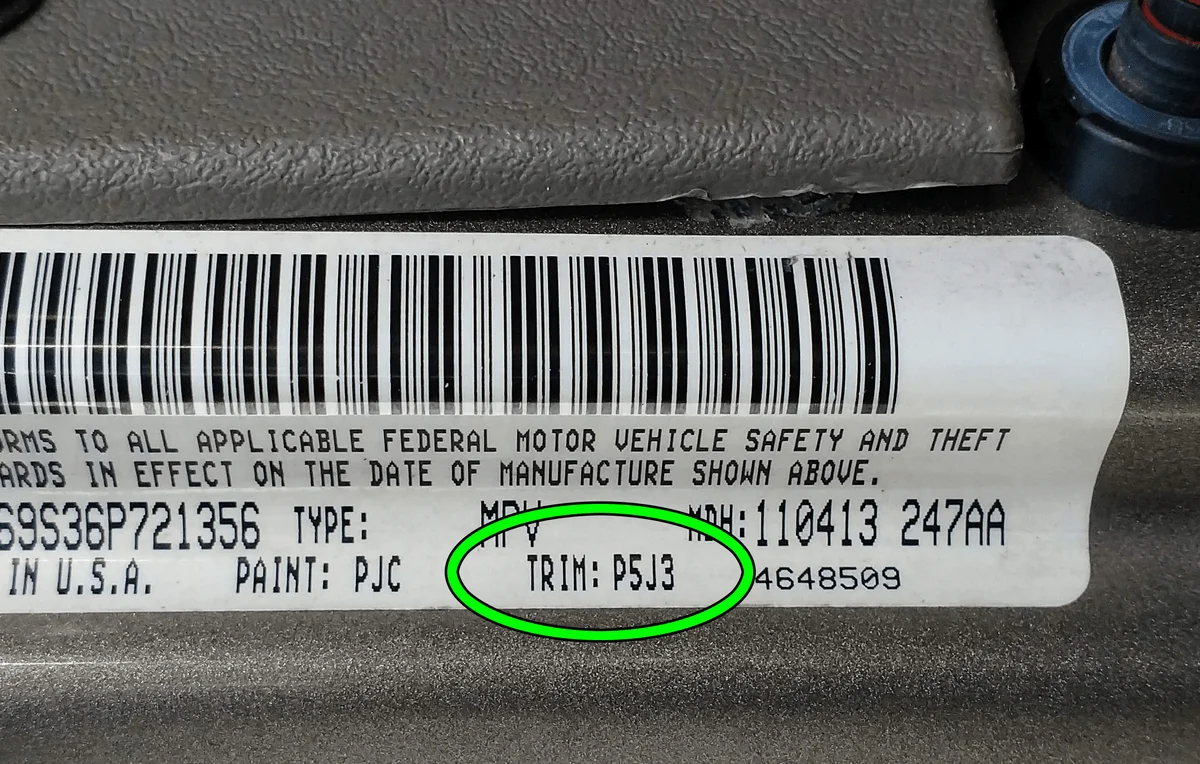

Here's a picture of mine as an example:
In this example, my trim color code is J3.

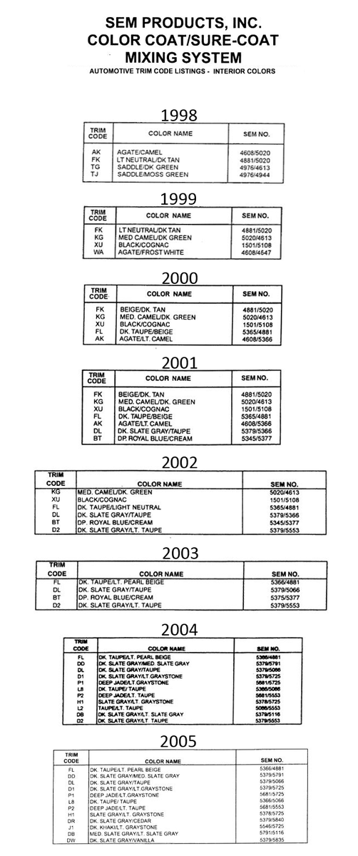

You can also visit AutoColorLibrary to help you pinpoint your code, as well as other interesting data on OE colors used around your Jeep. Note that, unless specified, the colors shown in their library are colors used by Chrysler, on other models of that year.
If you are still having troubles in finding the specific color that you need or want, visit the "Formulas" section on the SEM Products website. From there, you can either choose to see codes by year or see color cards. On that same page, you can select to download the formulas themselves. That can be taken to a site that does custom mixing.

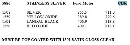

Example from Formulas download. Search PDF file for key words if needed.
Side Note:
Don't trust the color seen on the cap. I spoke with one of the guys at SEM Products who advised to not rely to heavily on the color of the cap. Reason being is that the caps are sourced out to another company, so the colors that are infused into the cap's plastic is only their best effort at matching the request from SEM Products.

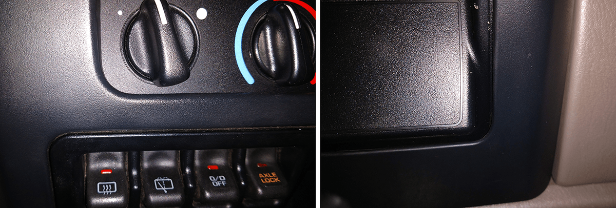

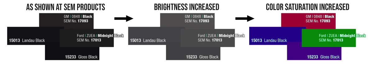

My personal observation of Landau Black:
I know that Landau Black was used by Chrysler, but I can't recall the info showing when and where they used it. I believe that it was used for the "black" trim bezels in some (or all?) of our TJs. Here are a couple of images showing the color and why I believe that it was used for that purpose.
Judging a color by looking at it on a monitor is always a bad idea. Most especially when the color is represented by another site or company. I kept that in mind and pulled these three different versions of black from the website for SEM Products, then adjusted the saturation to bring out the colors that aren't always easy to see. Landau isn't quite as dark as the other blacks, so it tends to show it's blue undertones in brighter lighting. It also doesn't have the red undertones that other blacks have either.
Here is a close-up of my center dash bezel. With the bright light on it, a clear difference can be seen between the black color of the bezel and the black color of the controls.

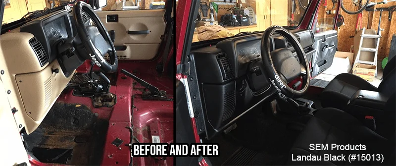

One more. Here's a picture I came across that shows an entire color change that someone did, using Landau Black.
In some projects that I've done, I've sprayed parts black, but the black turned out to be too black. I think the Landau looks really good in there, even with it being sprayed everywhere.
More details on Black colors used by Chrysler: See page 4

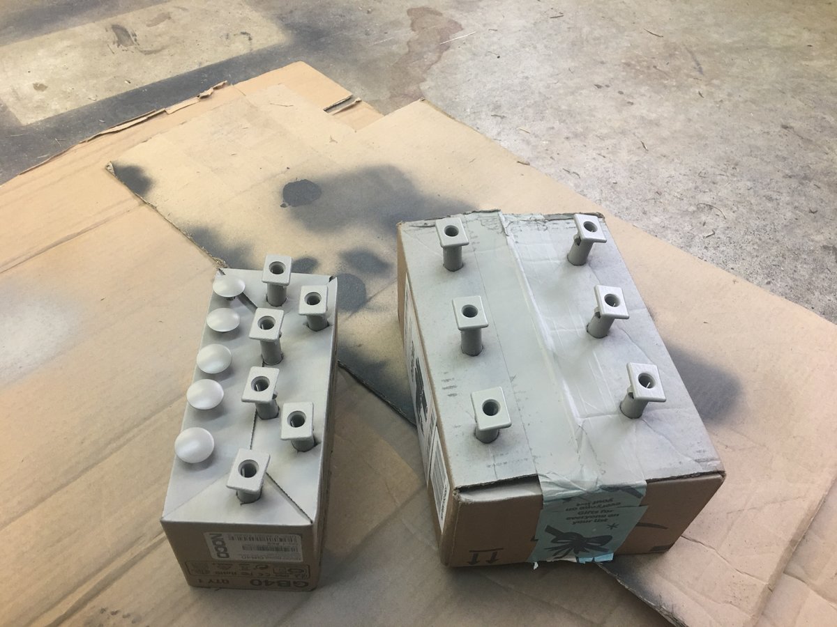

1. Thorough prep work for painting plastics is critical! When you think you have prepped enough, just do it again. It's better to put in a little extra prep work now to prevent poorly bonded paint. The time spent prepping will seem like a walk in the park when everything begins to have flaking paint.
2. Clean the surfaces using a rag, using warm (if possible) water and dawn dish soap. It wouldn't hurt to go back over the entire panel with soap and water, but this time using a soft to medium bristled scrub brush. No metal bristles. Nylon bristles.
3. Repeat the same as above, only this time use a fine grit scotch-brite pad. Those that are blue in color and sold for general purpose household cleaning will work, or you can go to Home Depot or Lowe's and pick up the grey pads. The grey pads at those places will have a label, from fine to course. For this you will want the fine grit. Be very thorough when going over the panel, covering every inch, and getting into all of the corners and tight places.
4. Let the piece/s dry, then use your choice of (safe) degreaser to wipe the piece down, using a microfiber towel, or blue shop towels. We're looking for something that won't leave "lint" or fibers behind. I have used both Windex(with Ammonia), and Isopropyl Alcohol and had good results. Just no harsh chemicals that will damage the plastic. Be cautious with touching the surfaces with bare hands, so you don't leave any oily prints behind. Probably not a bad idea to throw on some latex or nitrile gloves.
5. If you have access to compressed air, this would be a good time to make sure there are no hidden puddles of water in those tight places. Place the panel in the area you plan to spray, making sure it's at a level that you can easily spray without difficulty. This is a personal preference, but it isn't completely necessary. At this stage, I like to use tack cloths to wipe down the piece before spraying, to remove any lint, cloth fibers, hairs, etc.. Even if there is something left behind, with this paint being as thin as it is, and drying as fast as it does, it's amazing what you can easily wipe off before your next coat.
6. Next, it's a good idea to use an adhesion promoter. If no areas are in need of being masked off, go ahead and get both your adhesion promoter and color shaken up and ready. First coat will be the adhesion promoter. Adhesion promoters and their drying time are different, so follow the instructions on the can. When you're making passes with your color coat, make light coats. SEM paint isn't heavy, so going fast isn't necessary. Just make sure that each pass is putting down a light coat. Follow the instructions on dry time, then return with more light coats. Repeat until you are content with the results.

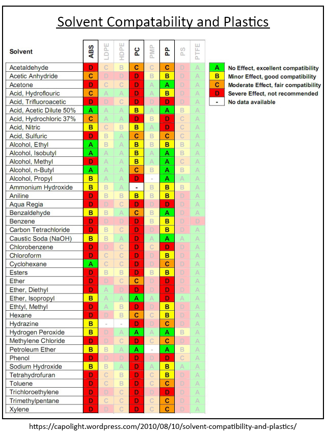

Note on chemicals and plastics:
Here's a helpful chart that can be of use prior to repairing plastics, or prior to prepping plastics for paint. In the case of cleaning or prepping for paint, taking note of how a specific chemical's effect can prevent unnecessary damage. When doing repairs, this can also be of use. As I mention later, you can make these "severe effects" work in your favor.
Since ABS, PP, and PC are the plastics that we will be dealing with, I have modified the chart a little, so as to make it better suit the thread's purpose and make it easier to read through.
Click the image to enlarge

J3/ZJ3
- Khaki (2003-2006):
- SEM Products #5545 (Must be custom mixed). Thread Page: 3
- SEM 15833 is commonly referred by sales reps. for our TJ, but this color is not correct. 15833 was a 2008 color.
DV - Dark Slate (2002-2006):
- SEM Products #17373. Thread Page: 3

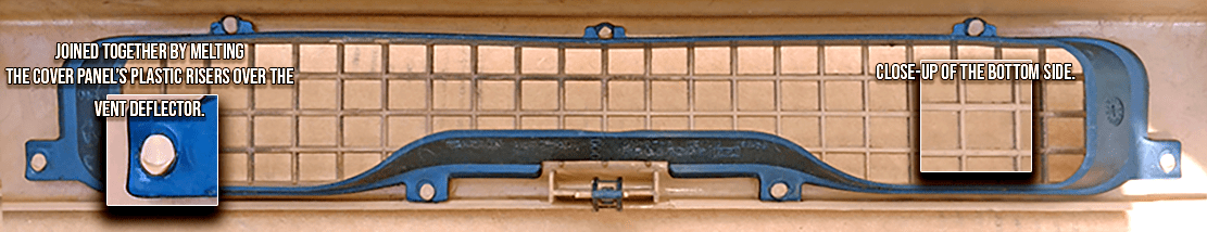

As of now, I know of two parts that are notorious for problems. The crash pad and the door panels. The crash pad/defrost vent cover in our TJs becomes very brittle with age. Once the plastic reaches a certain level of brittle, one tap from a finger on the vent guard "bars" and they break. There are several ways to tackle the fragile defrost vent problem. You'll just need to choose what material, plastic or metal.
Here are some ideas and/or options used by others:
Metal Rain Gutter Guard at Home Depot or Lowe's
PVC Coated Plastic Chicken Wire Mesh on Amazon or other online sources.
Expanded Metal at McMaster-Carr Supply, or simply search online for Expanded Metal.
Wire Cloth at McMaster-Carr Supply, or again, just search online for Wire Cloth.
Depending on the severity of your broken vent guard, you may be able to get away with adding some structuring on the bottom side of each plastic "bar" by using some type of adhesive, like Epoxy. That can be found in easy to use syringes at any hardware store. You can also use a combination of metal rod or solid core wire secured to the underside of the grill pieces using Epoxy. Considering this method for your repair means that you are one of the lucky few that still have the majority of your vent guard remaining.
If you haven't seen it yet, here's the underside of the crash pad:
Like many, if not all of the interior plastic panels, the crash pad is made up from ABS plastic. On the positive side of this, ABS is really easy to work with.
You can use a heat source for removing the vent deflector from the underside, as well as for bonding your new guard onto the trim panel. Using a "plastic welding kit" will be the least destructive method for removing the vent deflector, because it retains the material to be used later, unlike cutting or grinding. The same goes for reinstalling the deflector. If that type of tool is used, you can reheat and shape the retained plastic to better secure the deflector into place. You can purchase a plastic welding kit at most hardware stores. They are essentially just a soldering iron that has removable tips that are designed for cutting, shaping, and bonding plastics. If you're careful, using a small butane torch for your heat source, along with something like a flat-heat screwdriver to achieve similar (if not identical) results.
Adhesives can also be used, like the epoxy mentioned earlier. Again, epoxy for bonding plastics can be purchased at any hardware store, among other places. Since we're working with ABS, it won't require any specific or uncommon off-the-shelf epoxy. Another adhesive that I like to use for nearly any project is Cyanoacrylate, aka CA Glue, or Super Glue. The best way to use CA glue, IMO is to use the two-part method, which requires the adhesive to be sprayed with an activator before it will harden. Something like this kit on Amazon. Using this method not only helps control the drying situation, but it causes the glue to harden in less than 2 seconds. Best of all, this method prevents your plastic from being stained by the fumes of slow-curing CA glue, leaving a small to very large white power looking haze on the plastic. An alternative to the two-part CA glue involves baking soda, again. If you choose to go with common CA/Super Glue instead of the two-part method, you can greatly increase the curing time and prevent the staining white haze, just grab up a little baking soda between your fingers and sprinkle it over the glue. The downside to this is, when the glue cures, it has very rough, rock-like feel. Not a huge problem though, just sand it down if needed.

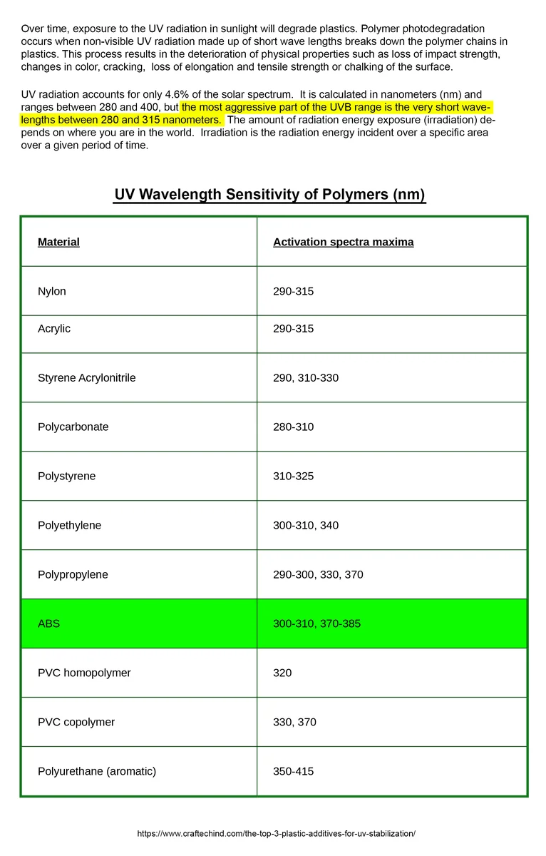

In my opinion, our plastic trim pieces require the most attention when it comes to preventative maintenance. With these parts being constructed from ABS, their continuous exposure to the elements makes their deterioration inevitable. When these plastics aren't routinely cleaned, those surface contaminants can act as catalysts for excited deterioration of the plastic. Basically, these interior plastics deteriorate fast enough as it is. Not routinely cleaning them only makes that worse.
The sensitivity of polymers to UV radiation:
(Click the thumbnail to view the full image)

Anybody happen to have the paint code used for the silver dash panels on a 2006 LJ. I got close with a duplicolor but it’s not quite right.
I have all of the files still up. I seem to remember seeing it somewhere. I'll look and see if I can find it.
Not sure if I’m reading it right but I see what I think is the door code but I don’t see that silver color of the dash anywhere.
I looked back at that page and I wasn't seeing anything either. I'm looking one now that I'm wondering about.
CDK Stainless Steel Metallic (Only used in 2006)
I searched the SEM Formula Sheet for CDK, but it only came up with one, and it was for a Ford. Oddly enough, it does have "stainless" in the name.
that could be it, the Ford part is confusing though.

Dang... great job on this how-to thread so far, I'm impressed!
This is one of those threads I didn't know we needed, but now that I look at it, it's obvious we do need it. Tons of great info here!
I don't see a video link, but I'm assuming you're still working on / editing the original post.
Reactions: JMT and bedhed
Yeah it is. Maybe that color will be closer. I struggled with locating any info on that color in yours. The closest thing I found was useless really. In a spec list, it said "Metal-like Trim Color". 😑 thanks
Thanks! I don't think many of us have thought a whole lot about it. They're getting up in age though! I've got to get my ass in gear and fix my door cracks and dash myself. I've been procrastinating.
Do you mean the baking soda video? That's the only video that's in there so far. Anyway, the link is imbedded in the wording. I'll make a note above it.
Yes, I fixed it for you.
Instead of making a hyperlink to the video, just copy and paste the video link below the text (see what I did above).
That way it embeds the video directly on the page, so someone doesn't have to click out of the site. Make sense?
Either way, keep up the good work, this is a great idea for a thread.
Reactions: bedhed

For reference, the SEM paint for Khaki J3 interior is SEM Color Coat 15833.
https://www.amazon.com/gp/product/B00B3HXUIS/?tag=wranglerorg-20
I’ve painted a few small pieces like the push in plugs for half doors and the grommets In the top of the door for the soft upper frames and the color matches my full door khaki panels really well. I still need to paint my panels though.
Reactions: zebra12 and bedhed
How well did the match up for you? I ordered some a few months ago, but haven't gotten to my project yet.
You're killing me with the yellow and grey / white text. I can't even read it at all on my screen :ROFLMAO:
You're a designer... you should know better ;)
Reactions: bedhed
:ROFLMAO: Damn. Now that was funny! For what it's worth, that AND the all white route have been bugging the hell out of me. I have no doubt that you'll come back and see different colors at random times lol.
All black text is the way to go. In fact, one of my biggest pet peeves in the web design world is when people use any other color than black text for body type (unless it's on print work).
On the dark theme I'm sure it shows up, but on the standard site theme, you can't read that text at all without running your cursor over it.

I don't recall the use of adhesion promoter or UV protection in paint in your write up. If you did my apologies. I used adhesion promoter on my flares. And several other parts on the interior. It's highly recommended by several advanced painters and SEM themselves. Possibly other manufacturers. Also SEM comes in different versions. And only some of their paints are UV protective. I'm sorry I don't recall which ones. This would hold useful for almost all the interior plastic as it all gets sun damaged. At least along the top of the dash and door panels. I think there is a clear coat range of SEM products that contain UV protection. So you can also do a flat or satin clear coat over whatever you paint. And most suggest doing so anyway.
