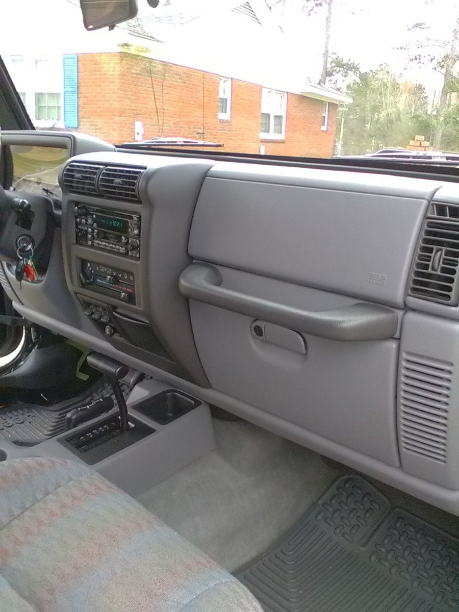

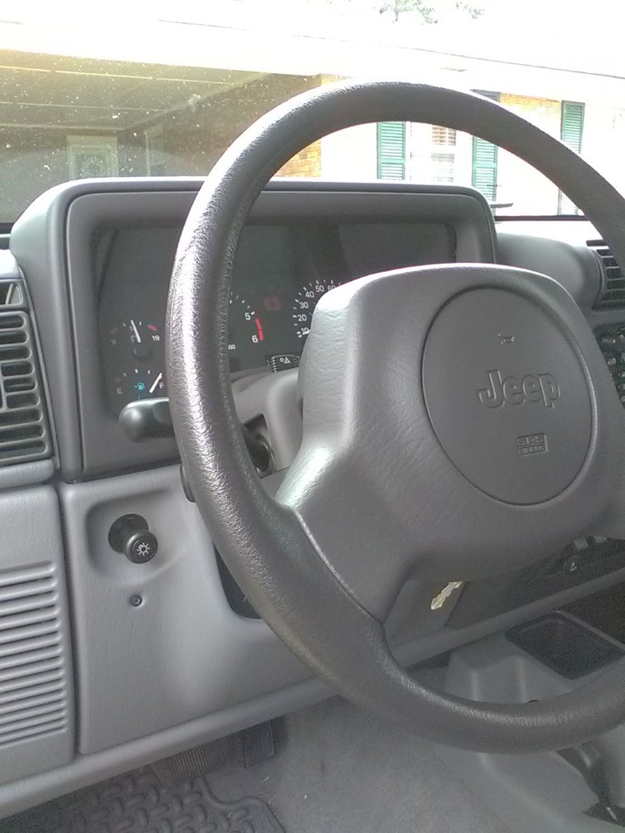

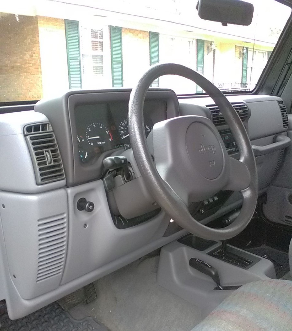

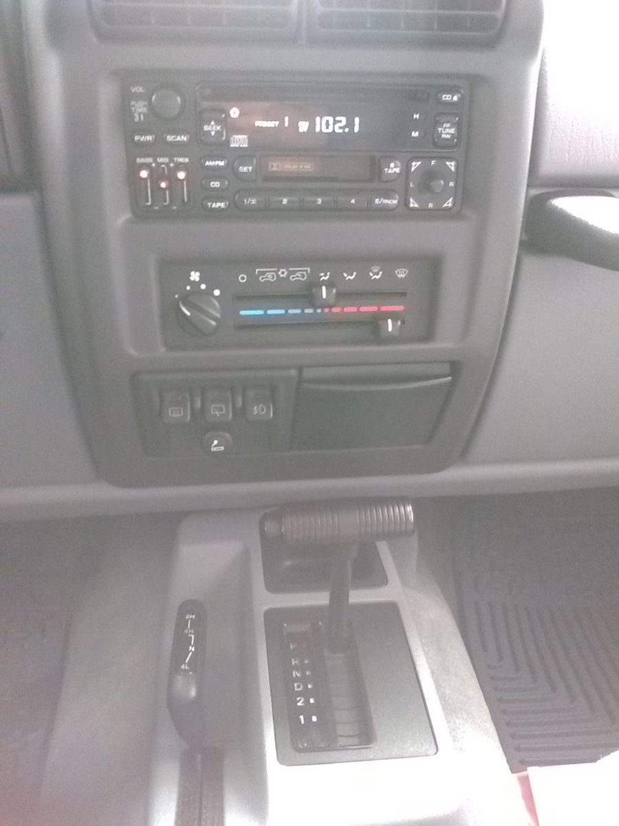

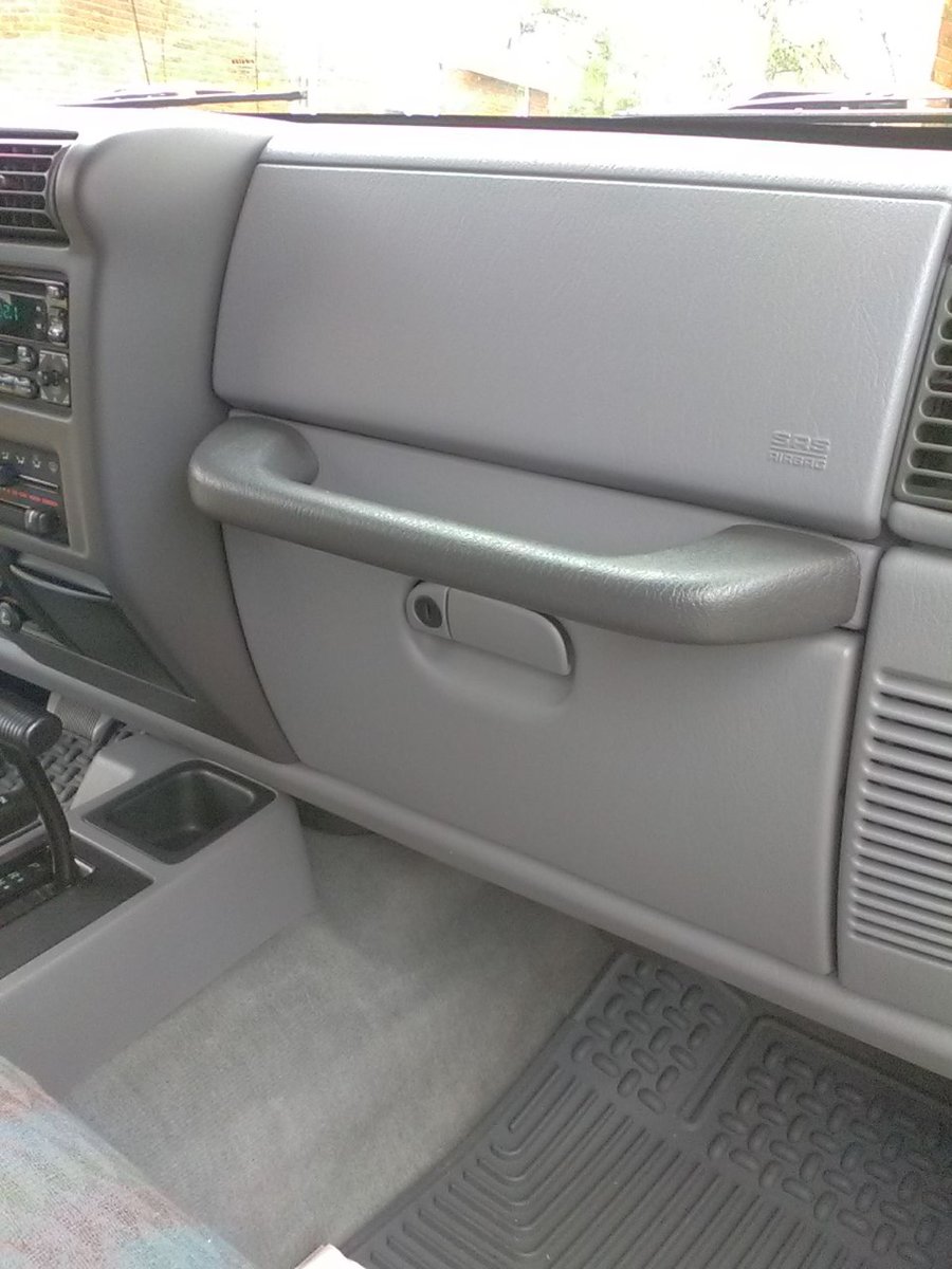

As promised, here are a few pictures of my interior I took this morning. Except for the steering wheel rim and the dash vents, the interior dash pieces were all removed and re-painted in either Mist Gray or Agate. You can see how well the Agate matches to the pieces I left original. The steering wheel rim is made out of a different type of rubber for safety reasons, and it always had a higher gloss, which is why I left is alone. I purchased the paint from my local PPG store:
(And yes, that auto transmision handle grip came from an earlier 1988 - 1996 Jeep Cherokee XJ. I just like the feel of it better. Other than the ribs, it is *exactly* like the stock 1997 - 2006 Wrangler TJ handle.)
Very nice! I see now why you chose the color that you did, and I feel like I would have done the same thing. I never realized they used that color steering wheel. I bet that did make for an odd color combination before you changed it up. Well done.👍
Thanks, Chief!
I forgot to mention: the ash tray door and the transmission shifter handle were both re-painted in SEM Landau Black. They turned out to be a perfect match for those pieces, which were originally black. You can clearly see how much darker it is compared to Agate.
Very very nice. How long ago did you paint everything?

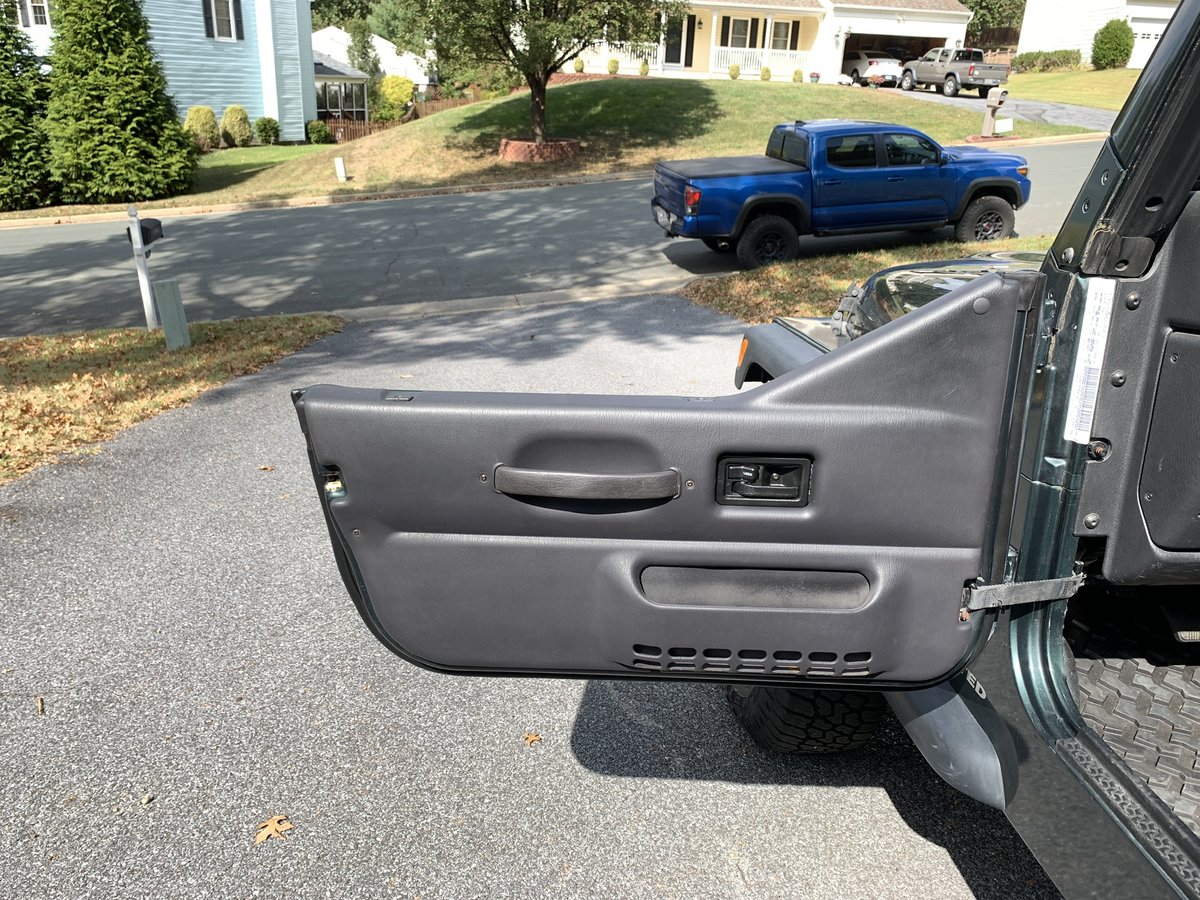

If you want a really good match for the Dark Slate interior, use SEM 17373:
https://www.amazon.com/dp/B00N81YP72/?tag=wranglerorg-20
I painted my half door panels with it and it’s a perfect match to the existing stuff.
That does look spot-on. The dash plastics in the side of the picture, are those the untouched original color?
Thanks, Chief!
That's good to know. Any noticeable wearing of the paint on the shifter, or has it held strong over the years?
The Classic Coat Sem 17373 worked well on door panels? Israel from SEM told me:
"Color Coat is design to work on plastic, vinyl carpet and velour. Classic Coat is only design for vinyl and leather. Plastic is not suitable substrate for Classic Coat. If you are refinishing plastic and vinyl, you would want to use Color Coat for you application."
