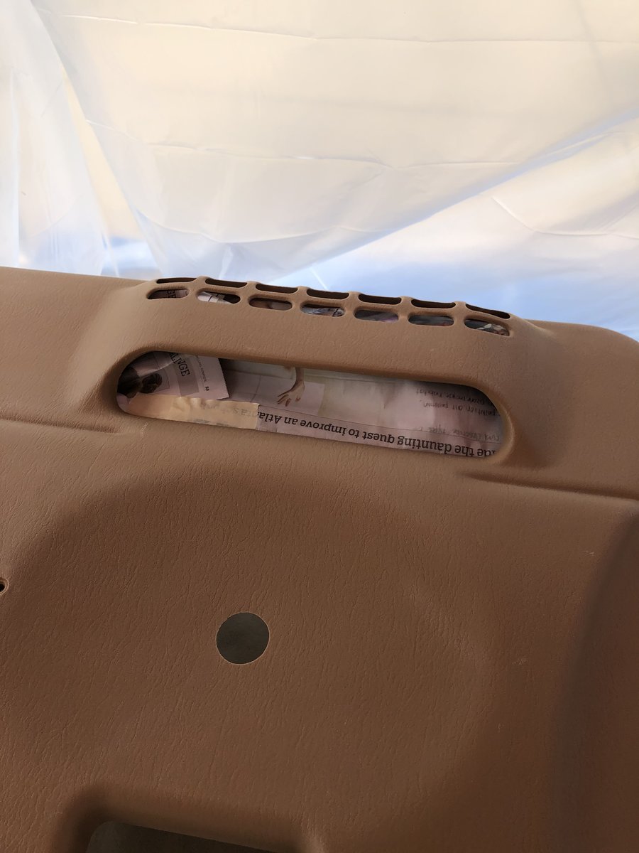

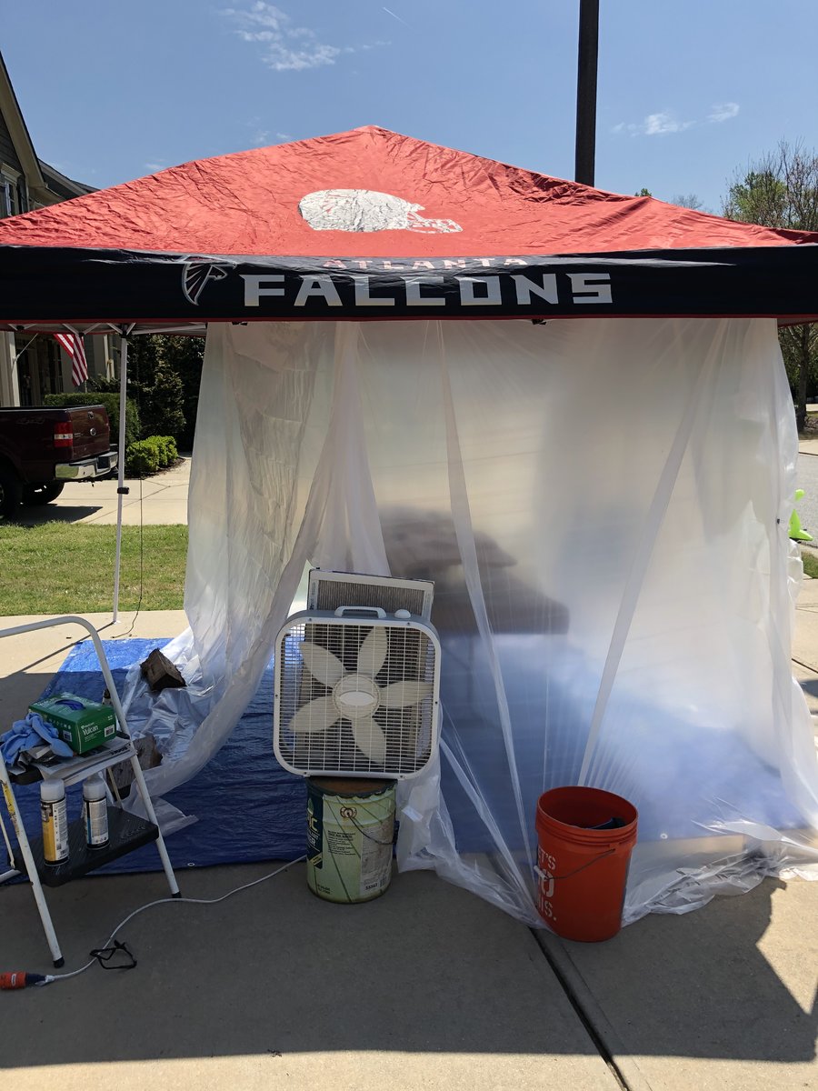

I just finished painting the door panels harvested from my donor 1998 TJ. They were Saddle Tan and now Med Camel Tan to match my 2000 TJ. Most of the time was in the prep.
  1. Clean with SEM Soap #39362 (did twice since these things were nasty dirty)
  2. Clean with SEM Plastic Prep #38353 and clean lint free towel
  3. Prep with the SEM Adhesion Promoter #39863 (one light coat - flash dry, wet coat then started painting w/in 20-minutes)
  4. Several light coats 5-10 minutes flash dry in between coats with SEM color #5020 which is the match for Med. Camel Tan from my year TJ. I did 4 coats going light each time.
  5. Going to let cure for a few days then install on the doors that I'm also refurbishing (new window regulators, and interior+exterior handles)
I'll post after pictures after I get it all put together. I'll probably try and put this project up on the How To as well.

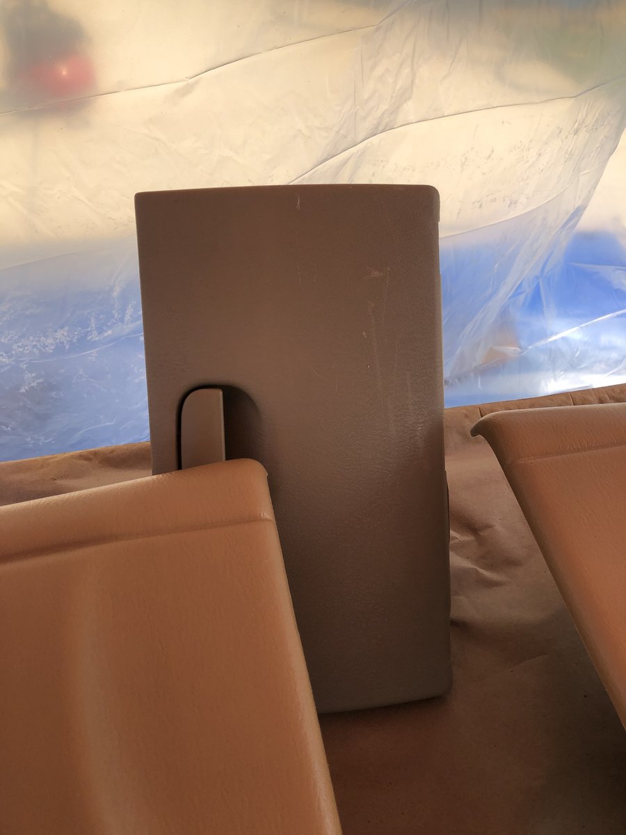

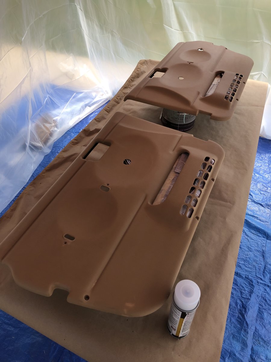

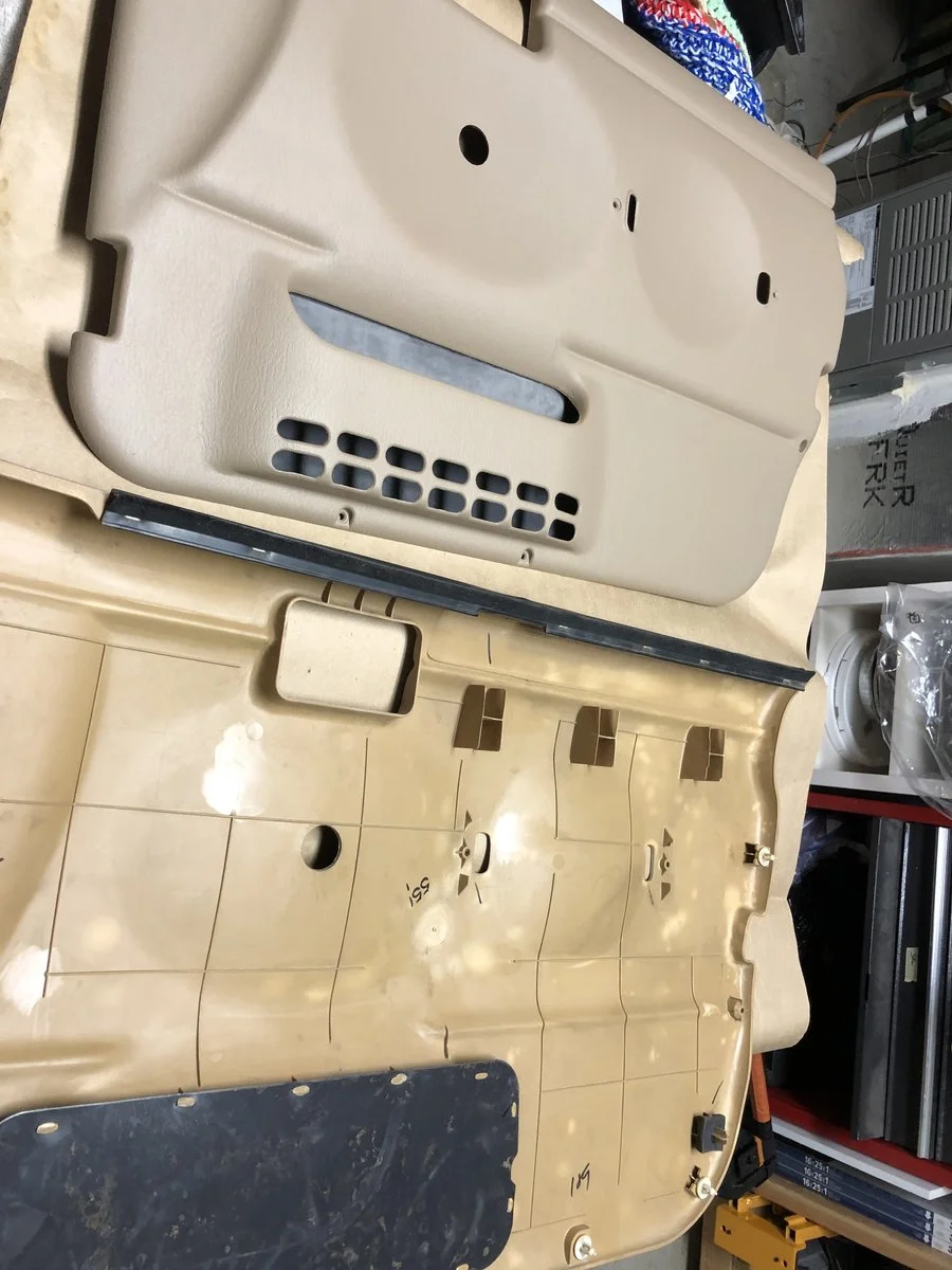

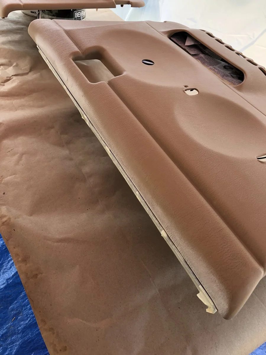

I didn't mean to leave anyone hanging.. Here are the panels in the basement curing for 48-hours. They came out great. The door panels have some abrasions that the paint can't hide but I'm thrilled with the results. $hit.. it's a 20-year old Jeep but again... they look great and the paint covered that ashy white color at the top of the panel better than I expected.
I'm not a patient type of DIY'er but I was today, used all the SEM products and it came out beyond my expectations.
Used just over 1-can for the two panels.
I didn't paint the undersides so the last photo will show the color difference.
Definitely a project you can do on your own.

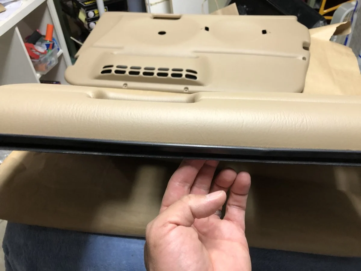

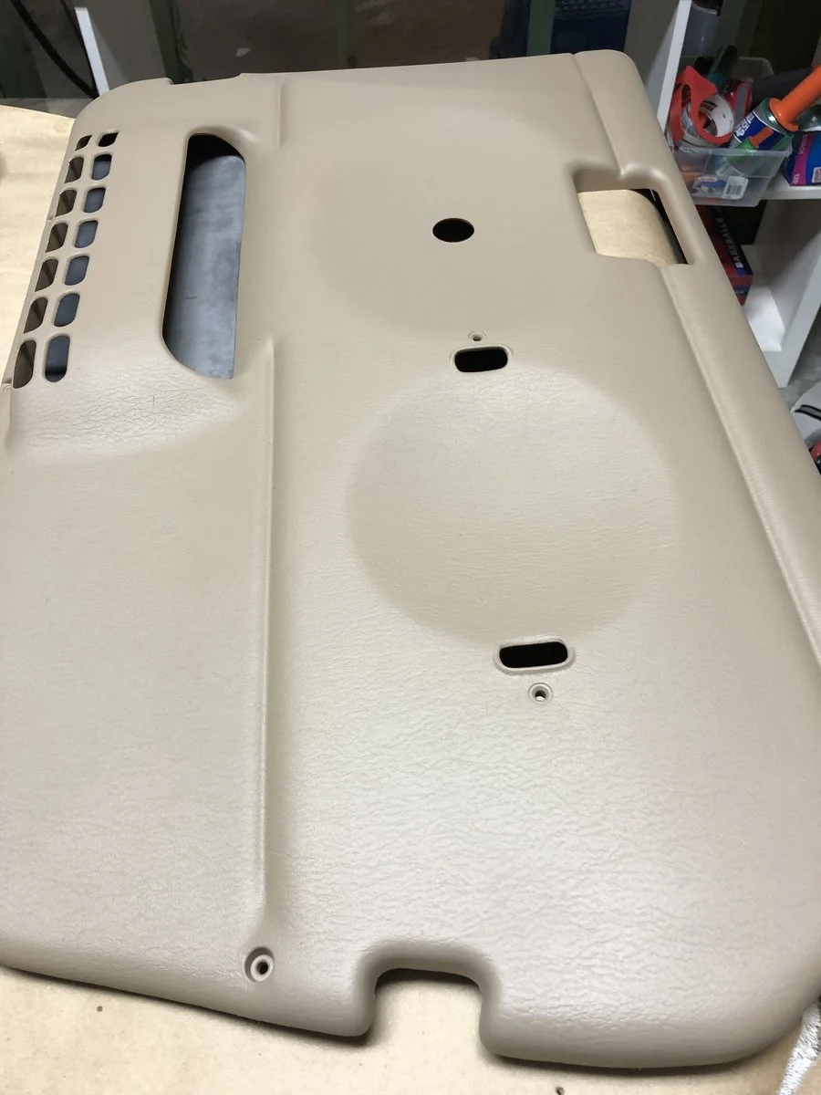

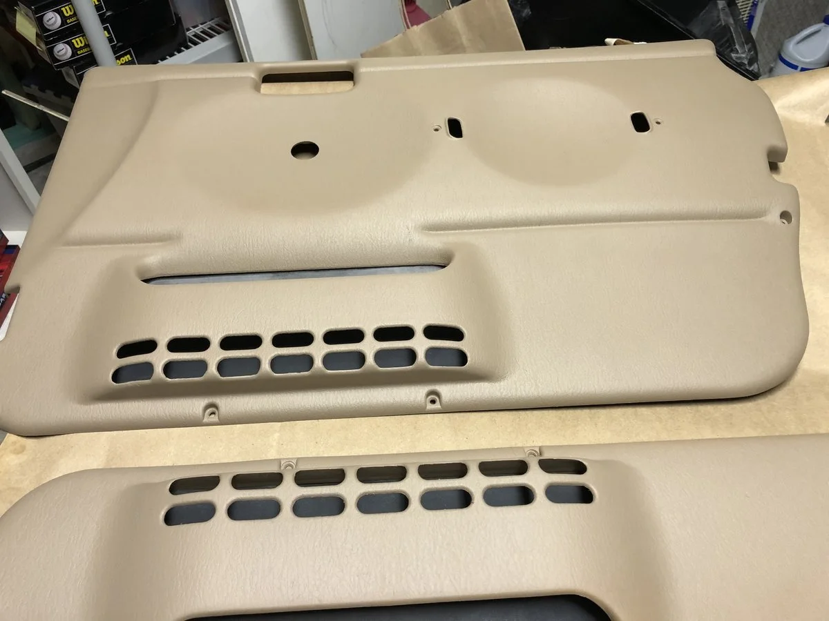

That looks great, man! Thanks for sending the pictures.
Those also help in showing the difference between the two colors. In the thread that Nickgsjeep sent, I saw where someone sprayed a little on a paper towel, but ended up not using it.
Good info. Thanks, again. When you get them installed, send some pictures. Any other projects in store for the interior?
