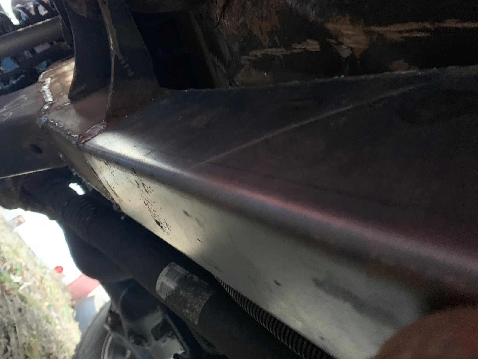

inspected the inside of the frame today with endoscopic camera that Santa delivered. The frame is fairly clean where it rises at the wheels but has some scaling rust in the flat sections between the control arms. as suggested by others I'll add drain holes, try to clean it out and coat with Eastwood's in the spring. The frame seems solid so I hope I'm catching it early enough.

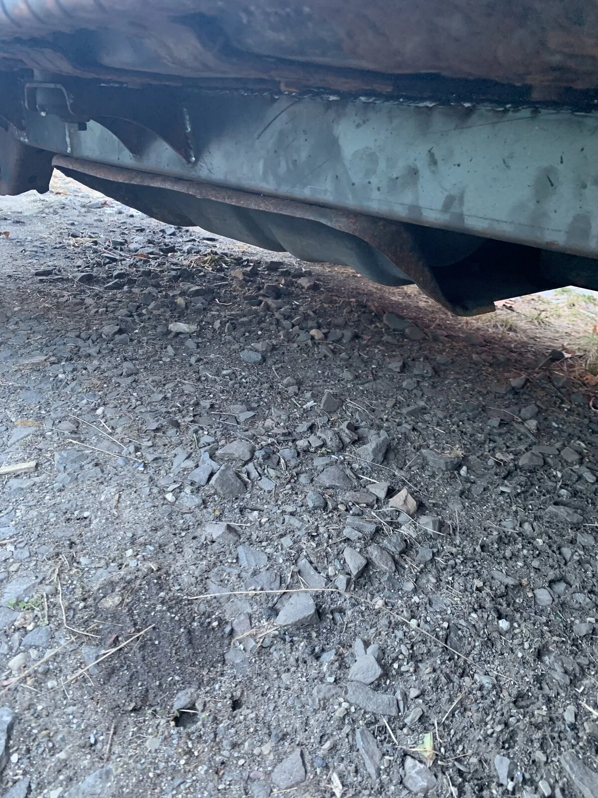

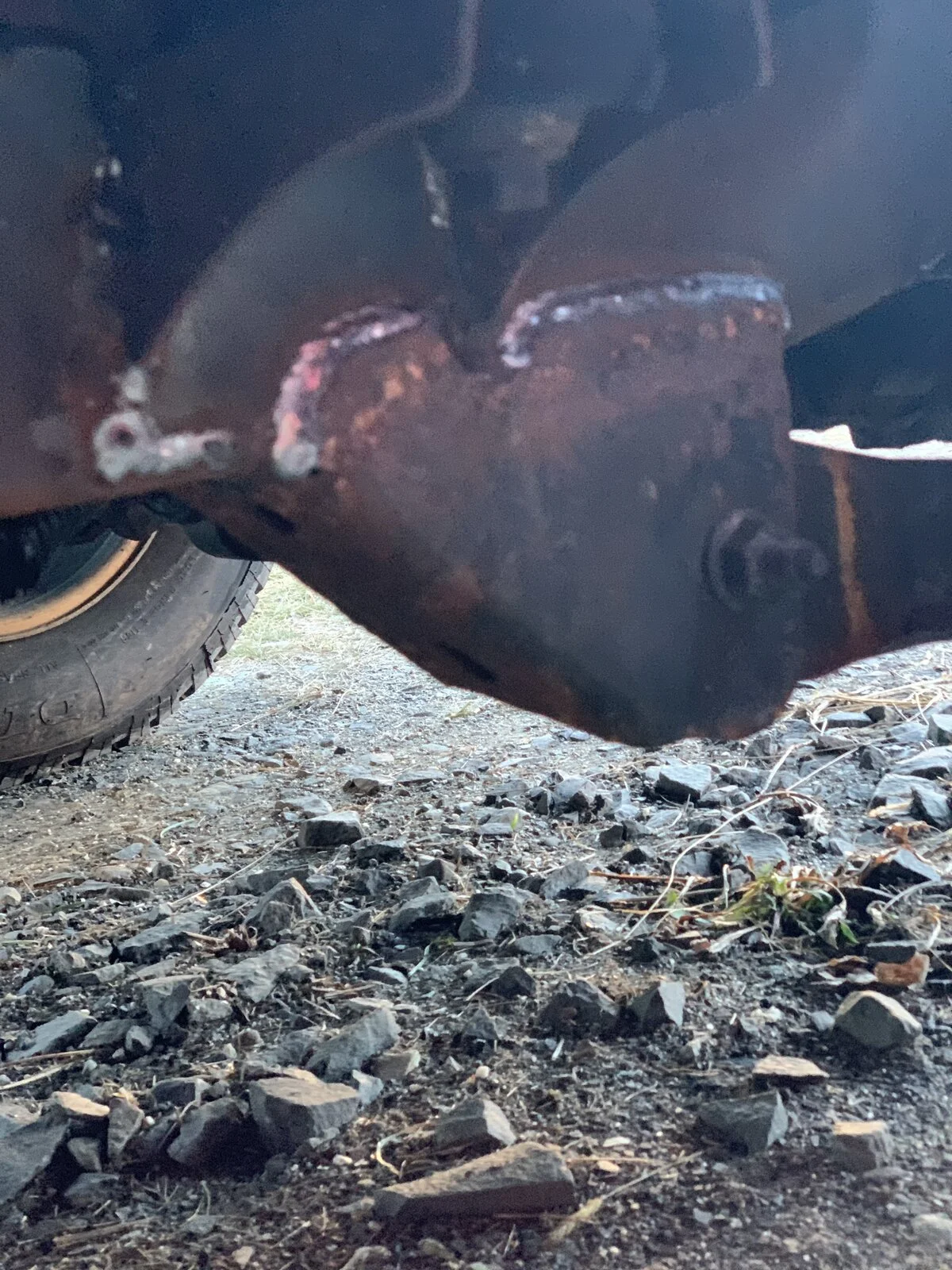

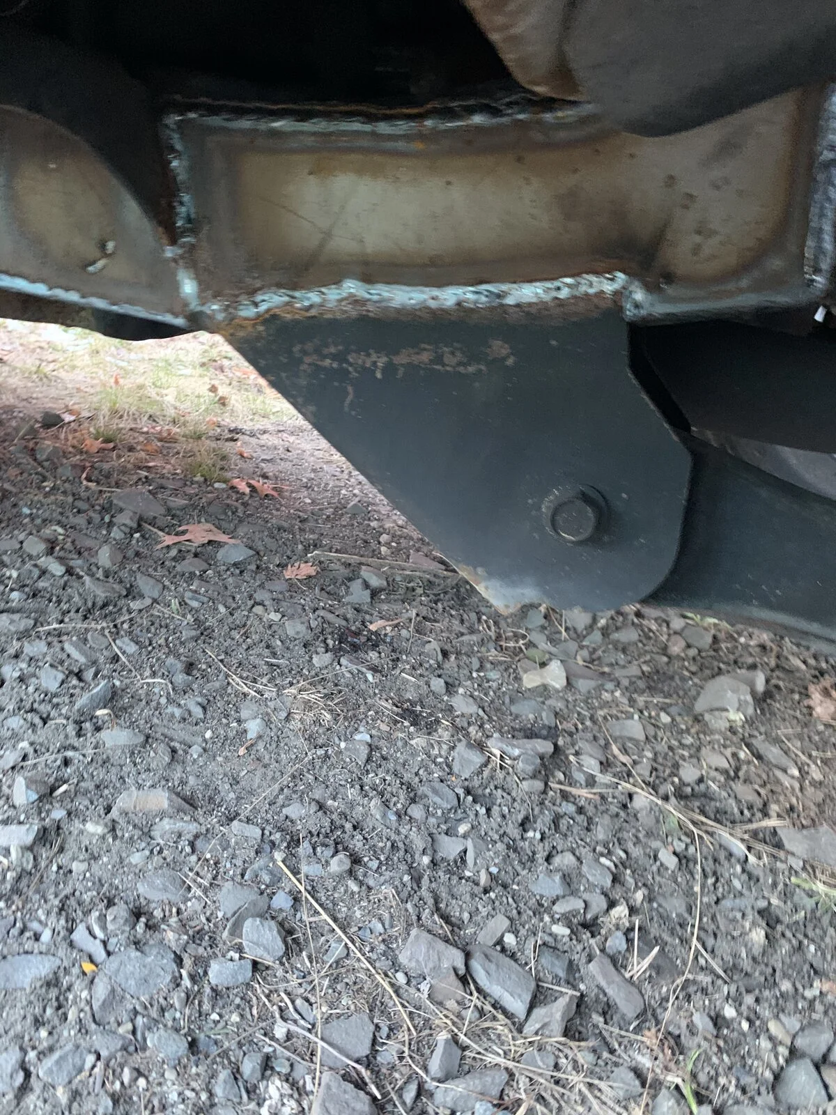

Although Safe-T-Cap is an option, like @Chris posted, Pocono Metal Craft makes essentially the same parts at a MUCH better price point. I actually have their full center frame sections and rear control arm mounts sitting in my garage waiting to be installed. They appear to be even thicker than the stock frame & the welds are top notch.
@EJD recommended them to me.
Very cool! I hadn't heard of those guys before. Their prices are way better!

I was checking out on the Safe T Cap website, and I was really having trouble spending $900 something on a bunch of (albeit well fabbed) sheet metal. I'm glad I found PMC because everything they sell is essentially half of the price and buying from them supports a small, local shop :)
