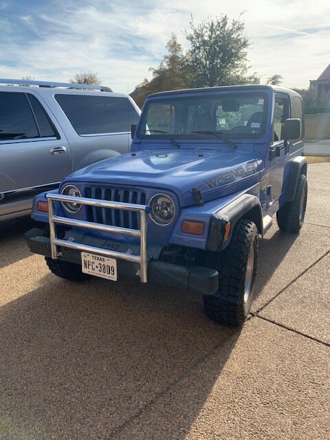

Picked this up last week for $5k. 1997, 4.0L, auto, hard top & full doors, pretty much exactly what I was looking for. No rust that I've been able to find, the biggest problem at the time of sale was that it was randomly dying and was throwing a ton of misfire codes. Quick googling in the guy's driveway pointed me to the crankshaft position sensor. It was a 2 hr drive back home and we didn't have the equipment to tow it, so we needed to be right.
Narrator: they were.
Had that swapped out in 5 minutes, CEL went off, and made the 2hr trip back home no sweat. I don't know what it's like where you live, but here in North Texas, 4L TJ's priced under $7k sell pretty much instantly, and this one appears to be in fantastic shape.

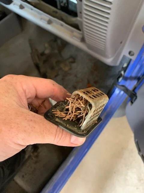

Second problem was he said the heater was blowing smoke/burning. That was simply a bunch of tree debris down in the resistor pack, so for $15 & some compressed air, the heater is back working as well. AC compressor acts a little weird, but I won't be spending any money on that till the spring.

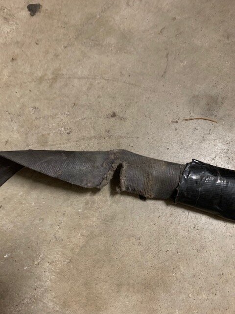

Problem #3 is that the seatbelt was partially cut on the driver's side, so new belts are coming.
Problem the fourth is that factory headlights are useless. I had been wanting halos for my JKU, and as luck would have it TJ & JK headlights are interchangeable, so I cascaded the LEDs off the JK down to the TJ and got my coveted halos for big brother.

Did a few things over the past couple of days. First, I ordered new seatbelts from SeatbeltsPlus.com, they went in super easy. I won't know if they're any good until it's too late, but they seem to be top notch. You can see the old seat belts were "lightly worn."

The seatbelts were definitely necessary. I wouldn’t have had much faith in those old ones to do their job
Yeah, I didn't love the drive home with those, but options were somewhat limited. In hindsight, I could've probably swapped the drivers side with the passenger side before we headed out, although I had to use a cheater bar over my 3/8" socket since the breaker bar didn't offer enough articulation between the seat and the door sill. So we would've had to improvise to get around that.
My JKU is white with green accents, and I was really tempted to buy green belts for it and cascade the JK's belts down to Big Juicy, but I eventually decided to leave well enough alone and only replace the thing that was broken.

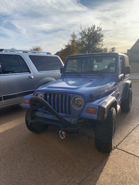

Sometime after crushing the grille, the PO added this fantastically under-engineered cow catcher to the front bumper. It was directly in the path of the headlights, so I was casting my own shadow at night. I'm not sure why I left it on, other than to give me something to complain about and maybe deter any thieves. Anyhoo, replaced it with this smittybilt stinger bumper. I've never had a stinger before, nor have I had a stubby (tee hee), so this seemed like the right opportunity to do both. I got the matching winch plate, but alas no winch yet.
I had one D ring left over from a prior bumper swap, so I threw it on there to compensate for the classic Jeep lean.

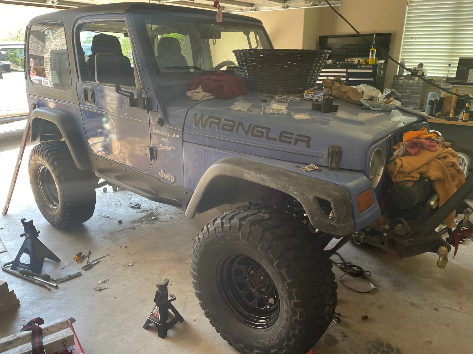

And then last night we started putting new springs at around 9pm and finished at 330am. I got a set of virtually new 2.5" Rough Country springs for basically free, so that made it easy to decide how much I was going to lift Big Juicy. I've got my eye on a set of Rubicon Express shocks, but they're currently out of stock so I still have the OEM shocks. Probably not the perfect suspension set up, but it works and it's only temporary.
As far as actually installing the springs, it was my first time doing such a thing, and I'm sure we didn't do it optimally:
1. removed shocks
2. removed sway bar links
3. removed tie rod on passenger side
4. jacked up the axle on the driver side in order to get the passenger side to drop far enough
5. expended considerable effort trying to push the new spring in
6. re-attached that tie rod end
7. removed the driver's side tie rod
8. jacked the passenger side to lower the drivers side
9. That spring went in like a breeze
On the rear we did it this way and it went much easier:
1. put the frame on jack stands
2. removed the rear sway bar links
3. unbolted the lower shock mounts
4. unbolted the upper track bar mount
5. lowered the entire axle
6. passenger spring went in easy (but had the side effect of pushing the drivers side back up enough to make it not easy)
7. jacked up the passenger side axle a little
8. put the drivers side spring in with minimal effort
In hindsight, I think we should have done the fronts like we did the rear, by removing the track bar and whatever else kept it all in the air. Also using my taller jack stands would allow for the suspension to drop further. Far and away the hardest part of this project was compressing the springs enough to cram then in. The further up you can get the frame, the bigger gap you can create between the axle and the upper spring thing(?). I'm sure most people already know this, but we sure didn't.

But the big news is that I found some extra cash, and dumped just about all of it into the jeep:
  • BFG M/T 33" tires, all but new on FB Marketplace...$400.
  • New steel wheels, allowing me to sell the 31's & Gambler wheels that I was running on, just about offset the cost of this piece of the project.
  • 4" Zone Offroad suspension lift. Yes, I went cheap here. I already had an adjustable front track bar, and I'm not expecting it to ride like a Cadillac. I expect it will be absolutely fine for my purposes.
  • G2 SYE kit
  • Adams CV driveshaft (thanks to the Bleepin Jeep 20% off coupon!)
  • Rusty's adjustable upper control arms. I know people here don't love Rusty's stuff, but Tom Woods sells them on his site so they must be pretty usable.
The tires are on, the lift is on, but the SYE, driveshaft, and control arms won't be here till early next week. And we managed to break the track bar flag nut AND muck up the threads on the passenger tie rod end so until I fix those things I can't drive it. That flag nut seems to be a hard thing to track down. I overpaid for one on Amazon, but I may try to fab one up in the meanwhile and send that one back if it works. And there has to be a better way to get castle nuts than by buying the entire tie rod end, but that's the only way I know of currently. Hardware store doesn't seem to carry them.
