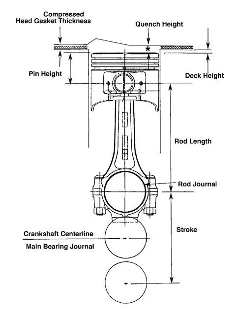

Its mostly about rod ratio (rod to stroke ratio). Rod Ratio = (rod length / stroke) This little calculation tells you the motor's rod angularity. A LOW rod ratio means a HIGH rod angle. A high rod angle creates a greater potential for accelerated wear to cylinder walls, pistons, and piston rings (picture an extremely low rod ratio that is driving the piston into the side of the cylinder wall). For example, a motor with a 5.400" rod length and a 3.000" stroke yields a rod ratio of 1.8:1. If we maintain the same stroke and shorten the rod length to 5.000" we get a 1.7:1 rod ratio. The rod angle has increased.
The picture on the left is Low Rod Angle (or High Rod Ratio) and the picture on the right is High Rod Angle (or Low Rod Ratio). The bottom picture is just there as an extra visual aid.
By lengthening the rod (as stroke is increased) you can offset the increased rod angle. But this requires further shortening of the piston. The further the piston is shortened the more likely the piston pin will intersect the oil ring groove, creating a potential for increased oil consumption.
Basically, there comes a point when you cannot shorten the piston any further before dependability is compromised.
The consensus, from what I've read, among engine manufacturers is that a ratio of 1.50" is the lowest acceptable rod ratio for a street motor. Realistically, rod ratios between 1.65 - 1.80 are ideal. (Maybe this has a lot to do why the 4.0L engines are so long lasting. Their rod ratio is 1.794)
