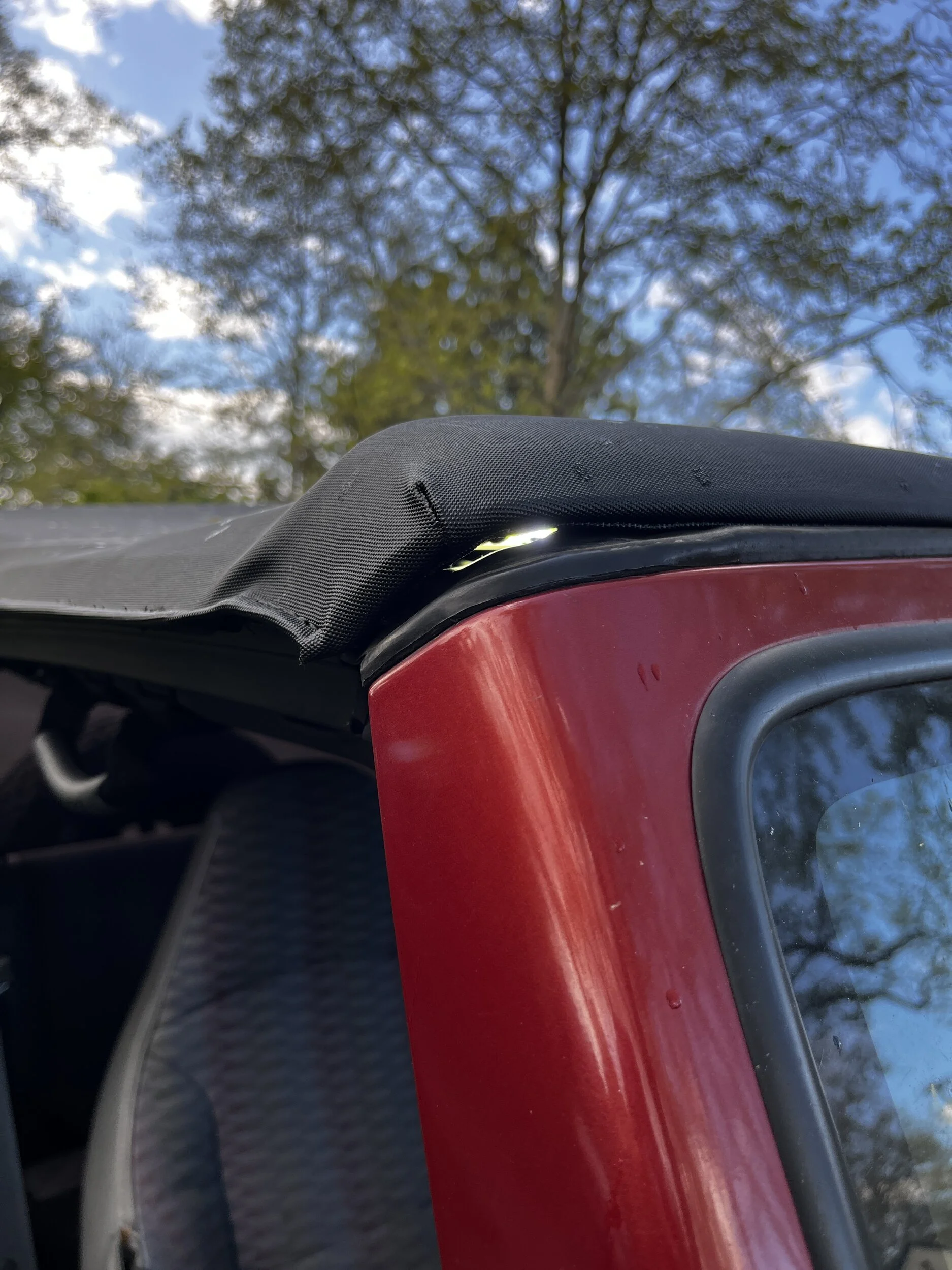

Decent quality but a terrible fit.

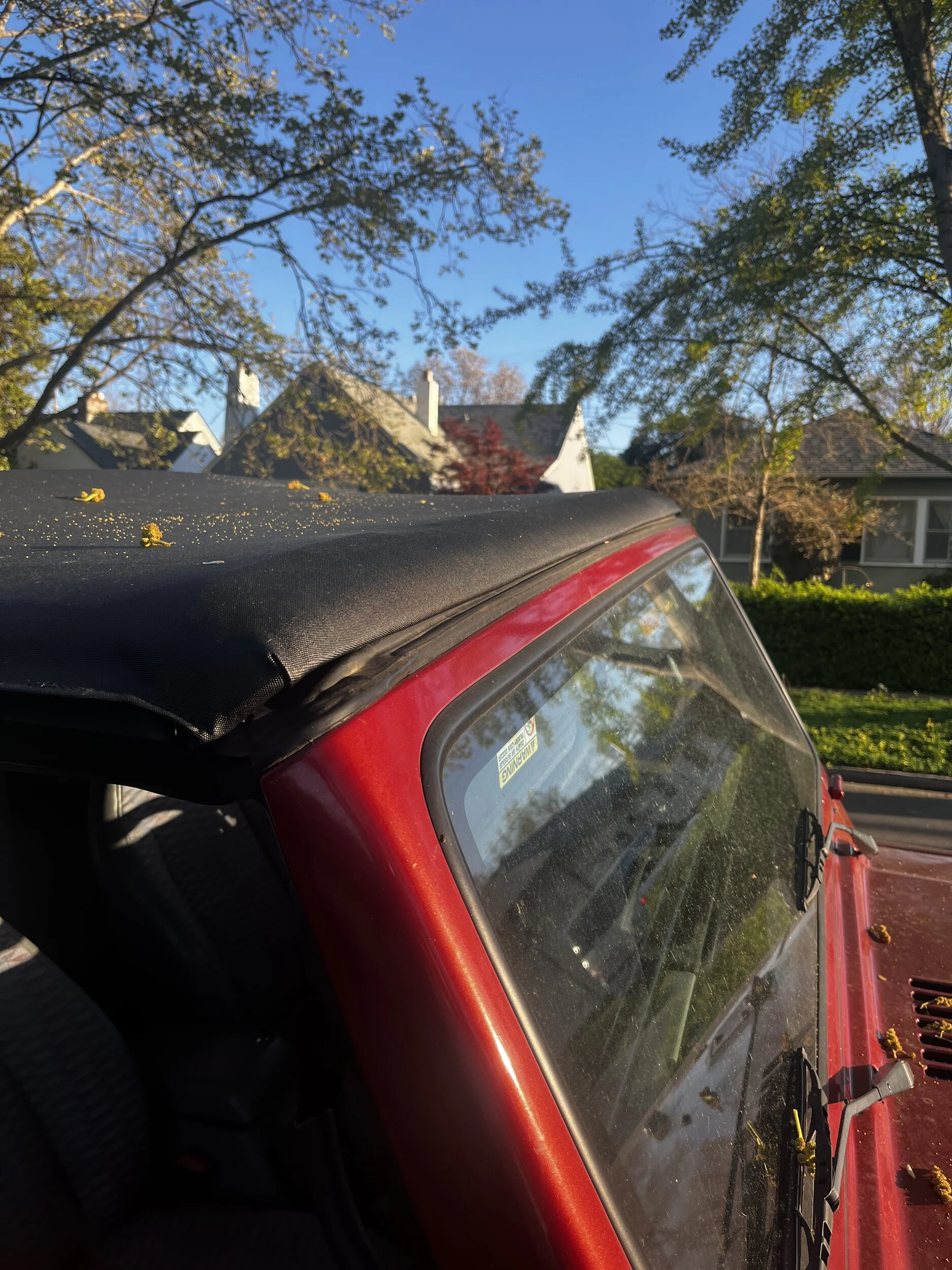

The frame is bent. Open up the bends on the frame between the B and C pillars to tighten up the fabric.
The problem is the header is flat but the windshield has an arc. This pic shows the top not buckled. It's straight across. once buckled, it bends but only to the point of the buckles, then continues straight resulting in the gap at the corners. I tried releasing all rearward tension by taking the whole back and side windows loose, but it won't pull forward any more.
