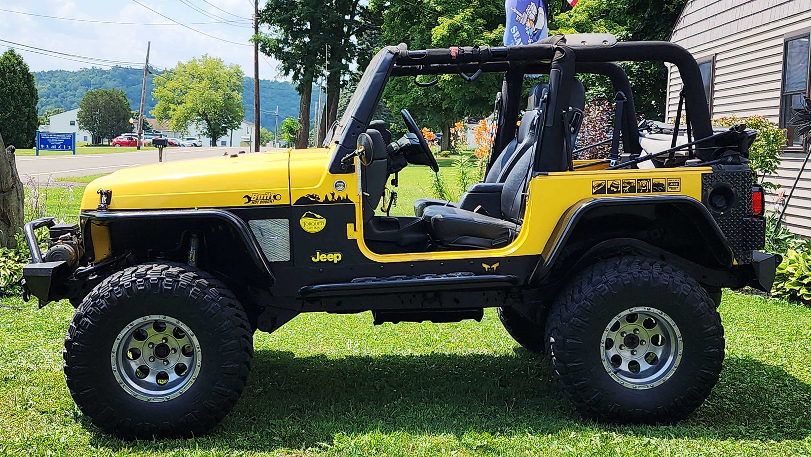

Is it normal to feel like the rear of my 06 Wrangler sways left or right depending on the corner?

I bought it a little over 2 weeks ago and they did alot of mods to it. Ill list them how they had it posted below. But when you turn a corner it feels like the rear slides out to far to the left or right. Maybe like a 4 wheel steering monster truck if you know what I mean. When I take off sometimes it feels like the rear pass side dips down alot like all the weight goes there .
It has 35in tires, does it feel that way because if the tall sidewalls? My other car has 20in low profile tires so I wouldn't feel that same type of thing.

No- not normal
That is rear steer
Check your control arm torque and rear track bar, and look for weld cracks.... especially at the mount that is connected to the track bar and the passenger side control arm - that one fails the most.
I had this and all Control Arm bushings were blown, and track bar bushings. That’s where I’d start
It is a metal cloacxk lift kit, I wonder if the bushings are replaceable, I see the have a big C clip on them. I went to start tightening the bolts and see what happens put stripped one out, have to replace it tomorrow. Impact gun was to powerful I guess lol

I dont see any weld cracks. Im tempted to stick my gopro under there and see if I can see anything while driving.

The rear slide and dip might be due to the tall sidewalls of the 35" tires, but also consider the Metal Cloak 3.5" lift and Bilstein 5125 shocks. The lift and shocks could be causing the rear to swing out more than usual, especially with the heavier tires. You might want to adjust the shocks or consider upgrading to ones specifically designed for lifted Jeeps. Also, check the tire pressure and make sure it's even on all four wheels.
Sometimes you can have somebody push the jeep and slam the brakes while you watch the back control arm bushings- If it’s been in there a while it will need some service probably and they do have replaceable bushings
Your sway bar links can mess with you to
