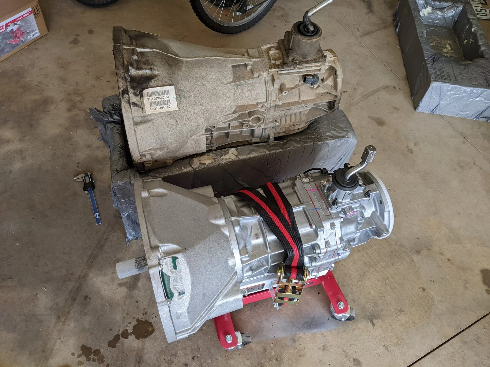

I had an MML with stock skid and no BL on my 99 TJ with AX15. There was enough clearance. Things seemed tighter on my LJ with the nsg370. The bellhousing looks straighter, more cylindrical than the more conical Ax15.
