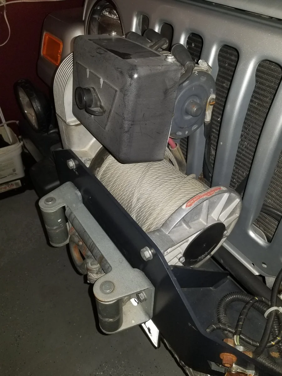

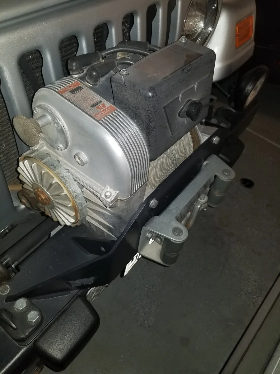

I have the M8274 on a Warn winch plate with the stock bumper. I used to have the stock antiswaybar that I replaced with the Antirock system. No problems, and as @Jerry Bransford said, the winch is attached to the frame.

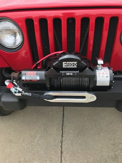

Here's my stock bumper with winch setup. I really wanted to keep the stock unit and avoid those heavy aftermarket bumper options.

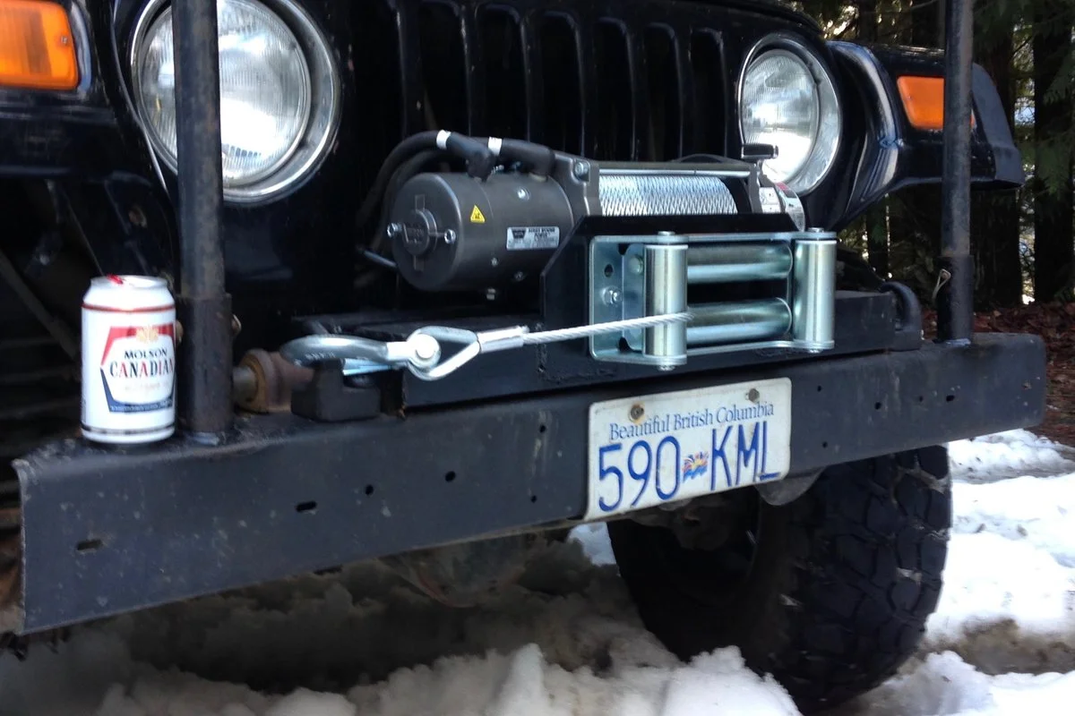

M8000 on the stock bumper with a shop built plate. Might get a Currie Anti Rock Sway bar and lower the winch this summer. Like to see your set up Byhumba...
Mine sits high. The M8274 is massive so it covers a good portion of the grille. No problems with heating while wheeling...other than what's normal. Lol. I don't have a picture of the front of my Jeep, but have these from last year at an angle. I will take one from the front tomorrow and post it.
