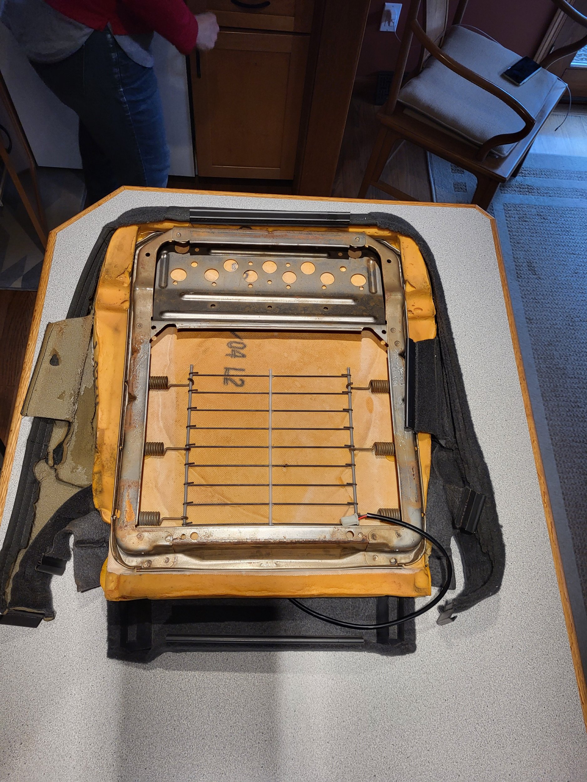

I’m wanting to replace the driver’s seat foam cushion in my 97 with one of the new ones Summit Racing has. I also need to replace the suspension grill underneath the seat as it’s shot.

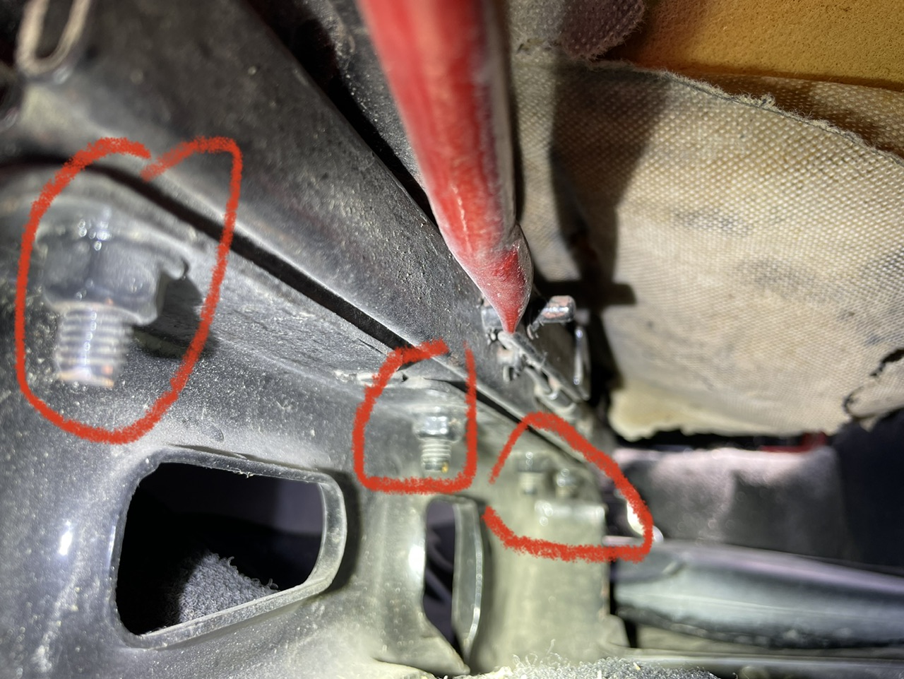

However, when looking under my seat at the 4 bolts that need to come out to remove the seat itself, I noticed that a previous owner replaced the T50 (usually found in the back corner nearest the console) with a regular bolt… but didn’t seem to get it in straight :rolleyes:… and so now I’m concerned that if I remove it, I’ll never get it back in again (ie, the threads will be all boogered up).
The seat itself is rock solid feeling otherwise. So I was wondering if it’s possible to leave the base installed and just remove the seat via the 8 bolts that hold the slider to the base (pic of one side of 4)?

It's possible; but Ive only ever removed the base with the entire assembly out of the jeep. From memory there are only 4 bolts that hold the seat to the base. Getting at those bolts is probably not impossible, but likely involves you being upside down in the back seat for part of the adventure.
Thanks… my 97 has 4 bolts on each side (per the pic I posted above)… maybe different for different year TJs?
IIRC, that's also your seatbelt bolt. :oops:
I think you're right, the one by the console is bigger on both sides.
My jeep has had quite a few welded on nuts that are pretty far from level though, maybe it's just like that ¯\_(ツ)_/¯
IDK, i've swapped in seats to my 97 & 02 and used seats from various years but I've never had 8 bolts per seat. ¯\_(ツ)_/¯

Very simple to remove the seat itself with 2 bolts in the rear and 2 up front. These hold the spring frame onto the base.
You may have to deal with the seat belt.
I guess I assumed it was like the older (CJ) jeeps.
I recently had my seats out and noticed the seat belt is attached to the seat assembly.
I'm surprised a larger bolt is still warranted in that location.
