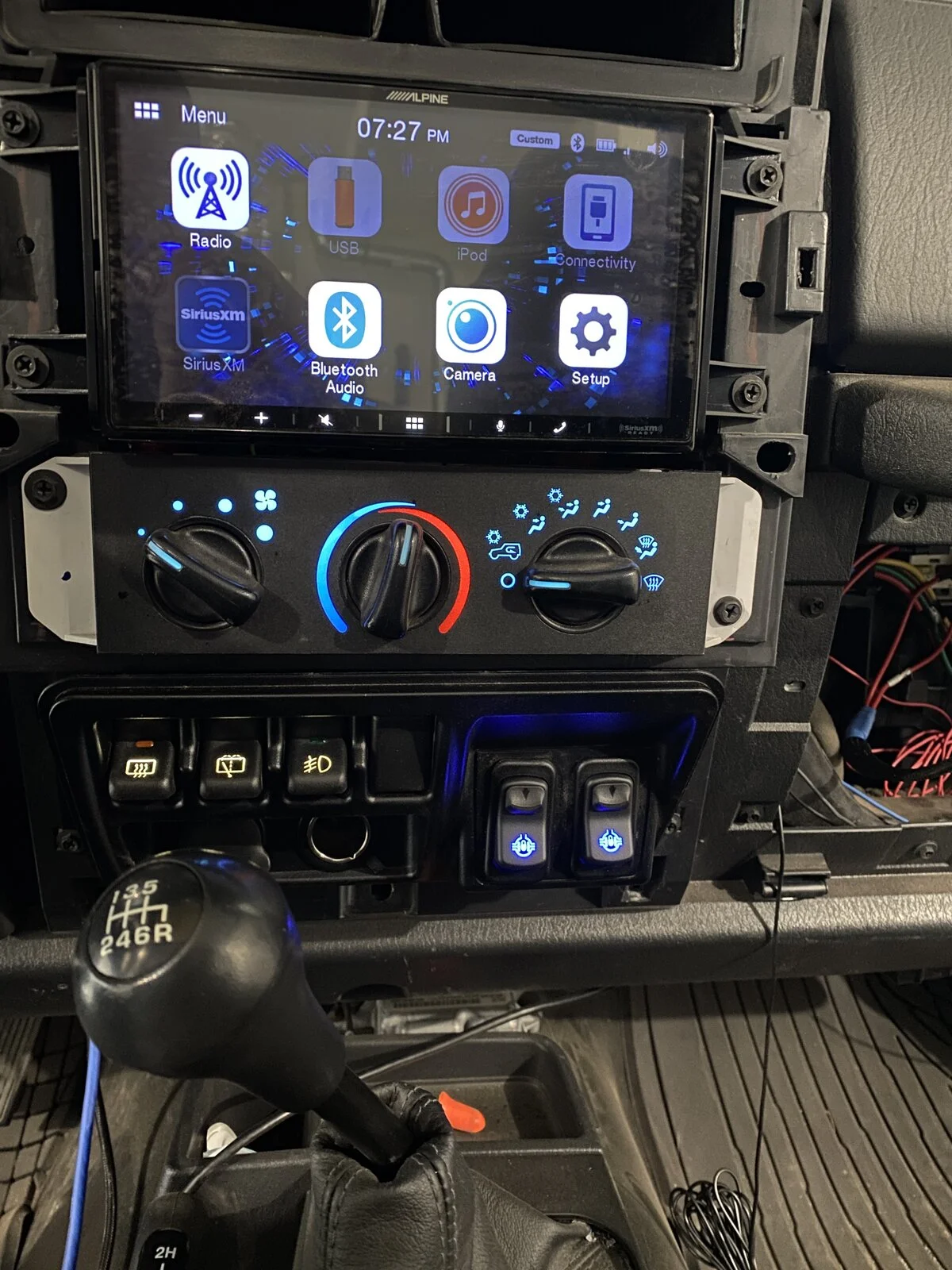

BIG thanks to all who provided expertise and input regarding the diff upgrades I recently completed - 4.56 gears, chromoly front axle shafts, 30 spline rear axle shafts and Eaton eLockers.
