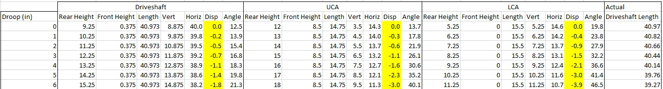

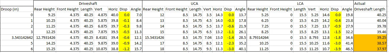

Thanks to the high pinion, the driveshaft is much closer to horizontal than the arms are. So as it droops the arms are going to shorten in the horizontal plane more quickly than the driveshaft will. If my math is right, it makes sense because it looks like the shaft runs out of compression around 3.5" of droop.
I don't know the exact measurements, but assuming the difference in pinion heights between HP and LP is 4", it looks like a LP might be ok out to 6" because it starts out longer at ride height, plus it's at more of an angle so it's arc shortens more quickly.

I drooped mine out and measured and sure enough, it's about 38 5/8; almost an inch shorter than the fully compressed stock shaft. The stock shaft seems to have about 2" of travel so having it shortened I'd have to hit right on the money to capture the range I can reach. Gonna be placing an order with TW when I can get to my computer. Definitely need the X spline.
