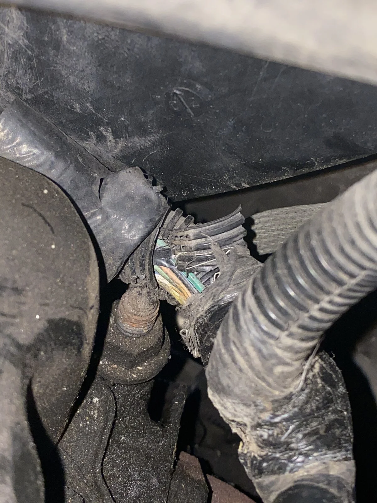

Especially check the wiring harness at the rear of the engine just behind the valve cover where it bends around a threaded vertical stud. The threads are known to wear through the wiring as below. Adding a protective plastic or vinyl cover to that stud is never a bad idea.
