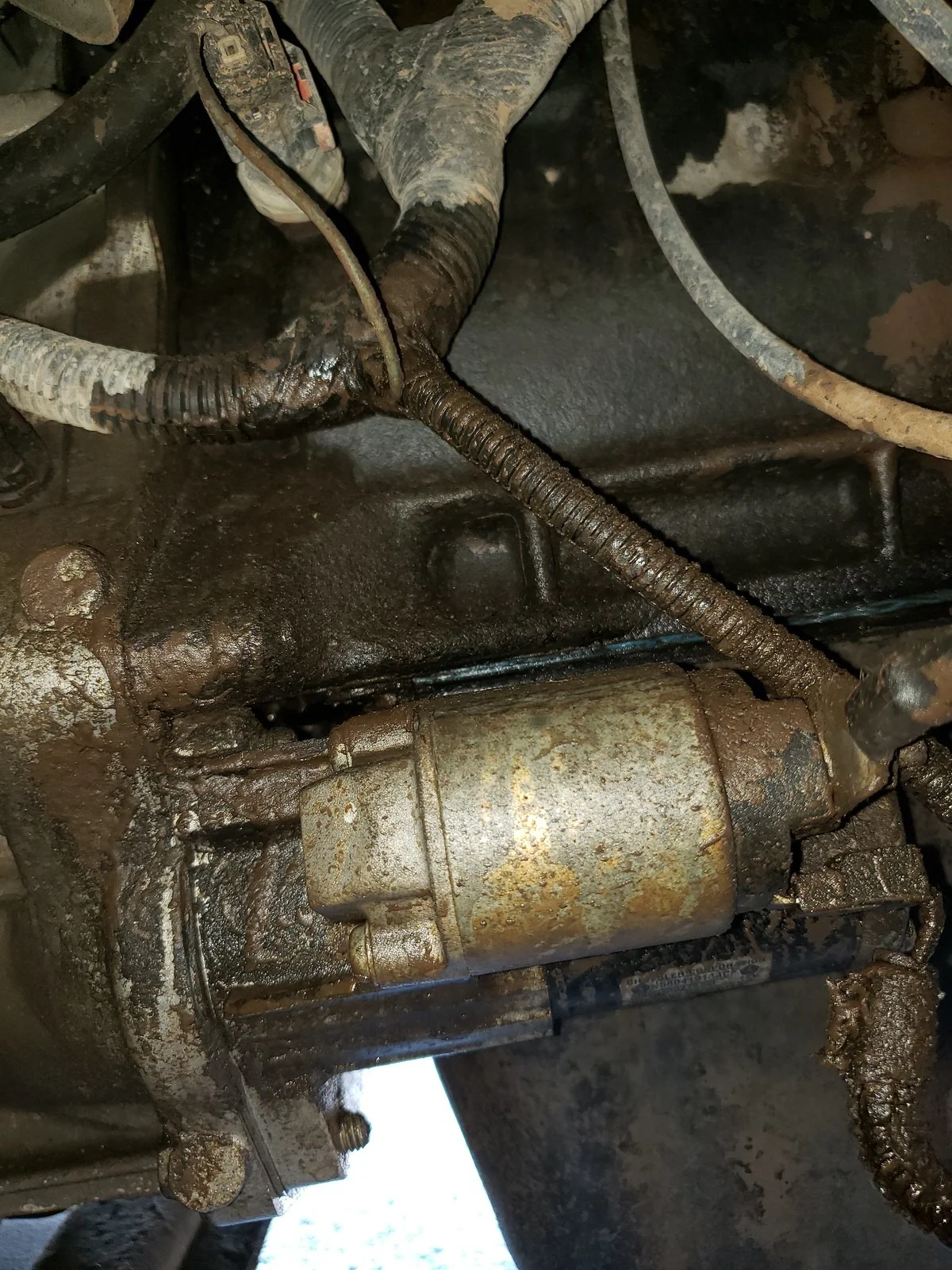

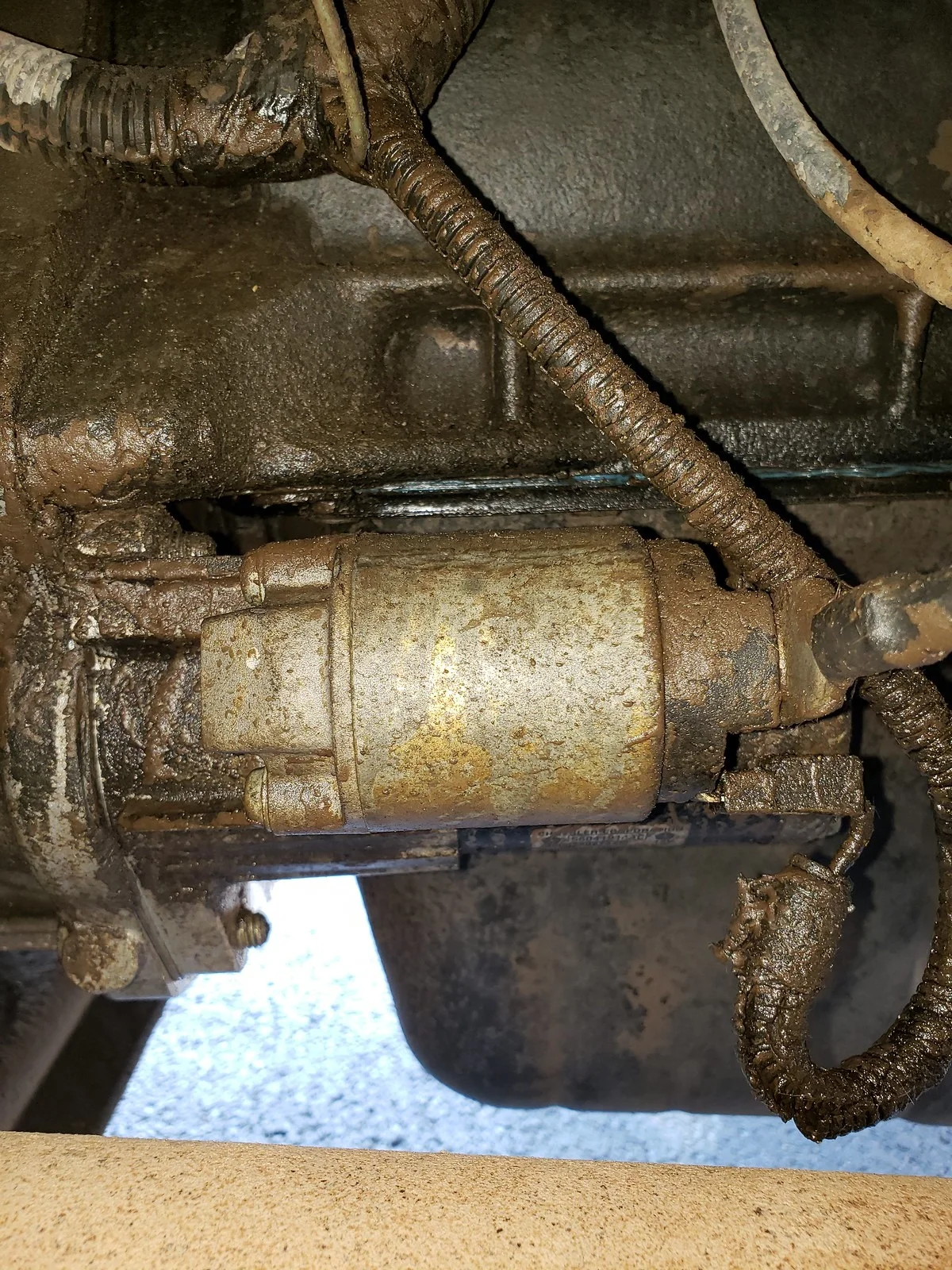

I tried tapping it with the hammer while someone cranked - didn't work. So here's a couple pics of it.
I'm surprised by the gunk on it - it rained today, but the Jeep was stationary and hasn't rolled through anything today.
I think your starter is low on oil by the looks of it. ;) try jumping across the terminals on the starter itself, if it cranks then it's the solenoid not the motor it self, if not replace the starter motor complete.
And you can get a good voltage reading from battery but it may not have any amperage, what floats the boat is amperage.
Is that what that is? Oil, not mud?
Yikes - if that's oil, I'd say I have a bit of a leak somewhere.
you can do your own load test. Put a volt meter on the battery terminals (not the cable ends) while somebody turns the key or you jump the starter terminals. If the voltage drops below like 11-12V while trying to crank, your battery is toast. If it stays at 12V+, it's not the battery. Or not only the battery.
Reactions: CybrSlydr
I have no idea what is, I was making a joke, apparently a poor joke at that.
No worries - when I'm dealing with something new, I don't assume anything. You tell me that's oil, I'll believe you unless told otherwise. I don't want to make any assumptions that may foul up the process.

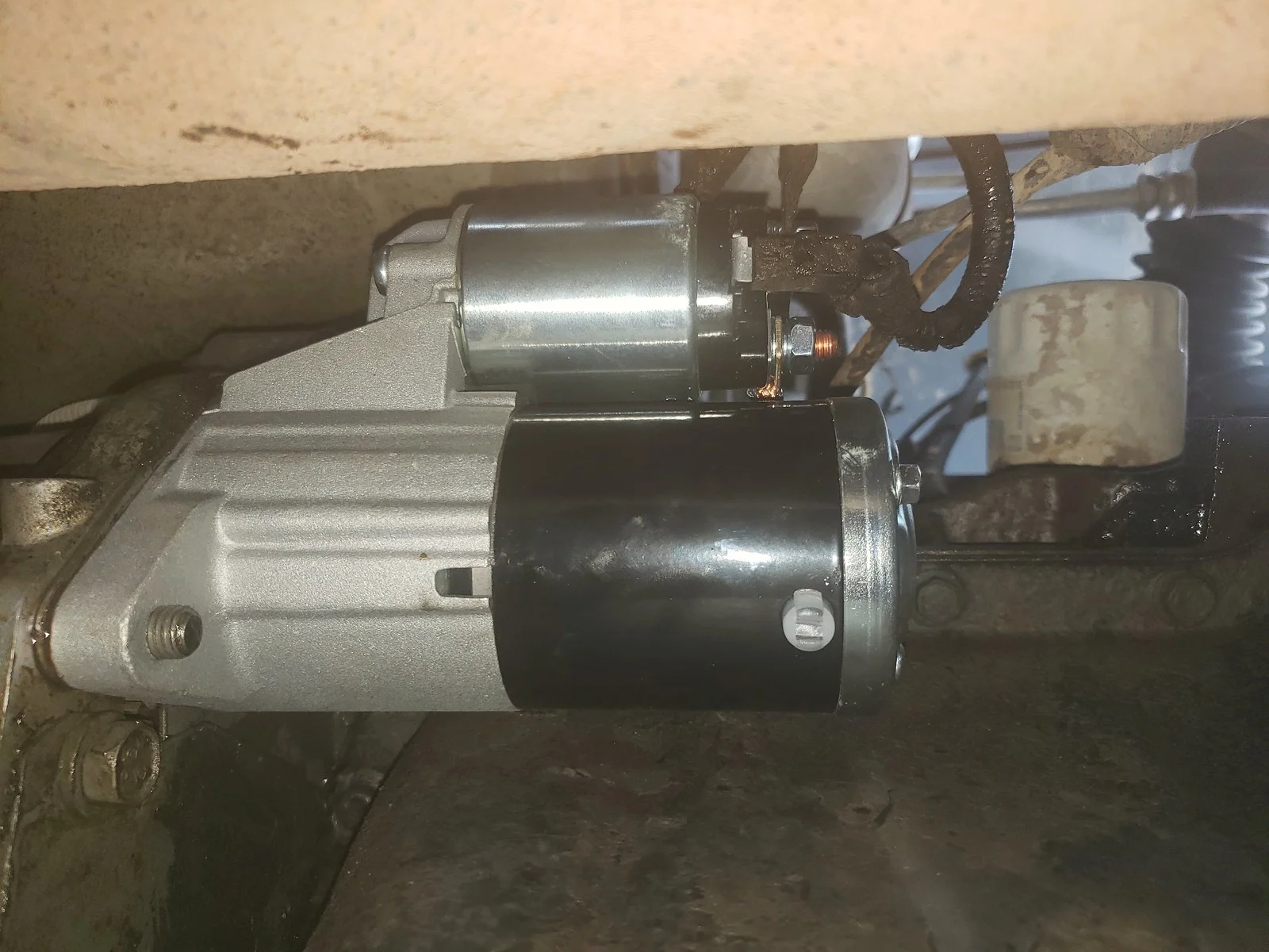

Welp, got the old one off.
Am getting ready to take it to AutoZone where I bought a New DuraMax Gold with a lifetime warranty to swap for the $40 core charge. Prior to the core refund, the starter was $184.99.
