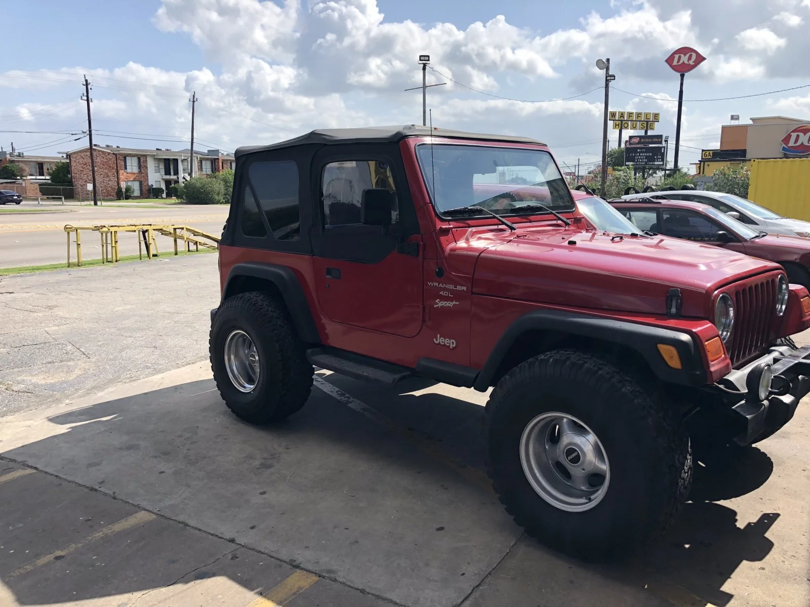

Hello guys and gals. I purchased a 2000 TJ yesterday with 35 inch tires. Guy at the dealer told me that the jeep was not lifted. I have attached a photo to see if anyone can tell if it has some sort of lift on it. I find it hard to believe that 35s would clear on a stock TJ. Thanks in advance

Well guys, looks like no lift. Front spring is 12 inches and no spacer
You best get some lift or get some 31's. In the meantime stay on the road and avoid bumps.
I've actually never seen anyone get 35's on a stock TJ before
Reactions: StG58
Wow! No bumpstop extensions either. Amazing the fenders aren't smiley faced by now. sell those 35's and get some 31's. Or, time for a 4" lift and a 1" body lift if you want to keep them. Must drive like a dog too with stock gearing.
