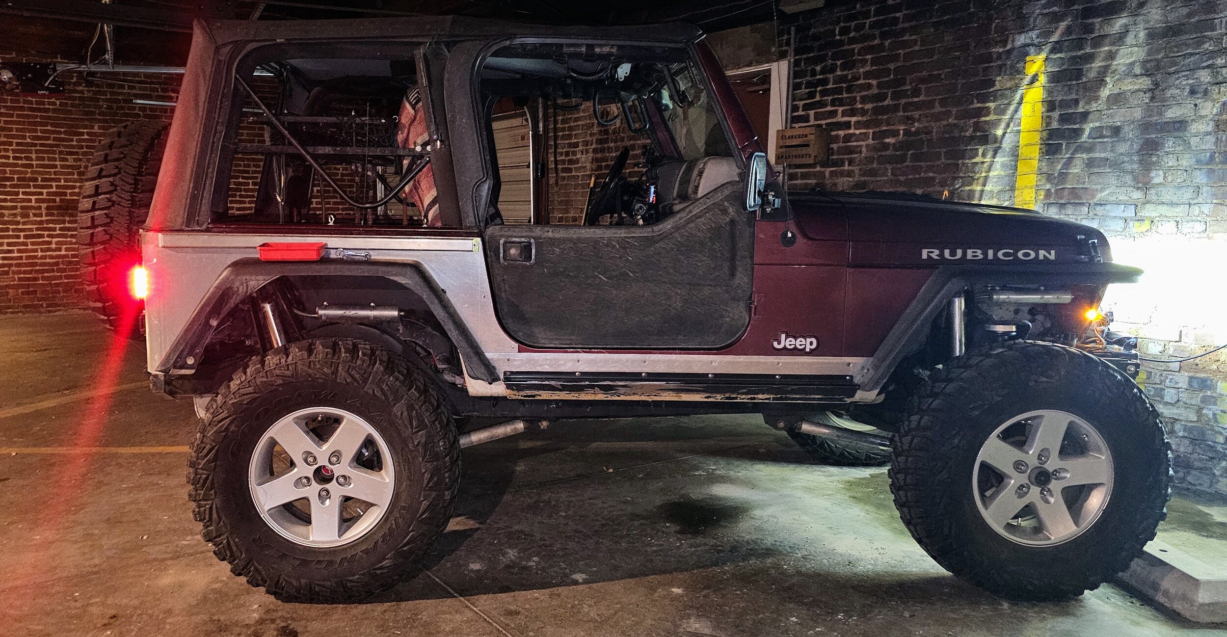

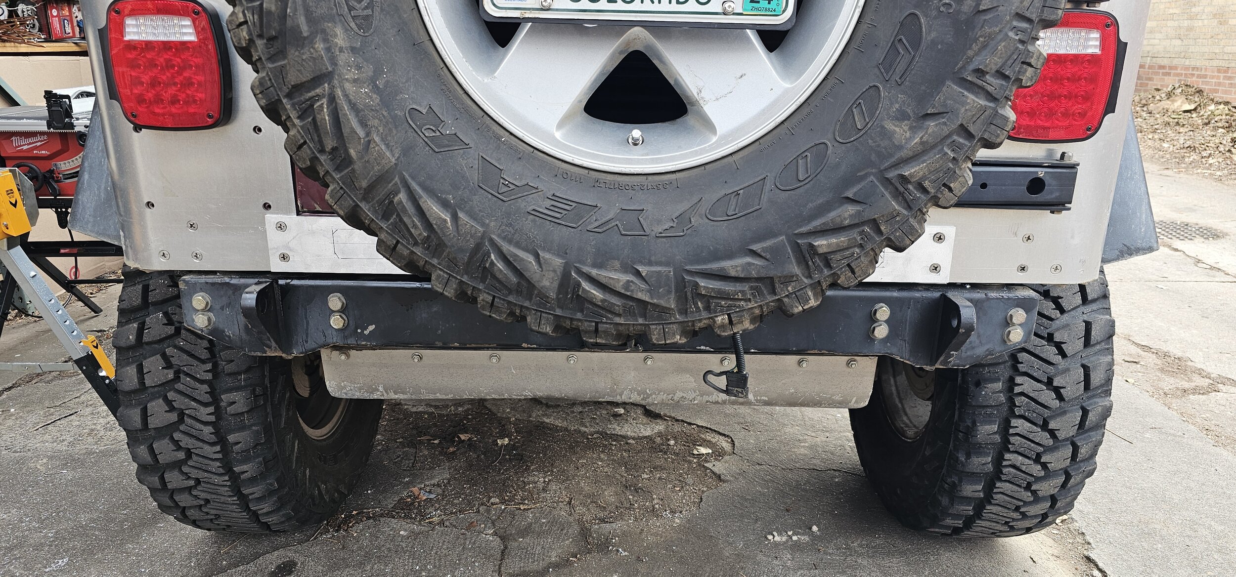

Has anyone measured the clearance at the lowest point of their spare tire?
It'd be interesting to see some numbers with the varying carriers and tire sizes.

Mine sits just above the bottom of the body. 35" tire with a stock spare tire mount modified to sit an inch higher on the gate. That is going to be the only useful point of reference in a measuring contest with a whole bunch of variables.
The distance from the ground is whatever the same size tire creates along with a 4" spring lift plus a 1.25" body lift.
The tire is also pulled tight against the hinges, meaning it only extends out the width of the tire plus the thickness of the hinges.

I think some raw numbers would be interesting to see, if only to satisfy a curiousity. I for example have no clue the difference between your setup and @NashvilleTJs 40" on a full-custom tire carrier.

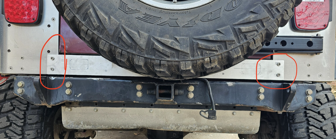

When are you countersinking those bolts? I've seen this plate like 3 times now, and it just bothers me every time.
Already countersunk shortly after that pic was taken. The Sharpie marks should go away this weekend when they turn into more countersunk bolts and some lights.
