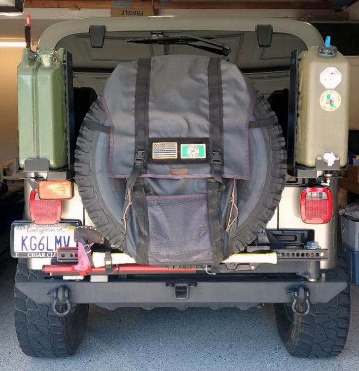

I am late to this thread. I use a Rockhard 4X4 rear bumper and swing-away tire carrier with jerry can mounts. The welds are good, as is the finish. It does not rattle or squeak. The swingaway latch is easy to use. I use a "skinny" 255/85R16 spare rather than a full size 315/75R16 to keep the spare tucked a bit tighter to the tailgate and save a few pounds.
I am in general not a fan of tailgate mounted spares because hanging that much weight on side opening tailgate hinges can create more problems than solutions. I have no issue with a swingaway carrier that doesn't rattle or squeak and can handle the weight of the spare and jerry cans without sagging when the swingaway is open. In that aspect the Rockhard product is better than competitors' with swingaway design.

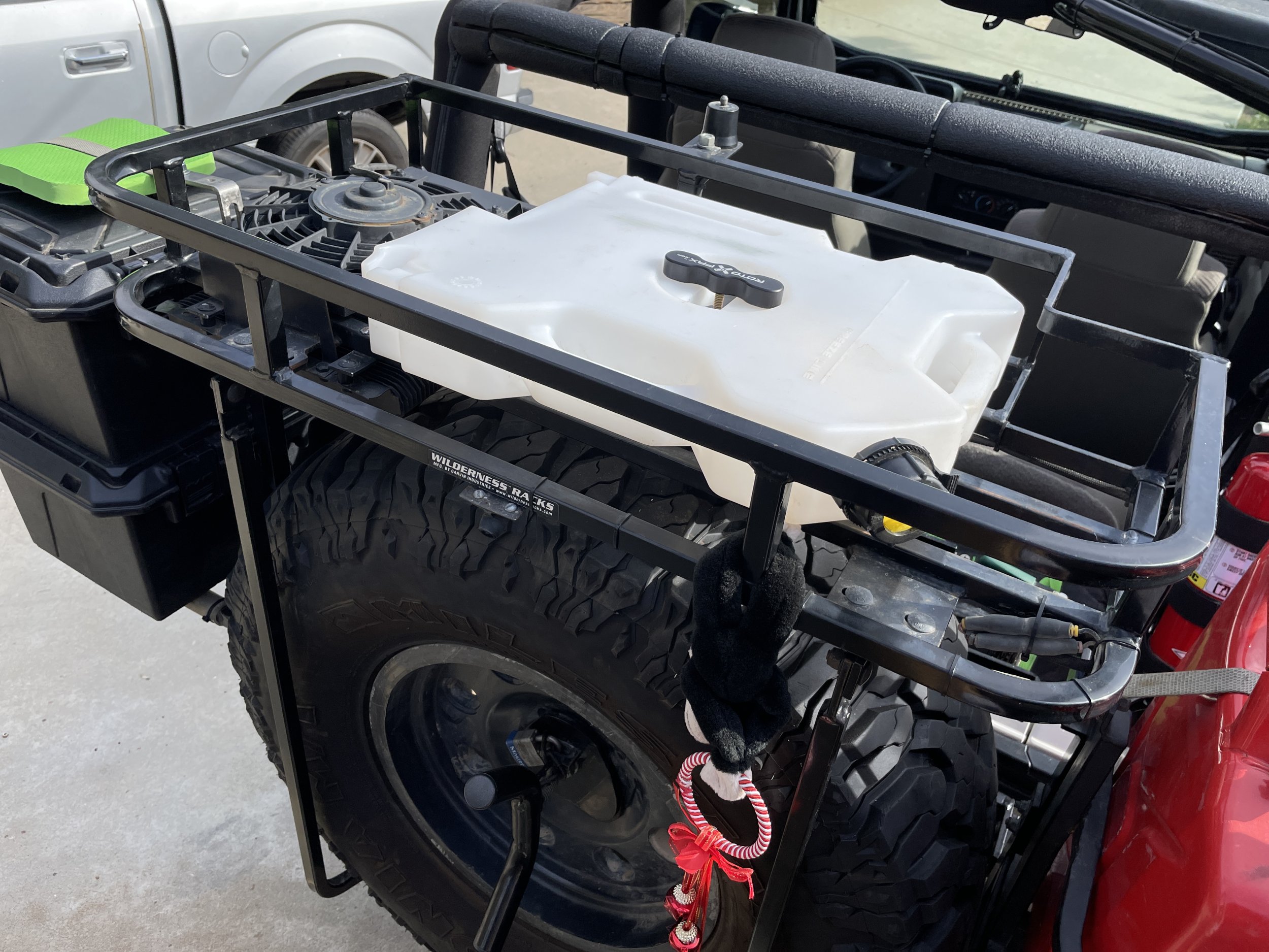

I appreciate this thread. We're running a Garvin bumper and swingaway and I'll say, having recently weighed the TJ (4900+ lbs!) I'm thinking that one possibly way to shave some weight is to consider heading back to a tailgate mounted spare like y'all have suggested here.
That would mean we'd have a Garvin rack/bumper for sale (recouping cost is a good thing) but I think the biggest thing I'd miss is the ability to carry fuel/water/cargo on the rack, since we'll commonly have 3-4 passengers. I'll have to troubleshoot where I think we can add that back in in other spots on the jeep. (metalcloak rear fenders DO have quite a bit of flat real estate for mounting things. :D )

Would you kindly tell me more about the tire mounted storage / trash bag?
Who makes it?

One consideration - I have no problem whittling down what I currently carry on my Garvin rack as far as cargo, but the previous owner mounted a backup camera and an aux cooler/fan for the transmission on the Garvin rack, so I'm going to have to fab up a replacement, minimalist "shelf" above the spare tire for the camera and the cooler/fan (unless we decide to delete the cooler, which is unlikely since it works well).
Seen in the picture to the left of the Rotopax.

Put the aux fan under the jeep like everyone else 🤷‍♂️
It's common enough. Derale recommends it there on their TJ cooling kit, and is where mine is located and where I installed it on my previous TJ too. Here's my install writeup. https://wranglertjforum.com/threads...-transmission-cooler-on-your-wrangler-tj.590/
