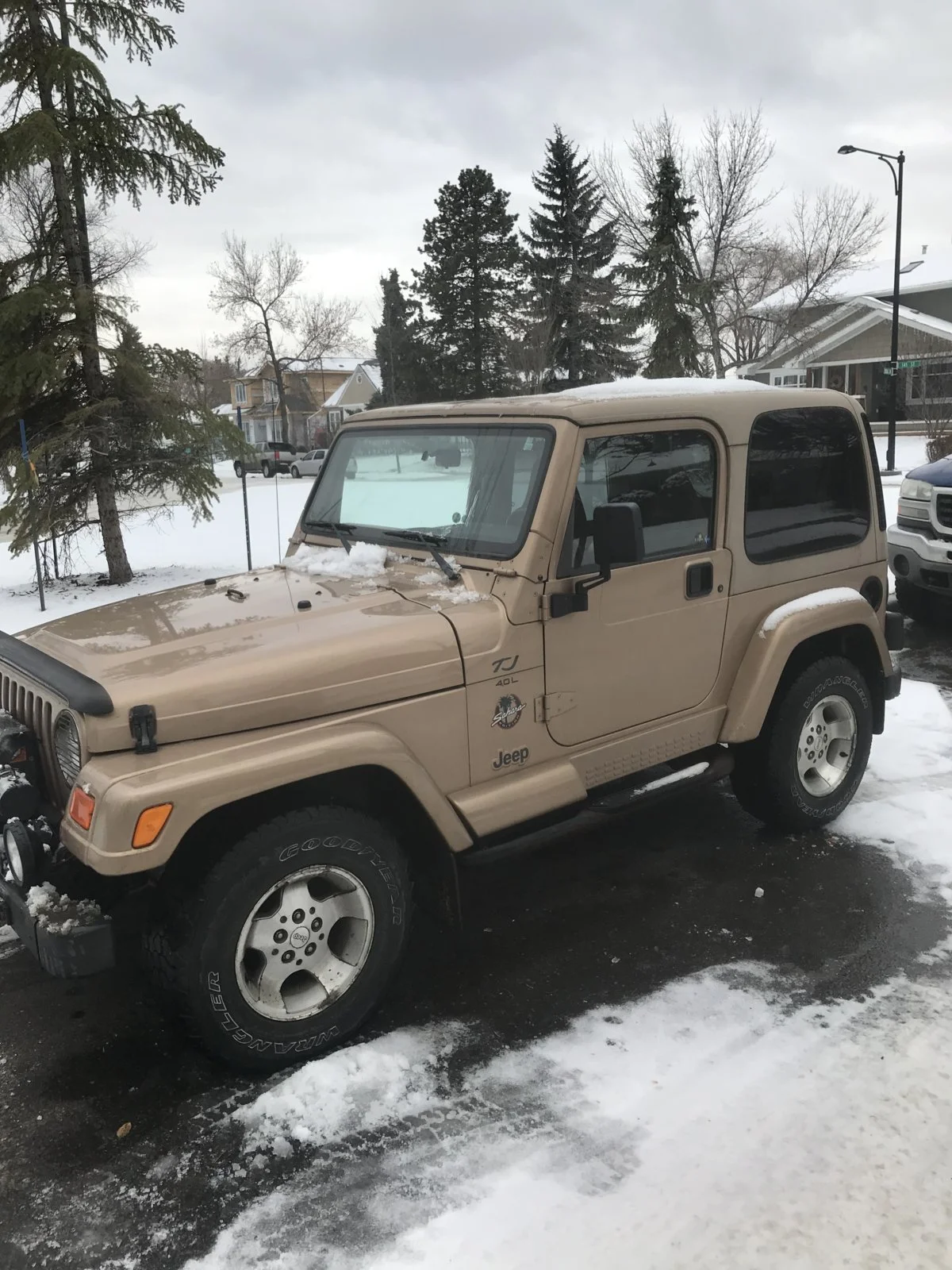

Thanks for all the feedback! I bought the Jeep. Looking forward to the fun in the garage and on the trails. 02CF8A7D-EEB9-410C-8315-4200246C45CD.jpegD8A68E12-D96C-42A9-9191-23CBEC10D9B5.jpeg
