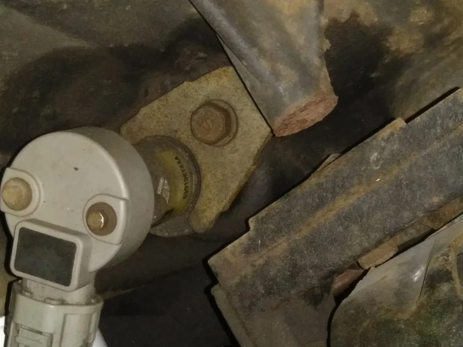

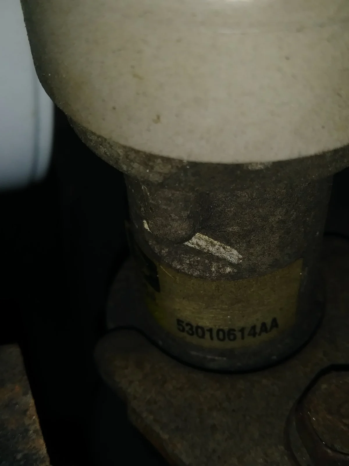

So I'm researching on here about preventative parts I should look at replacing to keep my rubi strong.
Got to reading about this opda, Mines an 04 with the S in the VIN in the 8th spot I think.....but when I look around my jeep, mine doesnt look like anyone else's.
A search brings up that its some kind of cam pisition sensor and oil pump drive...but why is mine different?
Is it prone to the same non crown opda issues?

Thanks Jerry! Unless that was said with sarcasm lol.
Can you please educate me in what I have vs the infamous opda?
I'm figuring that what I have probably does the same job...but is mine more reliable? Is it stock? Why do some early 2000s tjs have the bad opda while mine has this?

You're 2004 still has an OPDA, it's just not the problematic one found on the 05-06 models.
Which makes me wonder... why don't us 05-06 guys just take the OPDA from the earlier models and put it in ours? I wonder if it would fit, or if the provision in the block is different.

I should rephrase the title of this thread lol....of course I have one, or some version of one. The question is, is my design as troublesome as the more "domed" ones I see everybody replacing in the videos?

While researching around, I asked myself that same question. If my version works well (and looks simpler) why not revert back to that?
I re-titled the thread for you to be more self-explanatory.
No, you don't have to worry about the OPDA on your 2004. It doesn't have the design flaw that the 05-06 models had, so you literally have nothing to worry about.
Though I will also add that I've owned TWO 2005 TJs, and neither one has had the OPDA fail on me. For what it's worth...
I'm actually very curious about that. I have to imagine if this worked, people would have done it by now. My guess is that the provision in the block for the OPDA is different on the 04 and earlier models.
However, I'd be curious to take the OPDA from an 04 and try to put it in my 2005, just to see what about it doesn't fit.

Though not as probable than the 05 and 06... I read somewhere of a couple 2004s having that issue.
Ofcourse... reading it on the internet is not a very good source.. but i see no reason why someone would lie about it.
Overall, its a non issue if you have a 2004.. but if you hear the squealing.. than i would take a look at it.
