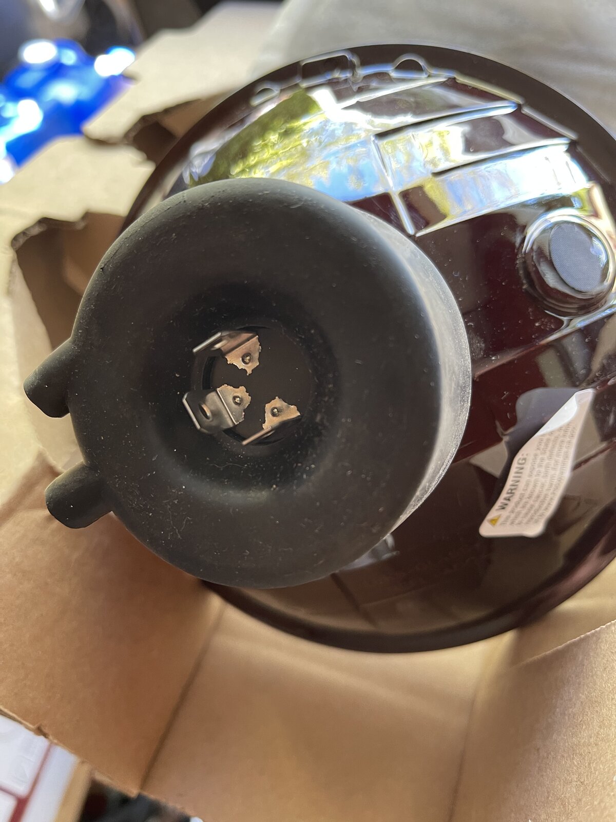

hmm… my tj doesnt have an H4 connection. here’s back of the rampage. the housing going to my existing lamp does not mate to that.

Then you have some kind of adapter for a different type of light on your Jeep. TJs have always come with an old style sealed beam bulb, which looks just like your lights.
Can you take a pic of your wiring harness? That might help.

lamp is currently on the jeep right now but here’s a pic I took for different purpose. Sorry. bad angle. But basically where the arrow points to is the receiving port for the harness that I have. Coulda swore it was OEM but admittedlt have nothing to compare against and I cant figure out why someone wouldve gone to the trouble of custom installing what is in there now (total shite).
H4 should be plug and play. The connector you've pictured looks to be a harness adapter of some kind. Take @C.J. Roberts recommendation. Follow them back. You should find the OE H4 plug that will mate up to your new lights. If not, someone replaced the OE harness.
