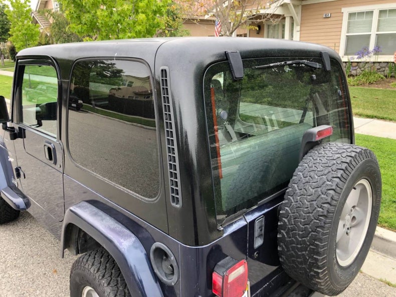

You mention that you don’t have a vented door or body. The ‘97-‘02 hardtops had vents in the c-pillars, while the ‘03-‘06 tops had no vents, as the vents had moved to the tailgate door. Do you have a late top on your early TJ?
Not asking to try and solve your whistling noise, but curious about the comment of not having vented doors.

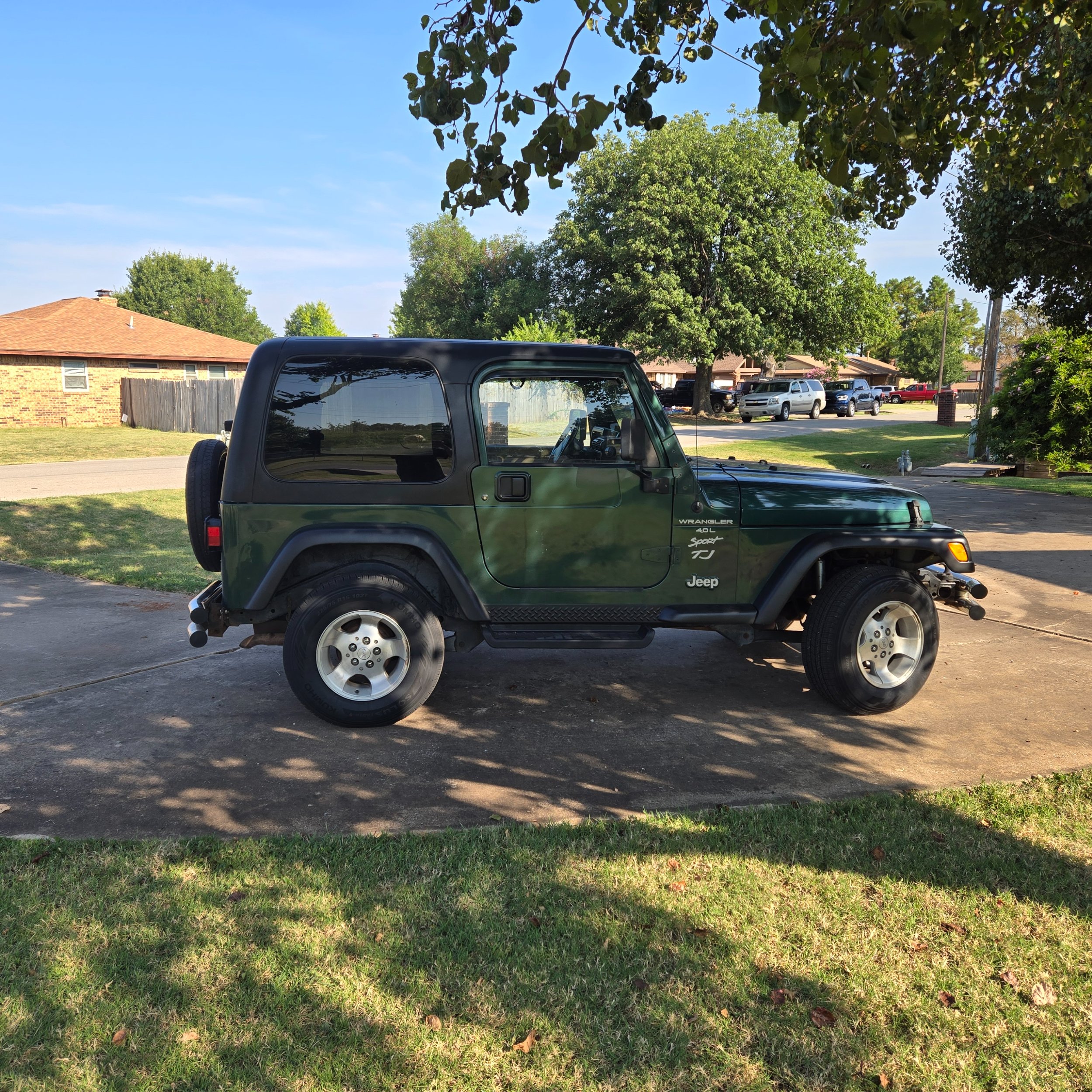

Someone replied to any earlier post that I had a late model top. I don't know the difference. I don't see any evidence of any relief the jeep has. I don't know what I would be looking for?
This might have a bearing on cab noise?

Here's the early hard top. See the vent on the c-pillar? Don't know that the lack of vent would cause any noise.
