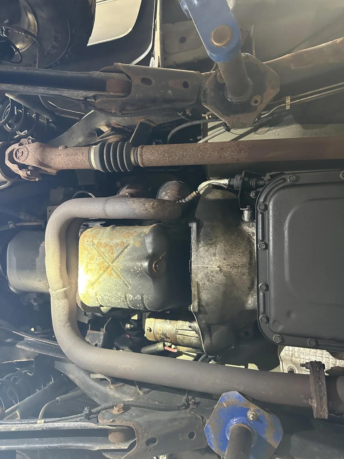

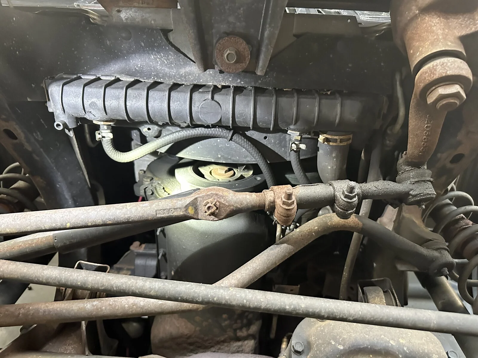

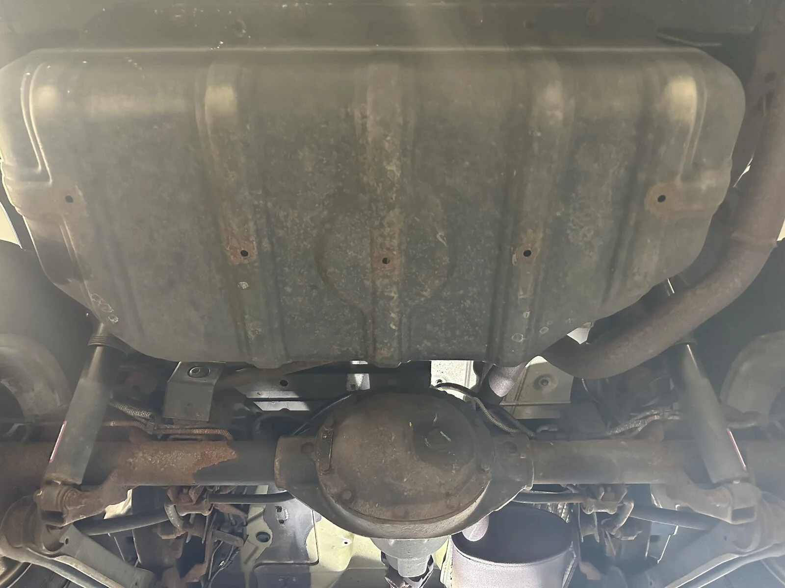

Hi. First post and very new to Jeeps. The one thing I know about them is that rust can be a huge issue. That said, this is a Jeep I am looking at purchasing. Does it look good underneath? My
apologies if I haven't followed the forum's posting rules, but I would really appreciate your feedback. Thanks!

Welcome to the best forum around. Grab a screwdriver and poke along the frame especially around the control arms looking for rust holes. That’s one of the weaknesses of a tj. I’ve seen a lot of rusty front fenders too.

If it’s rust free in your neck of the woods then it’s something to take a good look at-
Keep in mind it is a 20+ year old vehicle and it’s going to need some little things- I haven’t got my hands on one yet that does not.
If they sent you those pictures they deliberately did not show you the frame and that usually is for some reason-
If you took the pictures go back and get pictures of the frame and listen to what these above posts are saying.
Rust can be dealt with as much sometimes it takes some pretty extreme measures depending on the extent of it.

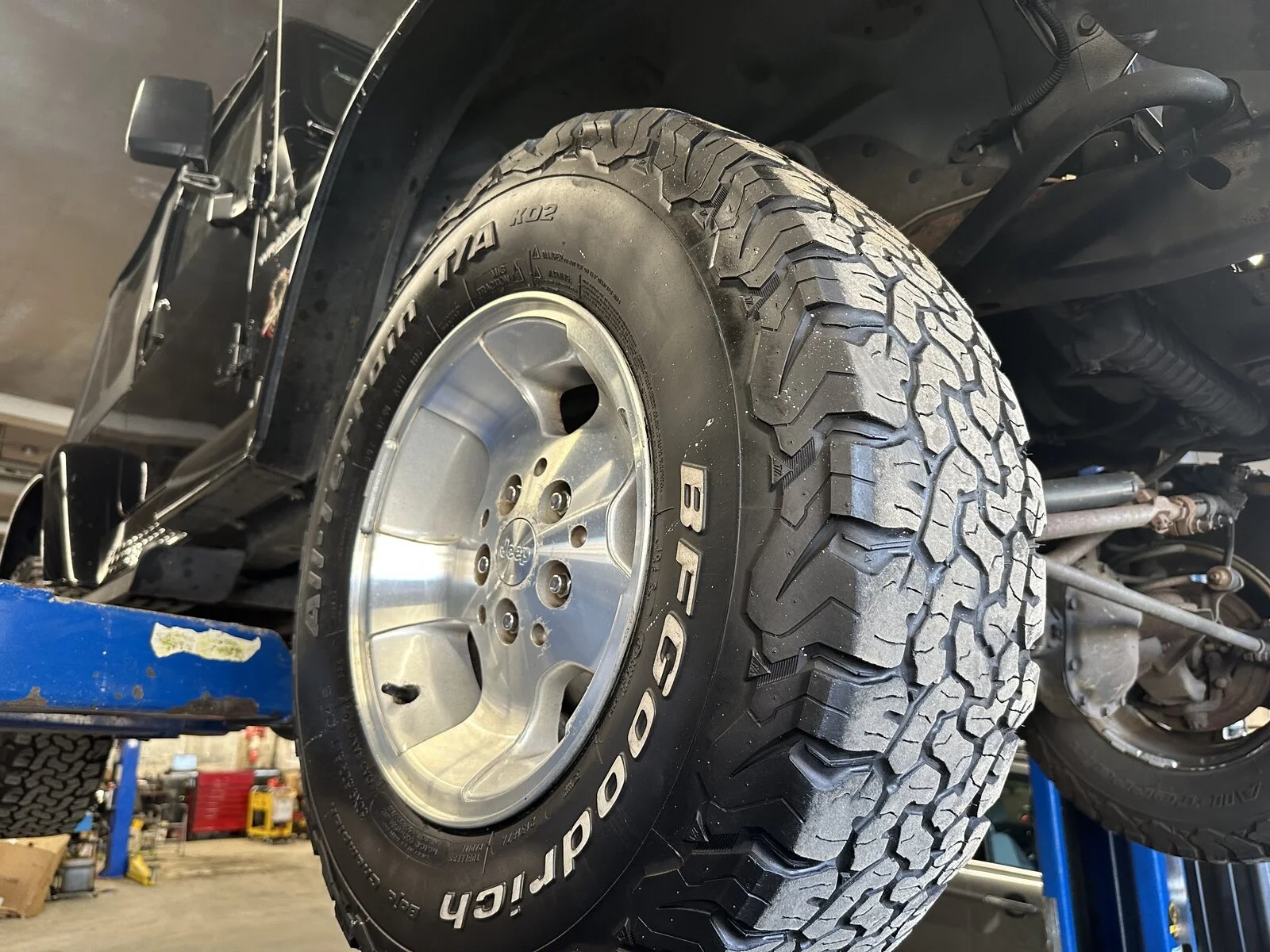

On the second picture in the top right, you can see some rust on the outside of the frame. You'll need to get more photos of that frame and especially near the rear lower control arm mounts. Feel inside the frame for debris, rust flakes or chips, etc.
Although, for a 20+ year old TJ in Minnesota, first impressions doesn't seem too bad. More photos of the frame and torque boxes (Frame to body mounts) will tell.
