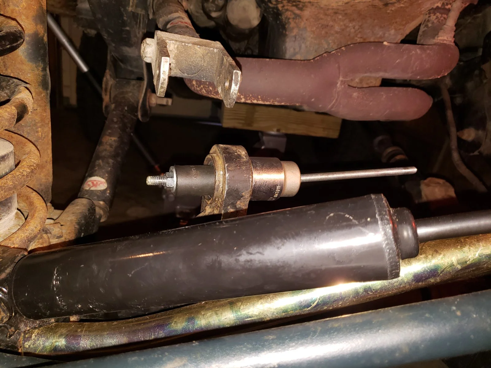

The cost of replacement internals total $50.01. I can list the parts if you want. Adding the differential side machined JJ brings the total close to $100....the other joint on top of the Diff is $50. plus getting all of the proper replacement parts is just about the same and buying the whole kit,
I like the Currie tool. Servicing the JJ while on the vehicle is convenient, and easy, no bench vise required. I could cobble together a tool that would do the job for less money no doubt.Yeah I got the diff one too and it needs a rebuild as well. IDK how I'm going to rebuild the passenger side. Would I need that special tool?
They will twist. Is there a JJ on the opposite end?Once the joints are on am I supposed to be able to move them by the arm?
