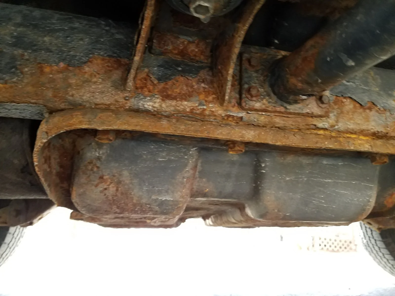

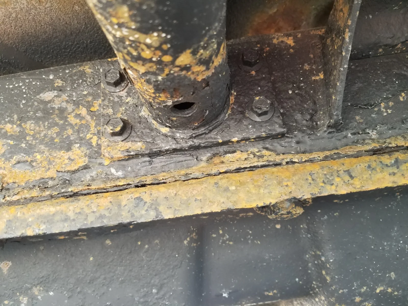

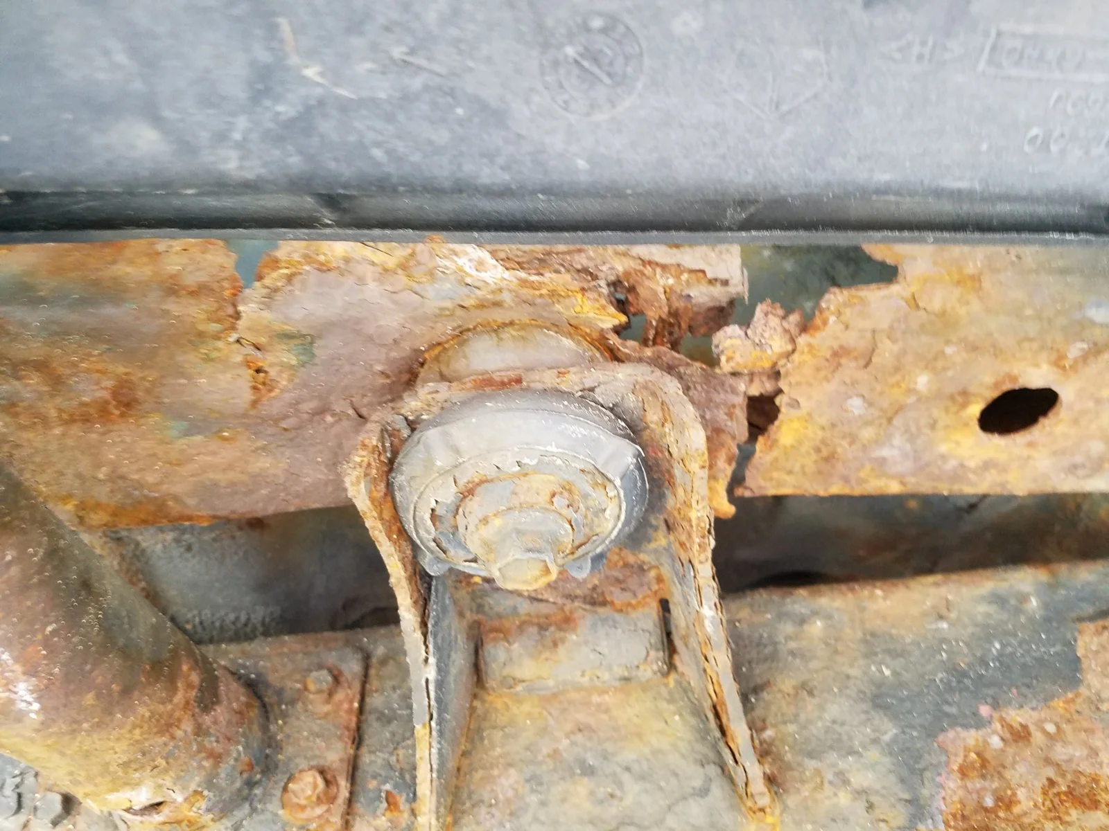

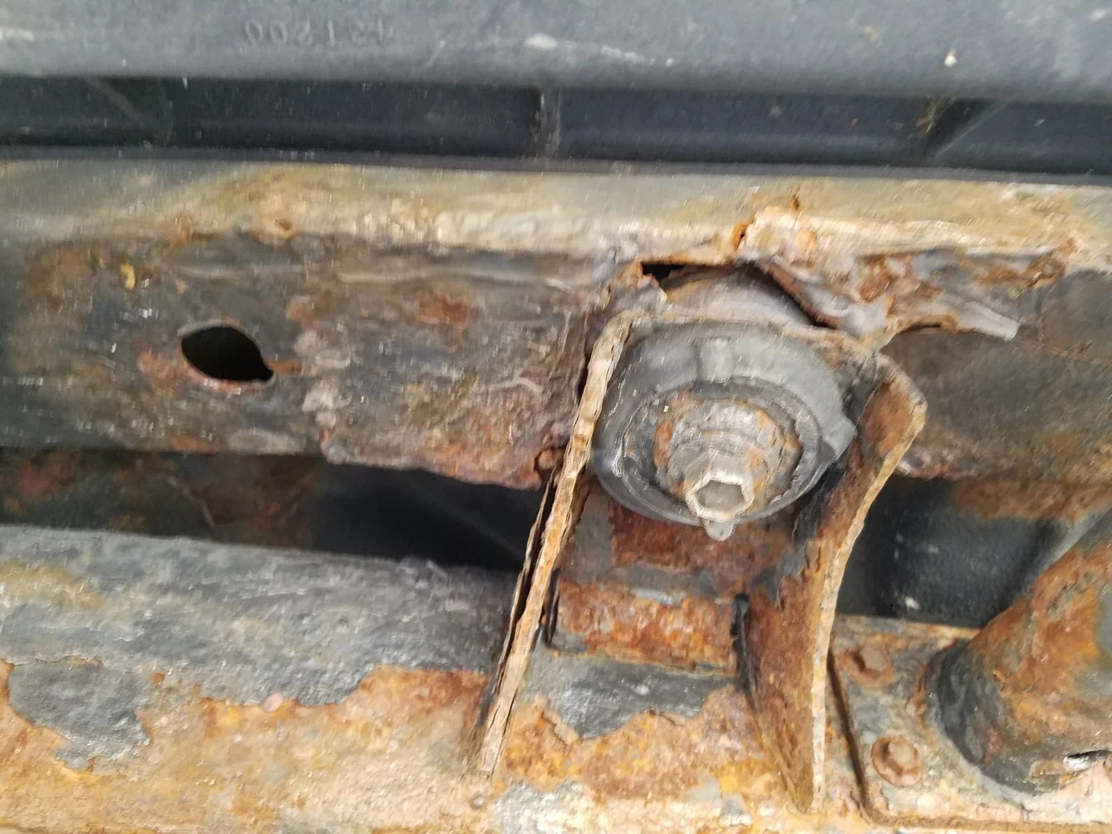

Trying to buy a TJ but in new england they all have a lot of rust. These are photos from the underside of one that has
the least rust i have found but the middle side body mounts are rusted through. Is this worth buying and trying to fix or would you steer clear?
that's a lot worse than I would want to deal with

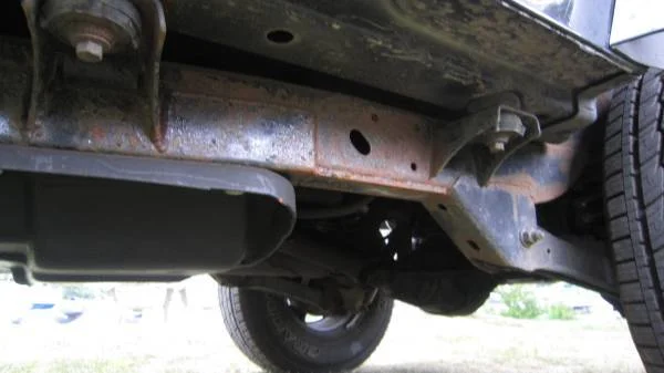

here's a pic of the TJ I bought last year for $2000...this one had been repaired already before I purchased it, and is as bad as I would go unless they're giving it away

In your picture the frame doesn't look too bad but i bet there is a lot more rust you cant see specially if you try to remove the belly pan? The other pictures clearly show the body mounts are GONE! What are you paying for it, and does it have a hardtop and full metal doors?
